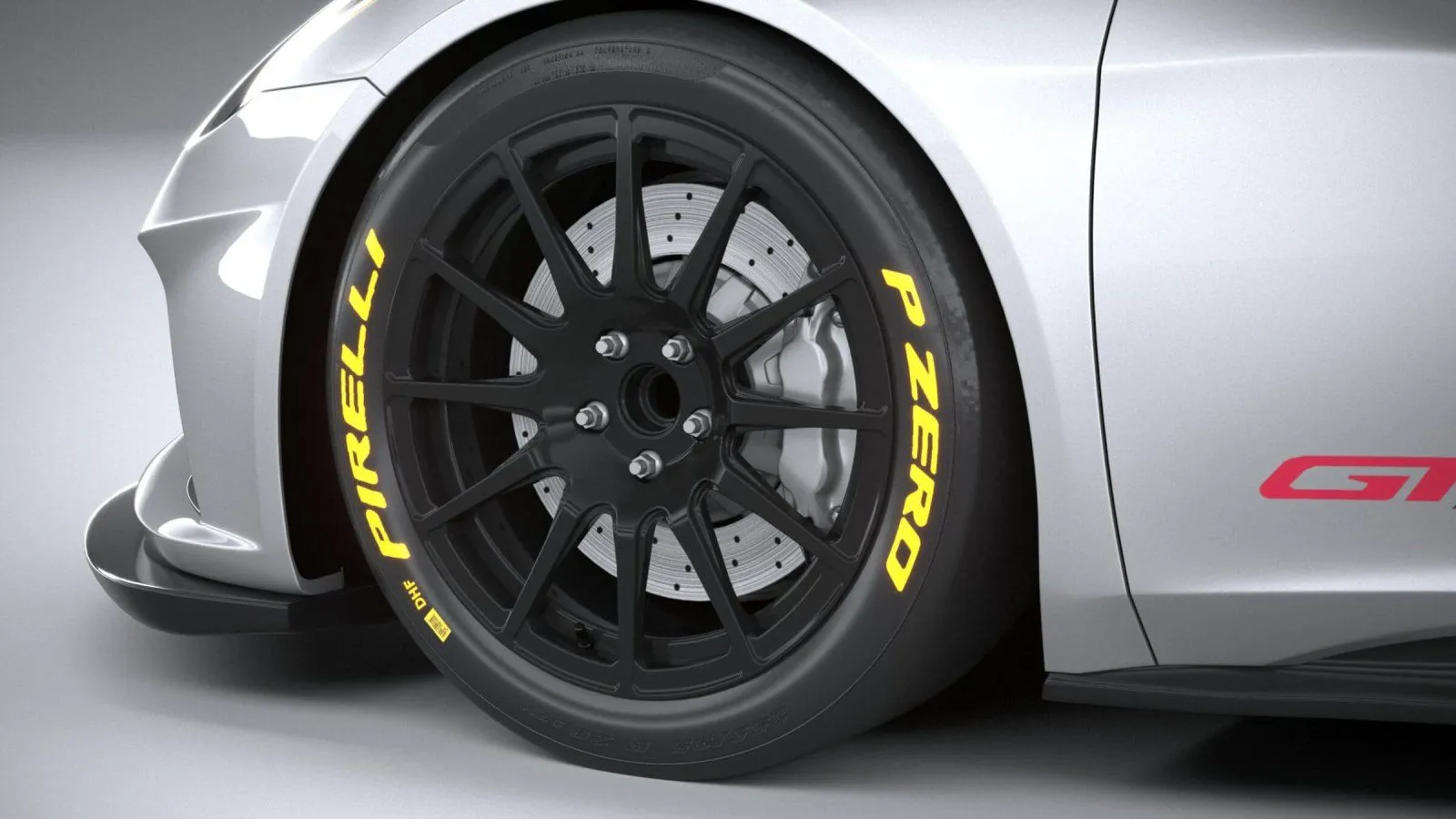

Here are some closeup pics of the GT4 for everyone's benefit.
I stand corrected. GT4 tyres are on 18s.
Tyres: Pirelli GT4 26/645x18 (front) and 305/660x18 (rear)
