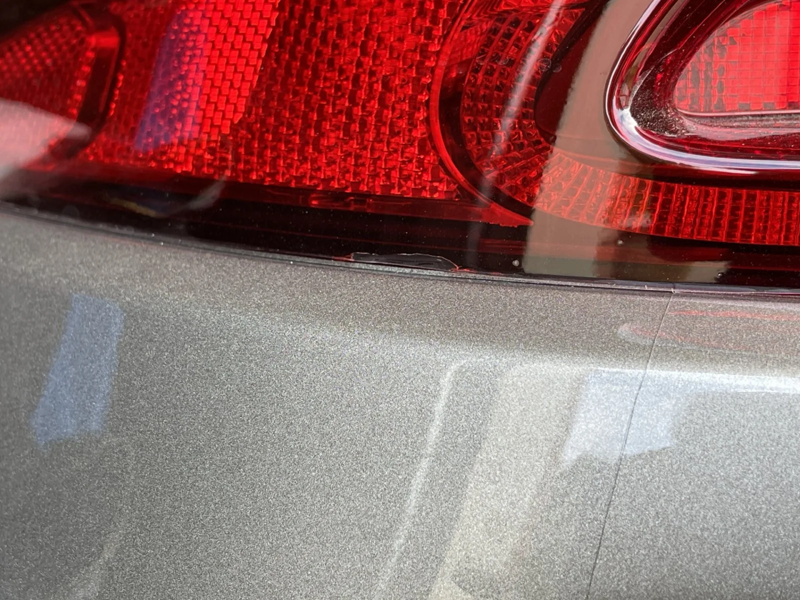

1) they appeared to have chipped the edge of the taillight while tucking in the PPF.

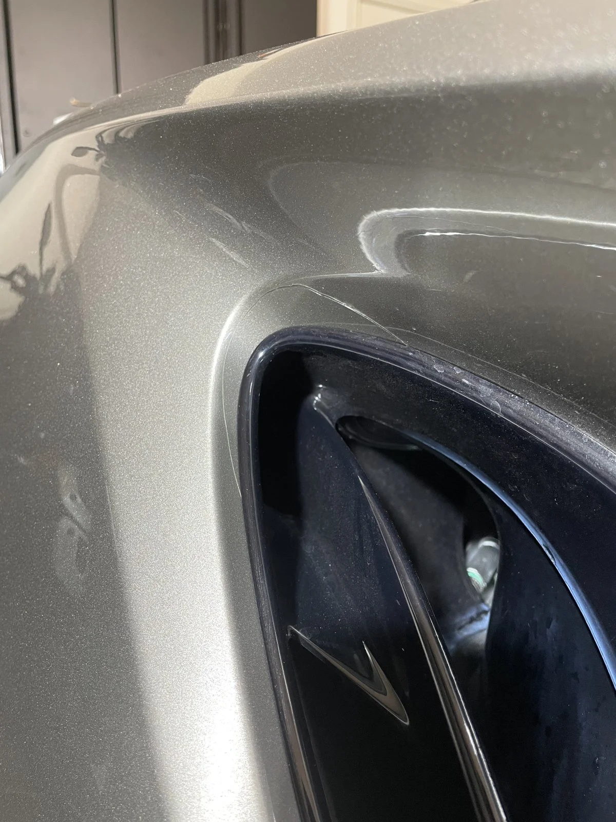

3) Some of the PPF in a curved area is coming up (I imagine the shop can fix this easily, but may need to replace the whole section).

I will send a full update next week. The PPF installer scheduled me to bring the car this Saturday for the fixes. But they are not accepting blame for the small crack on the taillight.

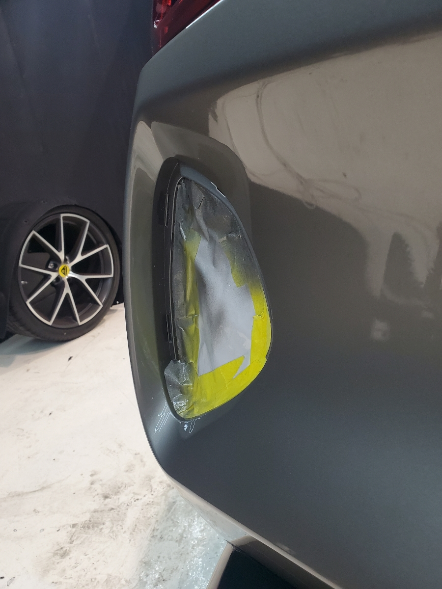

Update: Issues have been mostly resolved.
PPF shop has painted the bumper area where the paint pulled. Photos below. My conclusion is that the area under the black plastic trim doesn’t receive a lot or any clear coat, which makes it more fragile. It would be best for PPF installers to not try to tuck the PPF under there. Just end at the plastic trim without removing it.

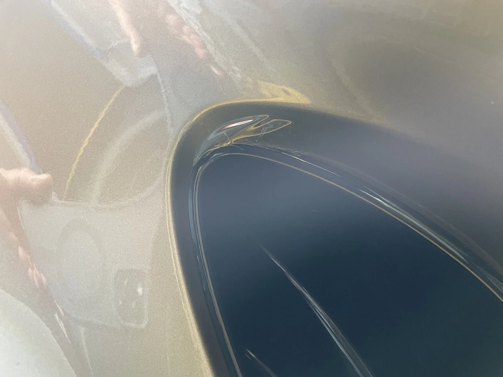

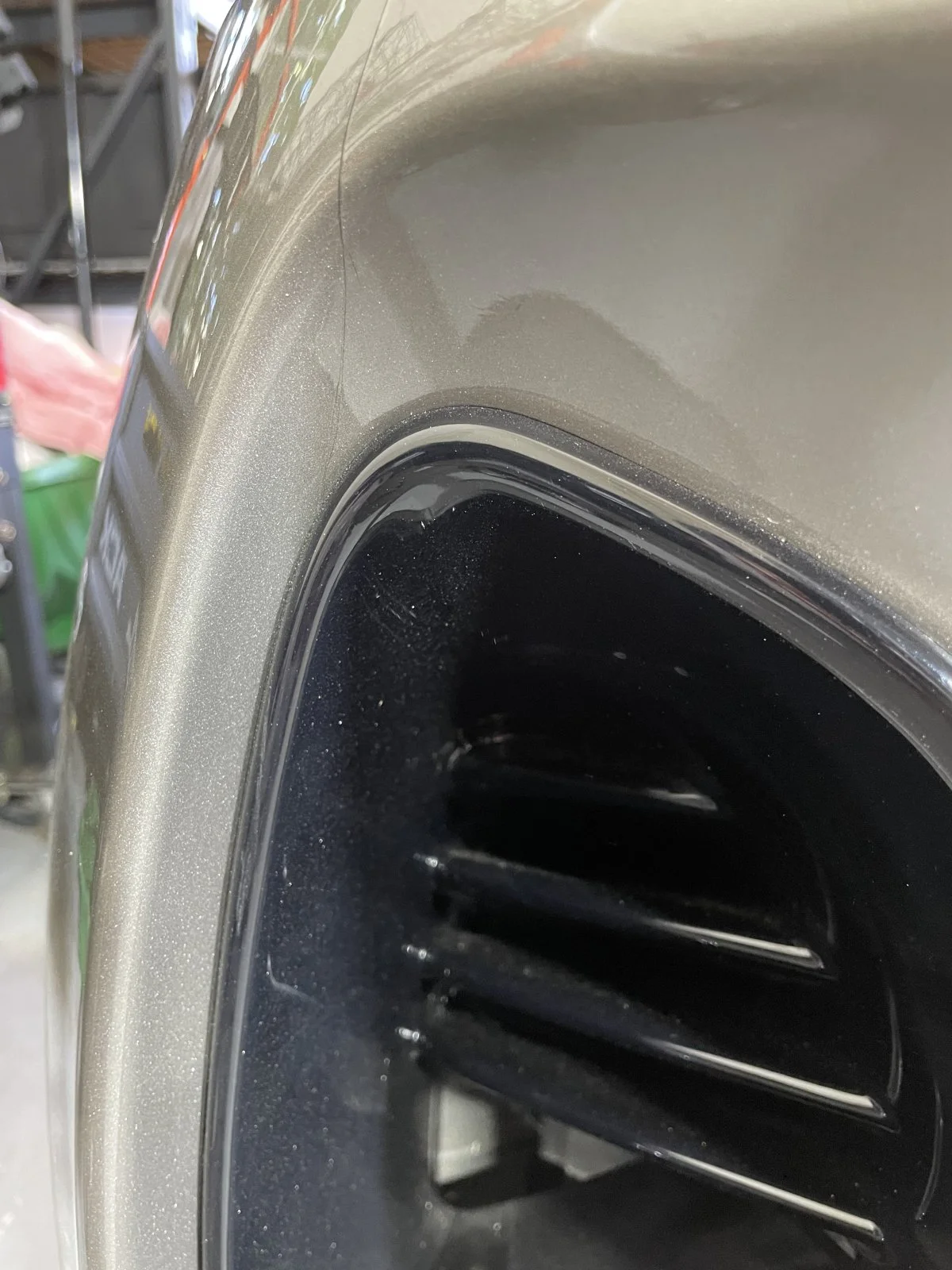

There is also a lot of curves in the Emira, so installer experience with the vehicle matters. I added a photo below of an area where the PPF was lifting and the installer ended up cutting to put a small patch.
As I mentioned in another message, the shop didn’t accept responsibility for the small taillight chip. I am going to leave as is.
