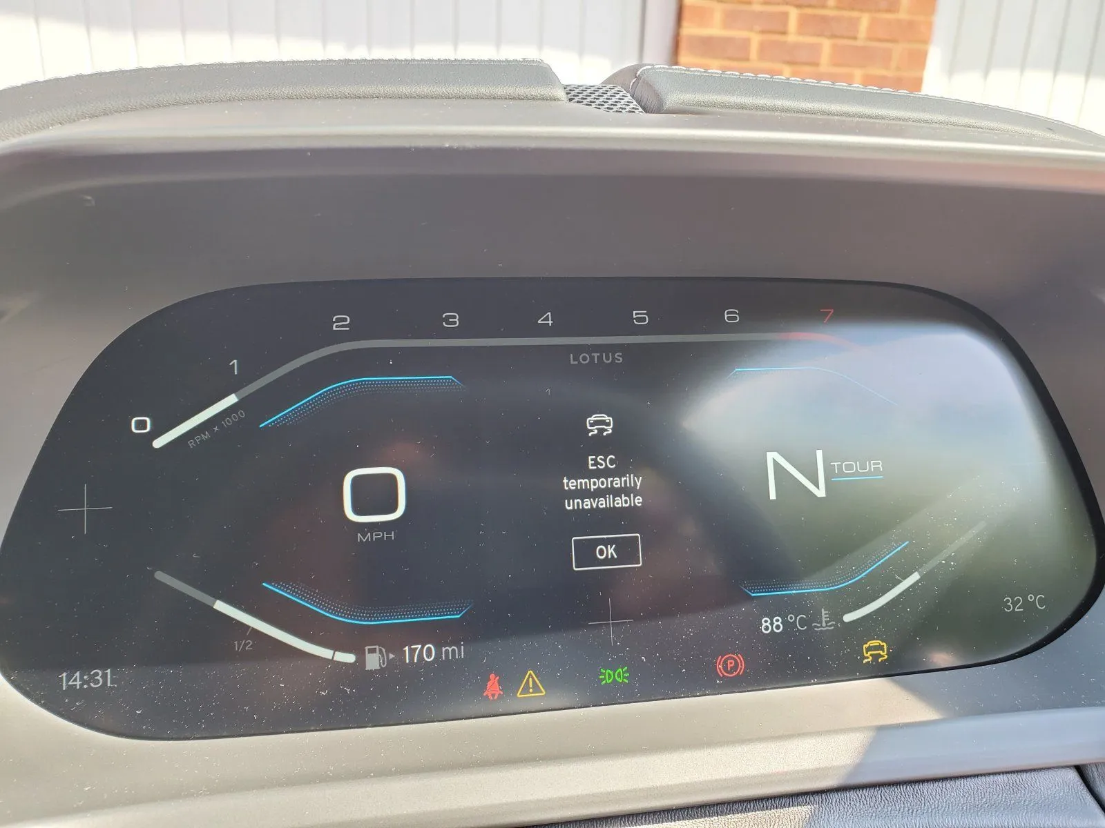

Well I am at 1100 miles and can now play with the car properly, however I have had a few dash warnings come and go with the Hand brake auto functionality and also experienced the wiper issue that everyone suffers.
Its my everyday car but I don't necessarily drive it every day, today I did about 30 trouble free miles and then was sat at a junction waiting to pull out , when I pulled out (mild acceleration) the dash lit up like a Christmas tree, all sorts of warning lights and messages came up.
1. A warning to stop immediately due to brake failure (Accepted alarm)
2. Handbrake failure (Accepted Alarm)
3. Another alarm that flashed and dropped off so did not see it
4. ESC temporarily available (Accepted Alarm)
I pulled over, stopped the car got out waited 20 - 30 seconds got back in and the dash warning lights were out apart from ESC fault which is still present.
Have contacted Lotus Silverstone but no answer to repeated calls.
I have accelerated harder than this in the car so not sure what triggered the problems, anyone else seen the same fault pattern before?
I bet it disappears before I hear back

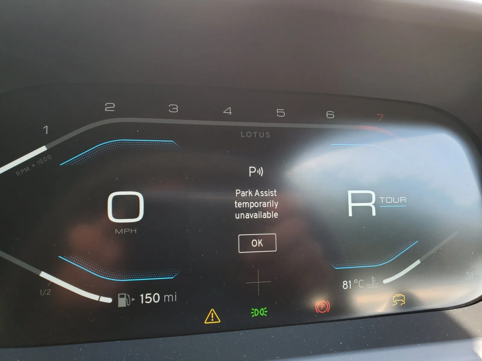

So back out to the car again just now and I had a new fault:
Park Assist was temporarily unavailable, ESC still in fault
And Handbrake would not release (Even though fault was not showing for handbrake anymore)
However when I pulled away and got to 20 mph the faults all dropped off, have driven in for another 5 miles to see if I could trigger any fault again but nothing happened.
Bizarre intermittent faults are the worst!! it robs you of confidence in the car 😒

This might sound stupid but when my car was delivered I had a full tank of fuel as expected and it threw lights from the first 20 miles of use. after the first 100miles I use my local Esso garage and topped up with 99 and have not had any lights since - thoughts?
i was advised to run it on super.
I have a Shell station 1m mile away
Doesn’t make any difference, I would say. I put normal unleaded in and I don’t have any warning lights. But what I do know is the battery drains pretty quickly and sometimes when I start the car it sometimes splutters into life rather than a positive thrum. The battery system is the main culprit.
I had something similar happen to me today and actually “bricked” my car from starting.
Try disconnecting the battery for 5 minutes and reconnecting to see if the warnings will go away.
It’s software issues, mostly clears itself after the ECU did a reboot. Book an appointment for software updates, there was something released recently. Hope it takes care of it. I’m 10k kilometers in and had all kind of issues. Buckle in, it’s a wild ride.
