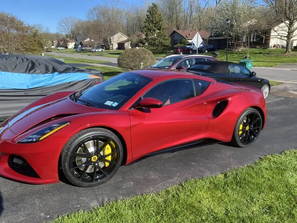

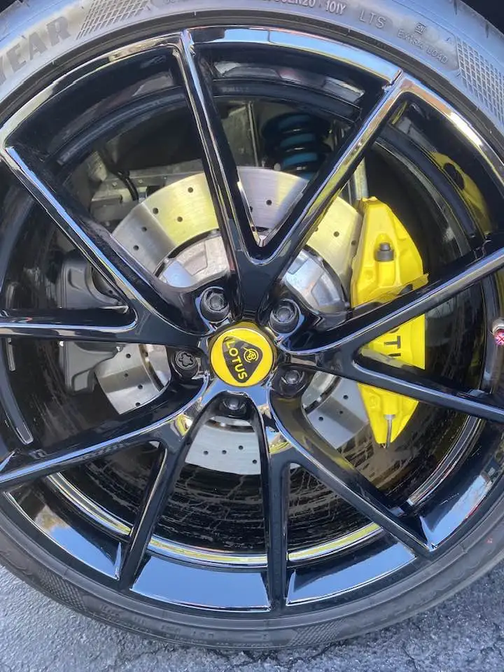

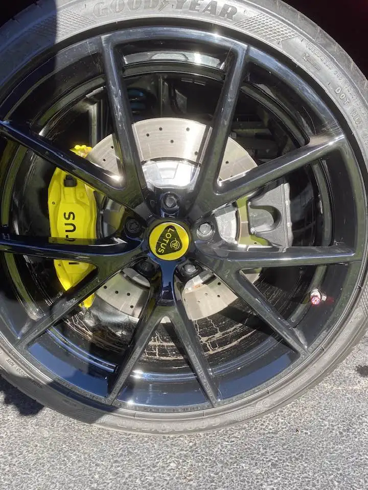

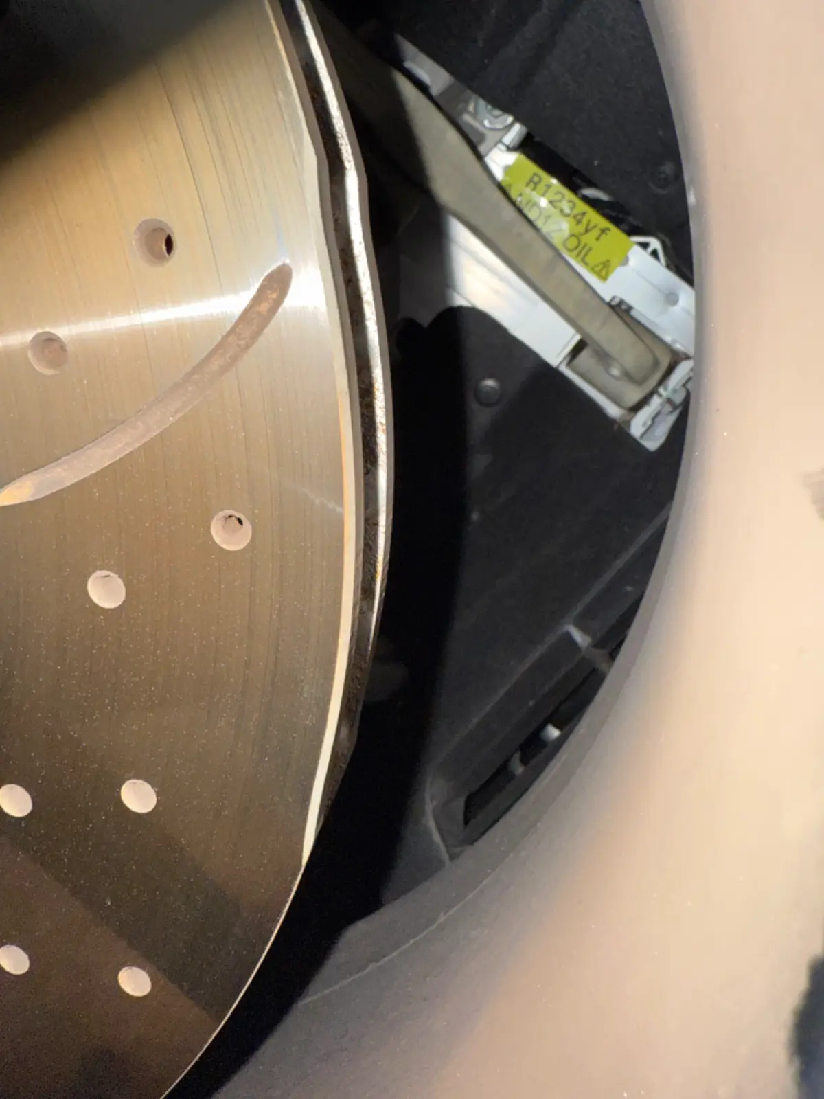

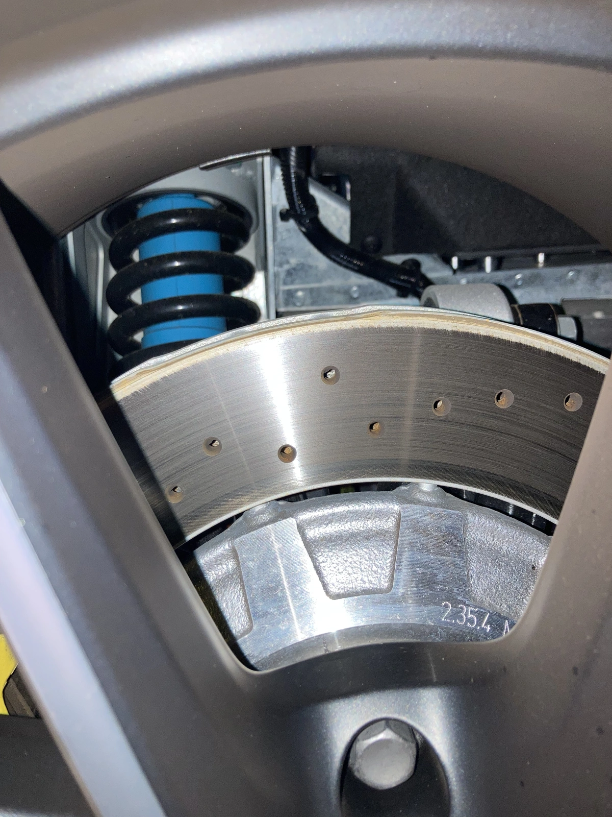

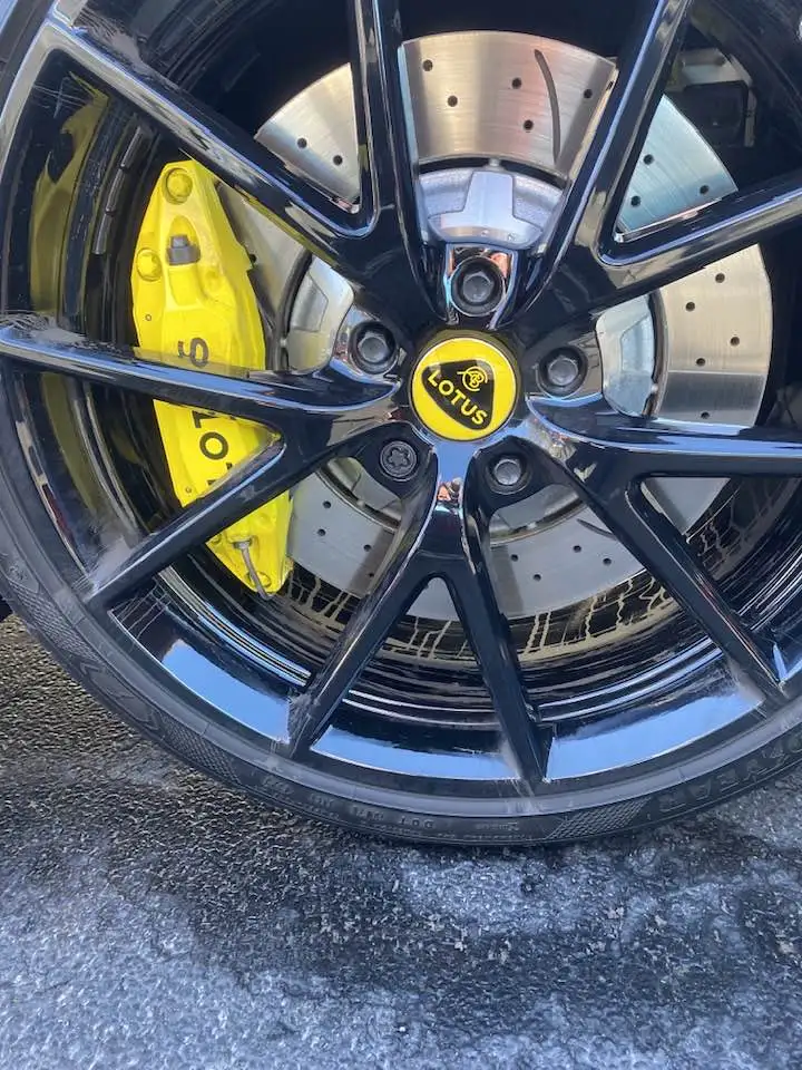

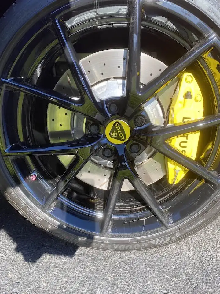

Did the break in on the brakes and no issues with discs scarring , the pads seated up and look great. About 470 miles on them.

What method did you use?
I checked the discs when I picked up the car, and they all look good, no scarring.
break in is nothing fancy, just gradually stopping about dozen times, get out and check discs for marks.
full bedding is about 400 miles and NO hard breaking until after break in and bedding.
I am at 470 miles on my Emira when photo was taken.

No problems here, just massive brown brake dusting.....
