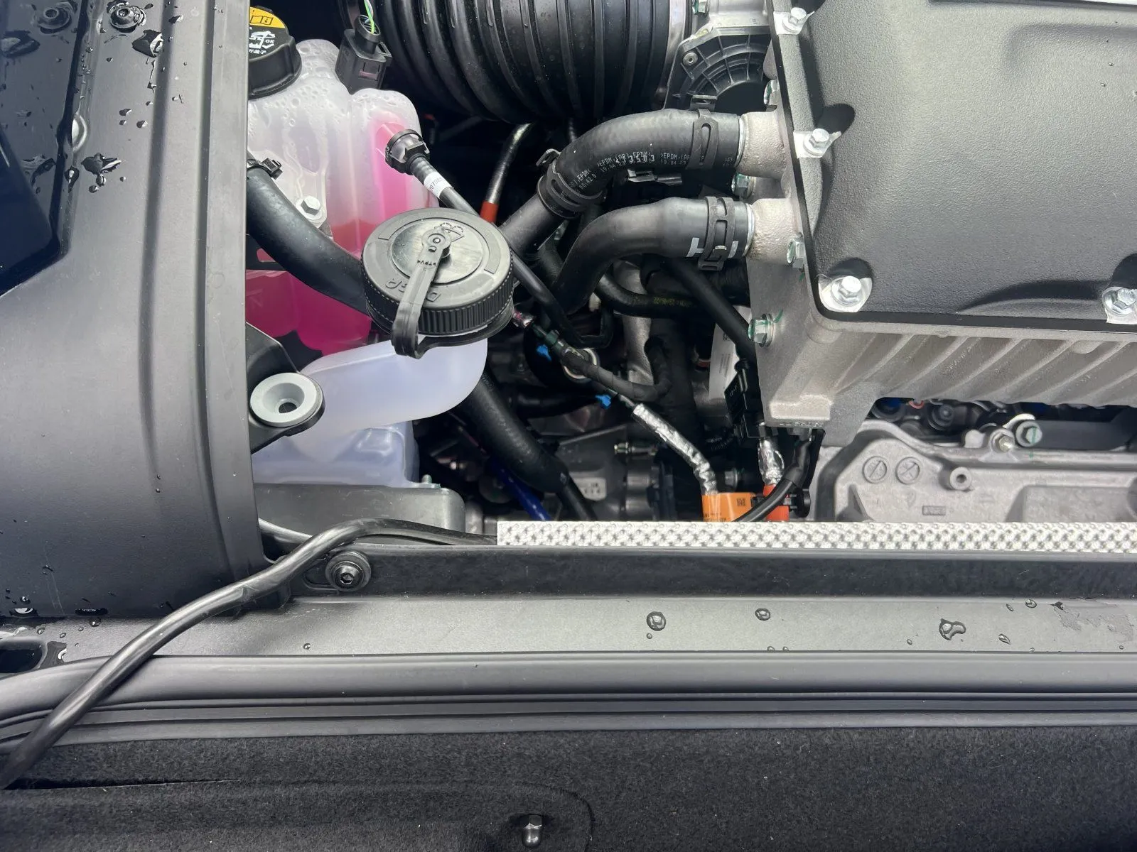

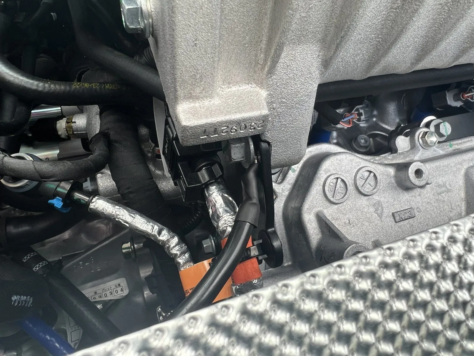

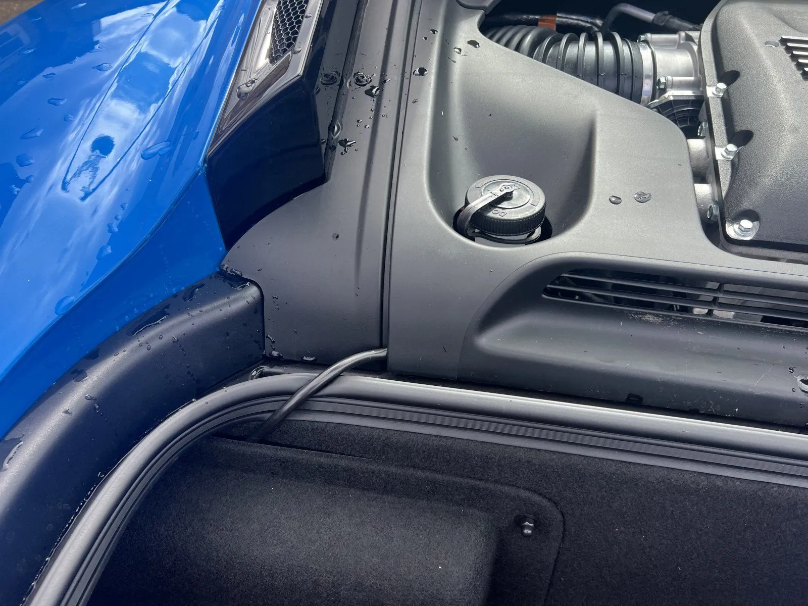

I had the car for a week and drove it 20 miles on Tuesday before getting to a stop off. When I went to restart the car it was totally dead. No electronics, nothing. Couldn’t even lock it or even open the boot initially as that also requires power (though there is an emergency release loop in a panel behind the passenger seat. Got the AA out and they realised it came to life when they earthed the battery. He couldn’t see where the other end of the earth cable was going so I said I was happy for him to rig another earth cable into the engine bay so I could get on my way. Having now been to a dealer it seems the other end of the earth cable connects to the chassis somewhere near the front left wheel but requires to go on ramps etc so booked in for August. Guessing it wasn’t tightened properly in the factory and rattled off as I was driving.
Lotus dealer hadn’t heard of this happening before but thought I’d share it so people would know what could be the problem if they run into similar issues.
Besides this I’m still loving the car and just taking this as part of the Lotus experience 😅
Glad you were able to get going again. Can you provide details on how you rigged the temporary earth cable? Assuming one end went to the battery terminal, where was the other end connected to?
