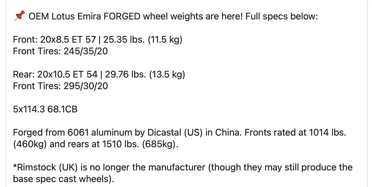

Anyone know the specs for the Cast Wheels? Specifically, I'd like to know weights and mfr.
I could only find the specs for the forged wheels.
