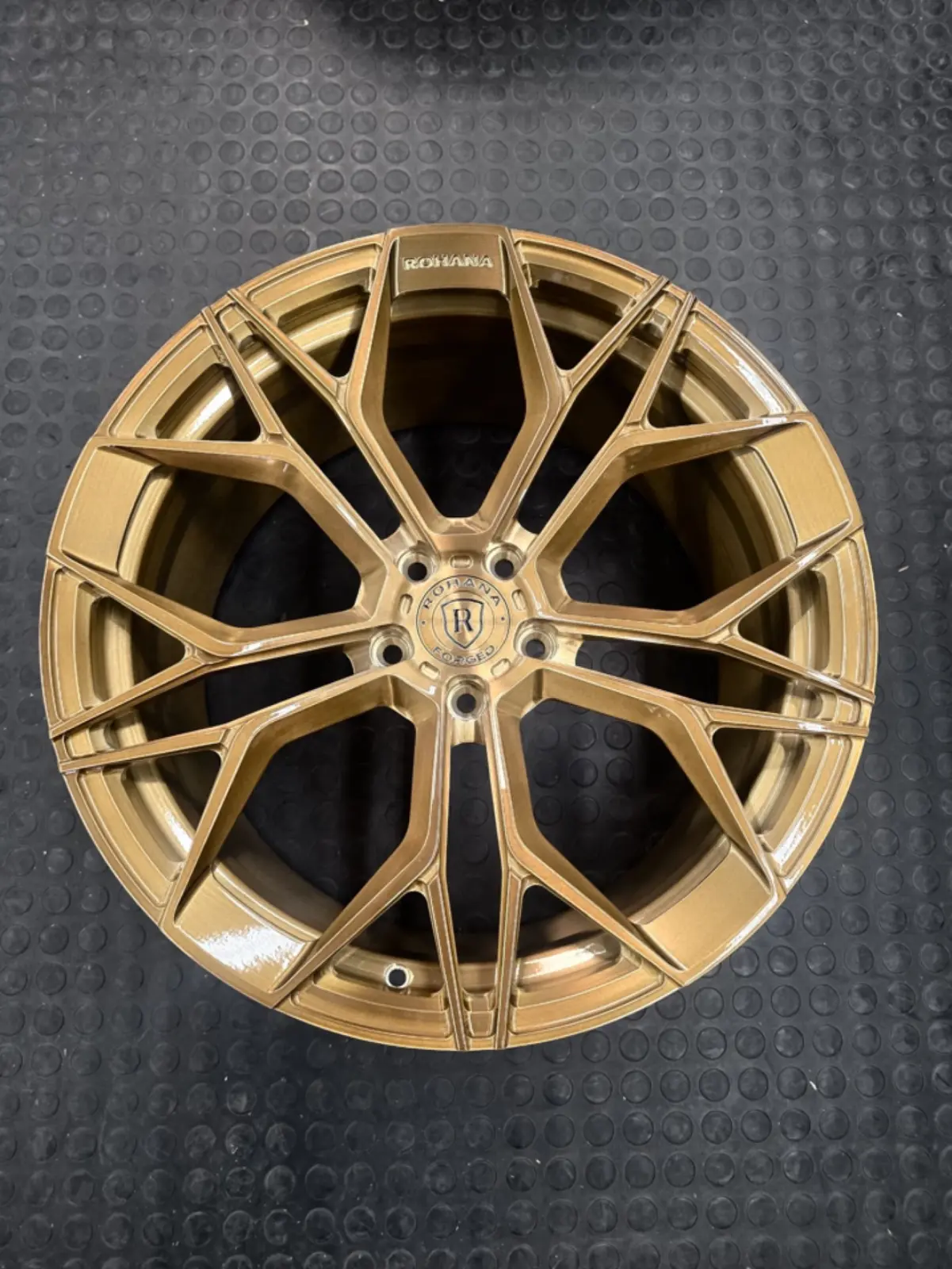

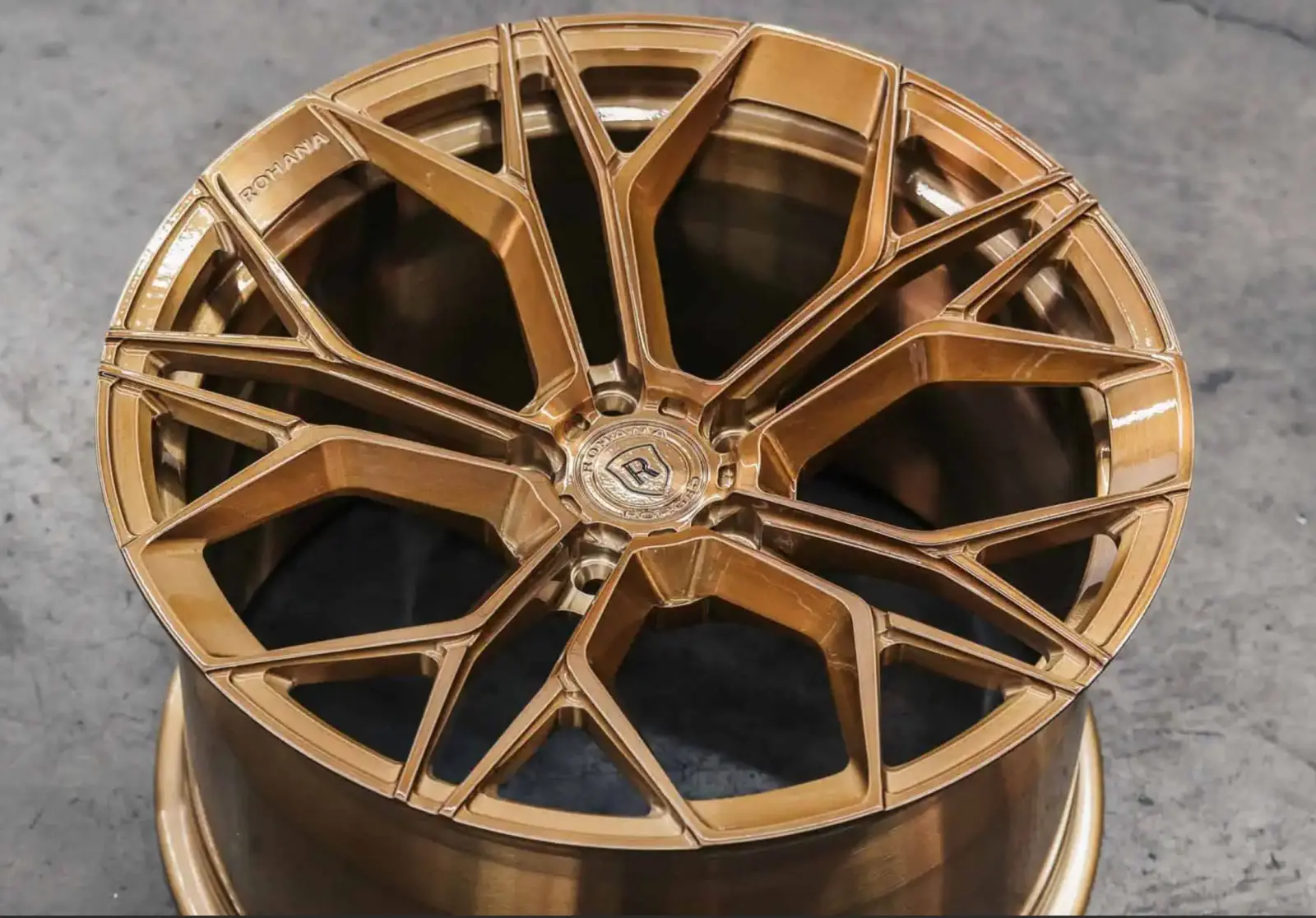

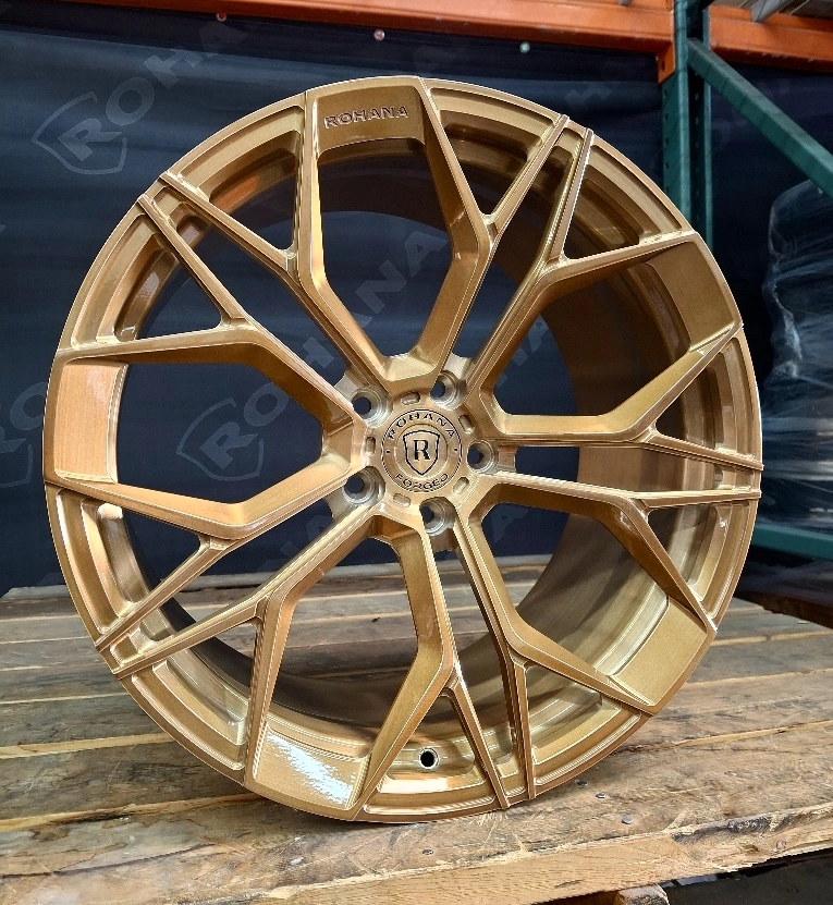

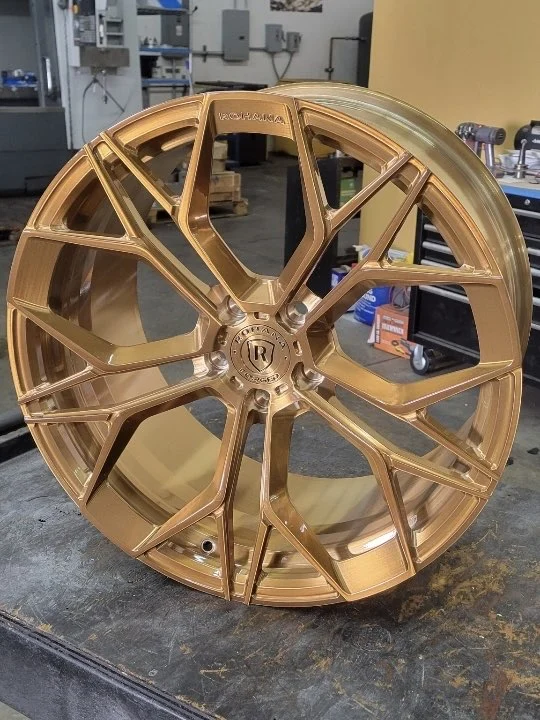

Hi, I'm getting custom wheels made for my Emira by Rohana wheels. They are asking If I want to make them flush with the fender or keep them the same as stock.?
I mentioned to them before that I wanted the exact same specs as the stock wheels so it would not affect the driving experience in any shape or form but supposably making them flush with the fenders would not be an issue. my questions are:
1) Is it worth modifying the specs from the stock wheels? will it look THAT Much better flushed with the fender?
2) will it change how the car drives and handles?
3) will it rub on the fender, either when driving over potholes, speed bumps or just turning the wheels at sharp angles while parking?
I'm attaching a pic of the wheels I'm getting for reference.
thanks a lot!
