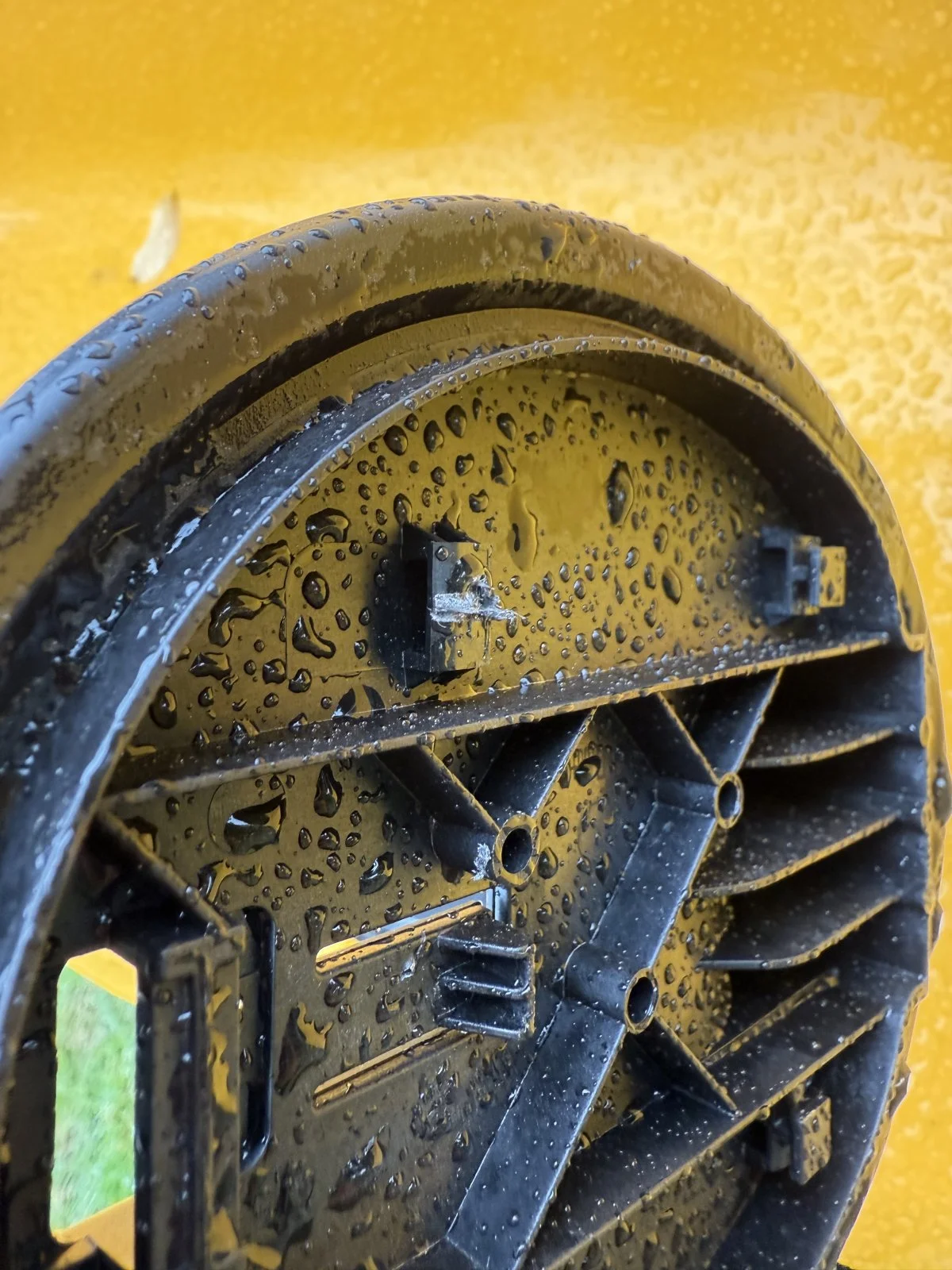

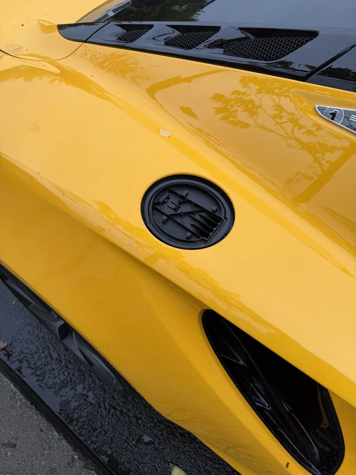

No way this just came off by accident

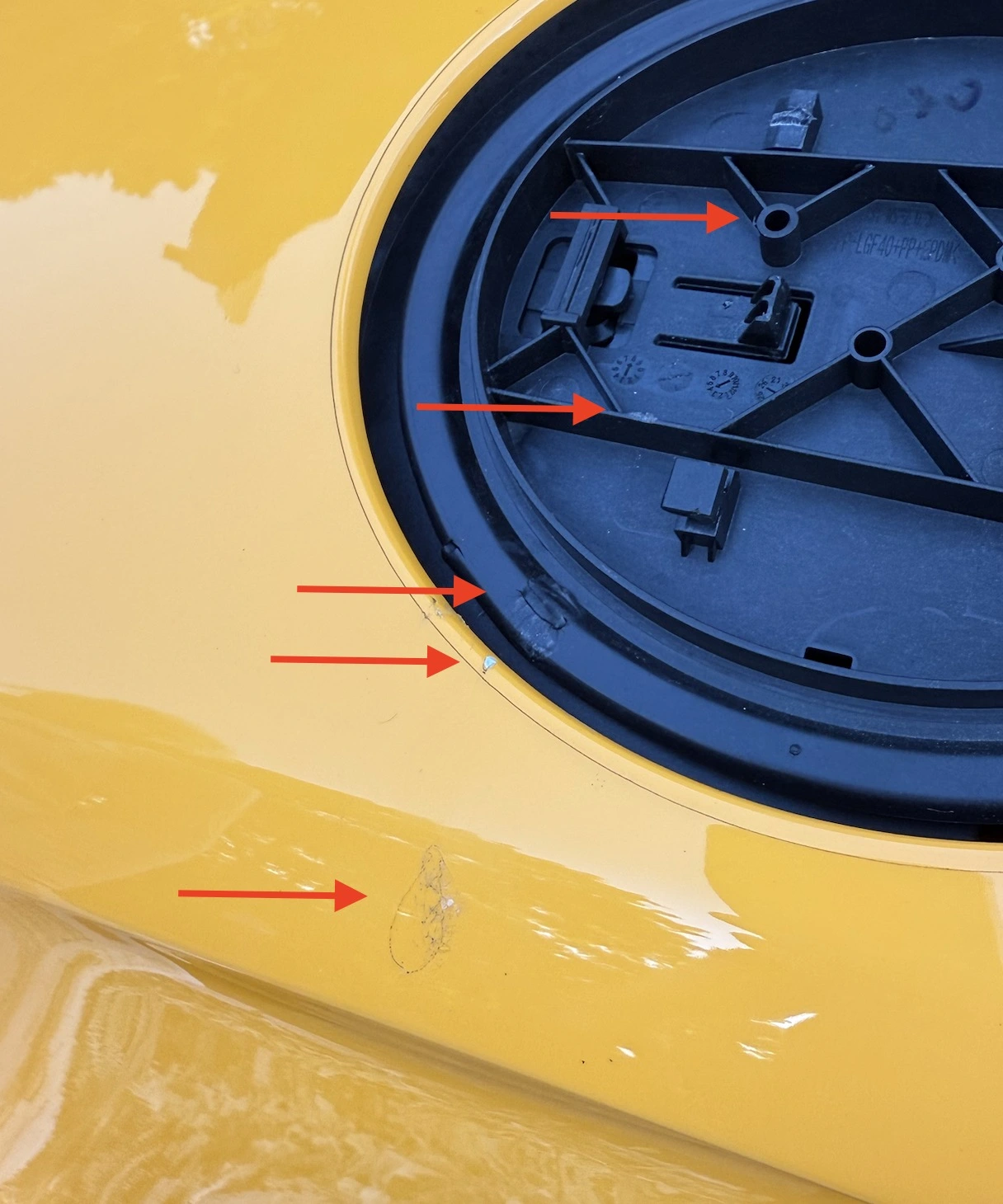

There doesn't look like there's any damage to the surrounding body so maybe not levered off.
Definitely a tab thing is broken though.
How annoying.
When the car is locked, the gas cap is locked. I'm guessing someone tried to pop it open as to vandalize your car, saw it was locked shut, so decided to just pry it off completely. If you are really in NYC, that's an area I see a lot of vandalism on the Civic Type R groups that I come from as well. The good news is it should be relatively straight forward to replace without having any record of it on the CarFax
  • #4
Yeah I’m in NYC. Surprised as I was parked in SoHo
