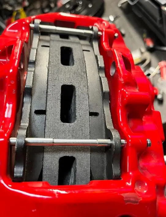

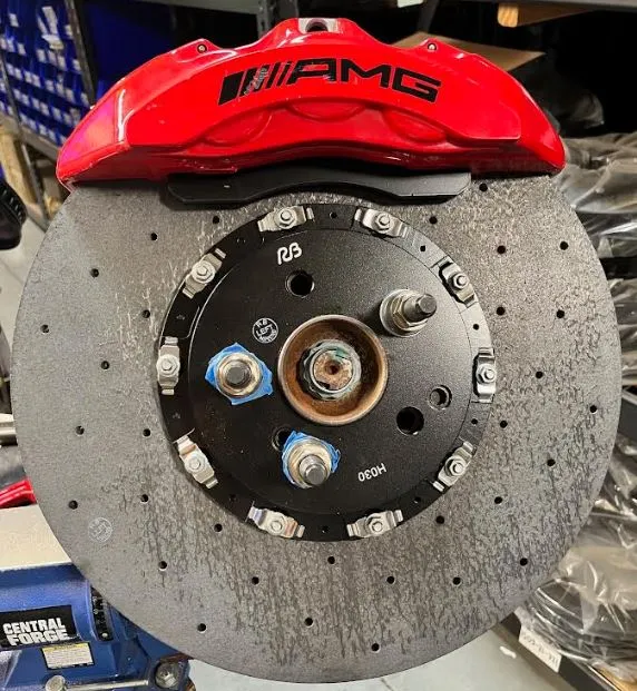

Here are some pics on a ccb conversion upgrade (from stock iron retaining stock 6 pot calipers) for a Mercedes GLC.
Order being shipped tomorrow.
Stock caliper with stock size pad (Rotor 394x36mm) -fits 19" wheel

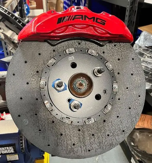

Stock caliper with a larger pad (for ccb rotors)

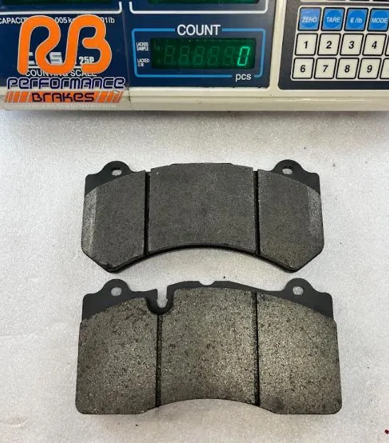

Pad size difference:
