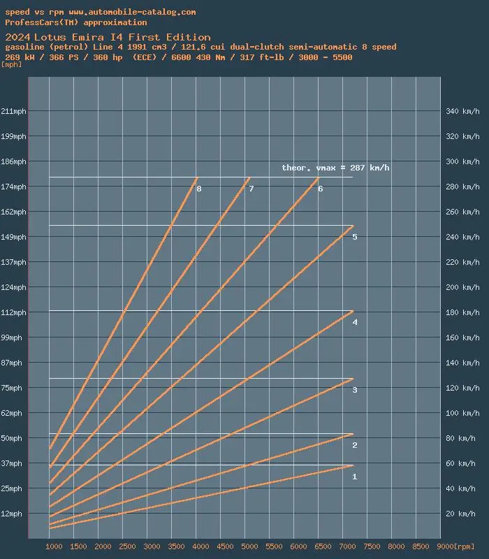

If the above numbers are correct, then 5th gear might be the one closest to 1:1 for dyno test?[[According to available information, the Lotus Emira I4 has a final drive ratio of 3.79. ]]

thanks for the info, looks like 5th gear is the one to run dyno.A good source of info can be obtained from

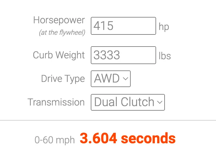

We should take bets on power output. With Car&Driver clocking a 3.4s to 60mph run I'm thinking 415 HP
Some of the Dyno facilities also have scales, would be nice to know the actual weight as well.
[0-60 calculator ] this is my swag - Curb weight with feather weight driver
Subtract 0.2 sec for rollout => 3.4s to 60 mph
