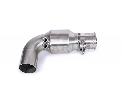

2) JUBU has a solution with this JUBU HD Sports Catalytic Converter. However, I don't know if it alone can pass a U.S. Emissions test.
3) @mikemc mentioned a solution with something like this that can be welded on near where the 3rd cat was.
4) Pay your local tune shop every year for a switch out and switch back in... stupid expensive.

I think the best solution would be to remove the 3 factory cats, relocate your sensors to the 3rd cat location and make a flange attached cat at the 3rd cat location that you can swap in and out as needed. In the 3rd cat location you only have to remove the diffuser and if its a flanged connection then you wont have to move anything around just pull off the cat and swap in a straight section.
Need this. I'm assuming it requires a "tip."
