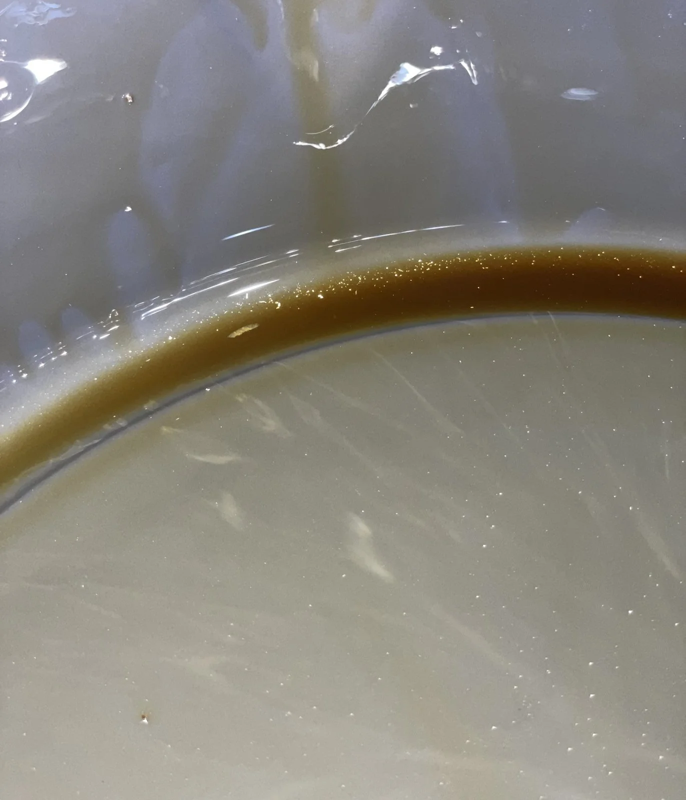

No the first oil filter does NOT catch all the particulate, and most certainly not in 10,000 miles. I did the first oil change myself, and bought a brand new black oil drain pan to do it. Here's what the oil looked like after I drained it; all those tiny flecks you can see aren't gold.
This is the oil I drained before removing the oil filter, so the oil filter had not caught them. Those flecks of metal are not going to be circulating around in the engine of my $100k sports car now. In addition to the engine, I also had the oil drained and replaced in the transaxle for the same reason. I had the dealer do it when I had my car in for 2 software updates and that rubber water shield for the front, so I don't have a picture of the oil, but I don't have to see it to know what comes out of a brand new assembly that's wearing in.
