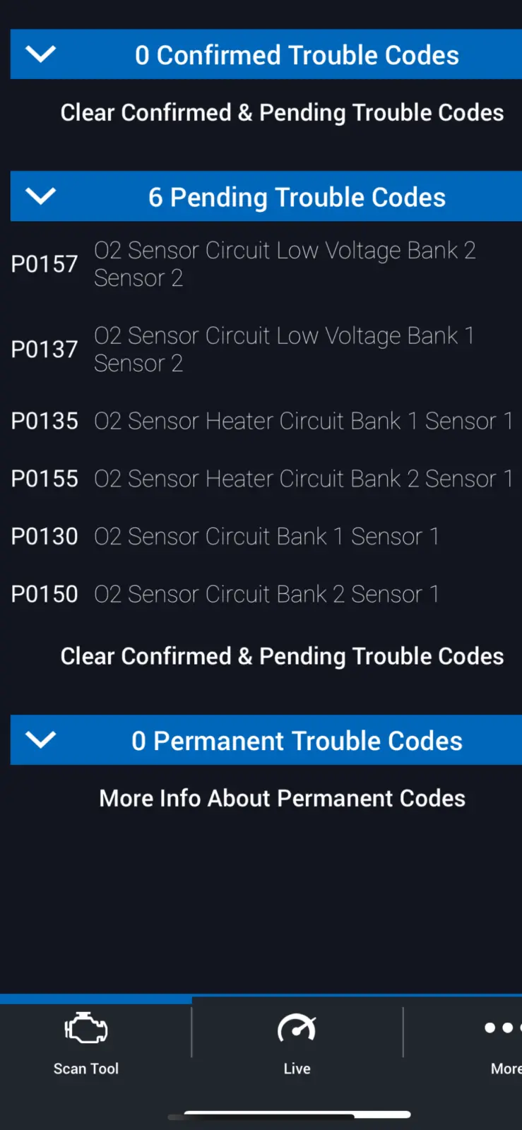

Hi all!
First, i’m new here as a writer, but as a reader i’ve been there for a while. Very nice community and i’m happy to be part of it now.
So here’s my problem. I bought from Greg (grp) full exhaust so headers, y pipe, test pipe and exhaust with miltek controller. First, the quality of the stuff is unbeleivable and let’s talk about the support i had with Greg answering all my questions all the time. That guy is a master, a gentleman and his service is perfect (thanks again Greg)
Back to my problem i have still from day one of the install is a check engine. I have the codes (check photo). The setup is pretty simple, the o2 sensor from the headers is direct in and the y pipe got spacers for the o2 sensors. The car is running well, no problem or limp mode. The sound is just crazy 🤪. But i don’t like the light in my dash. Do you guys have a solution? I have 6 codes.
P0157
P0137
P0135
P0155
P0130
P0150
Thanks again all
Welcome to the forum! Sounds like a nice set up. Did you mean to post a pic? I don't see one and wondering which codes you have exactly... 🤔

Hi!
Heres the codes

I did not do the headers, but otherwise had your setup.
My car threw a CEL about a week after getting everything installed.
I took the car to my Lotus dealer and they scanned the car for codes. They claim the codes go to Lotus automatically???
My dealer/Lotus said the modification ruined the CAT’s.
In order to have the replacement parts and labor covered under warranty, I had to have the OEM parts reinstalled (mid pipe, 3rd Cat, and exhaust).
Hope your outcome is better than mine.
