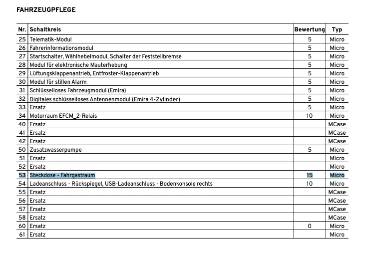

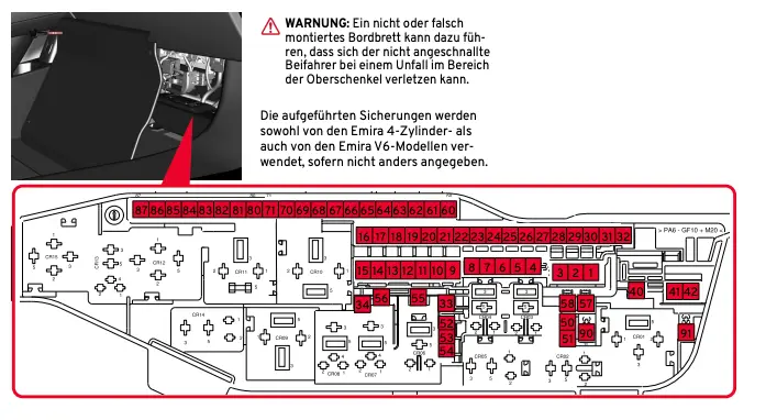

Handbook Page 250 onward:
Passenger footrest fuse box, number 53

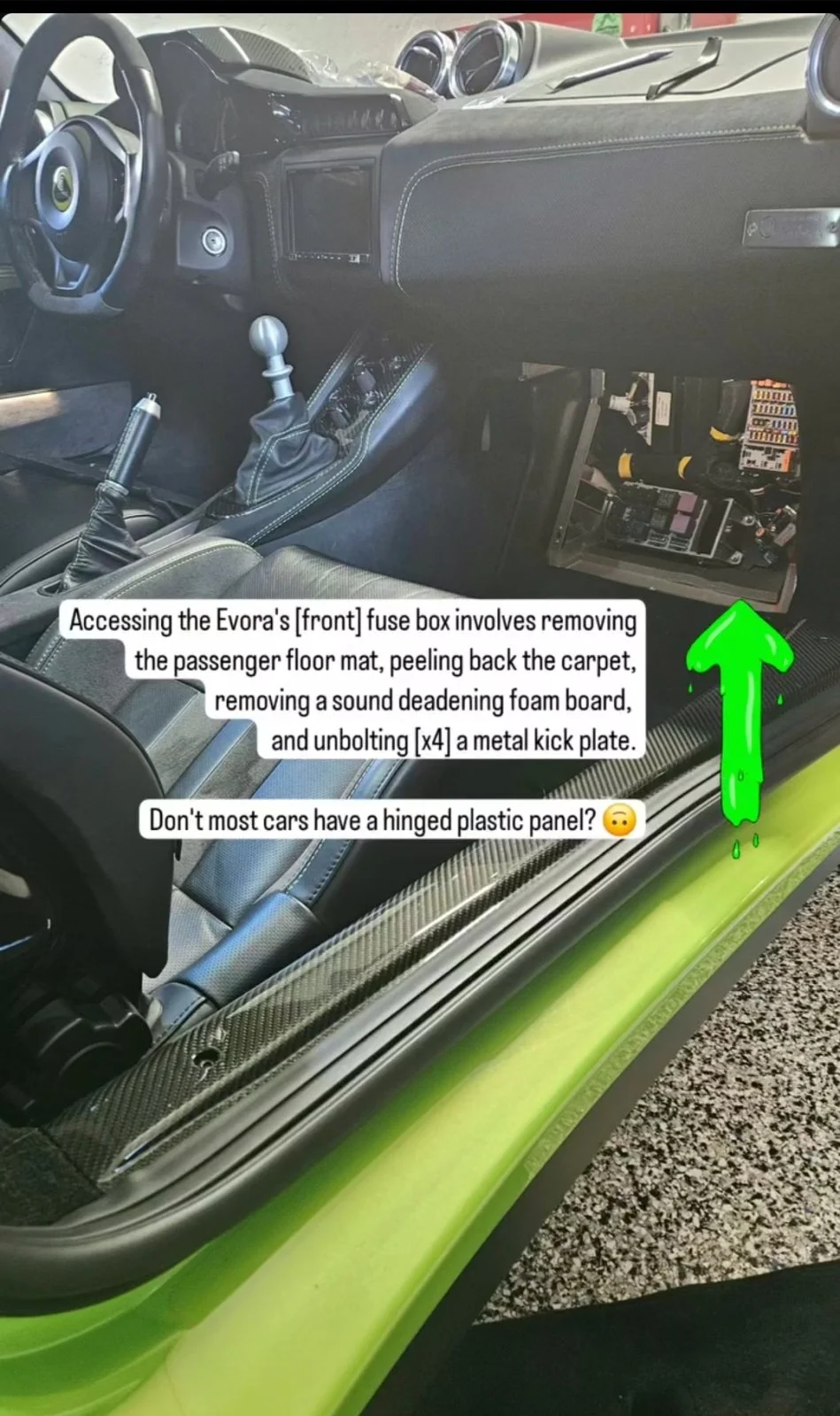

If it's the same as the Evora, the fuse box for that one is located behind the passenger side kick panel. Remove the mat and pull the carpet back a little to expose 4 turn keys that'll allow you to remove the kick panel. The fuse box is back there.
