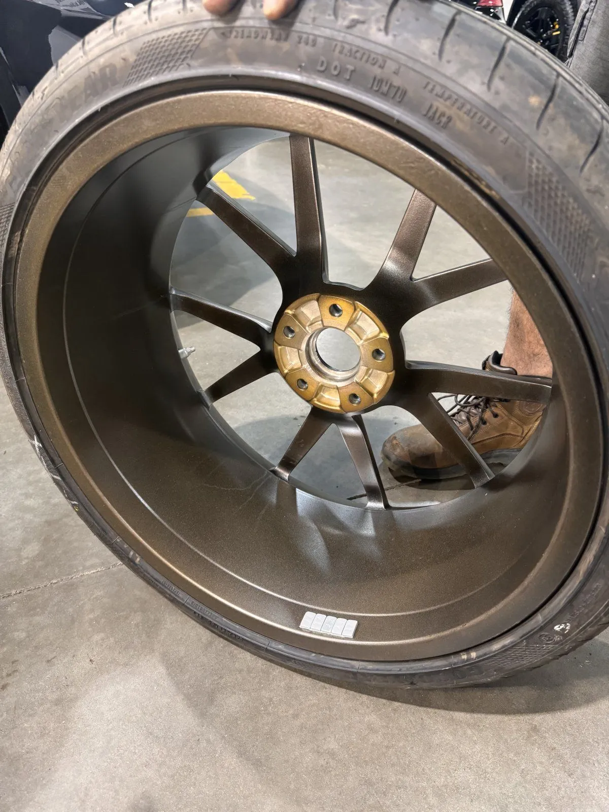

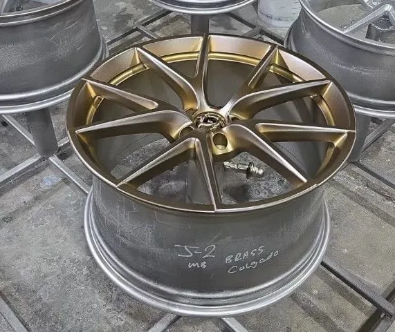

So I actually went the opposite route . I had black wheels but on shadow gray car with black calipers it just looked too bland ( I did not get to spec the car). So I had the dealer powder coat them in gold/ bronze. The first time they did it, the powered coating guy did not remove the original black paint and just sprayed over it and it looked terrible. Wayyy too dark and I could see a bunch of imperfections. Now that that have actually stripped all the paint off the wheels you can see that it’s much better and closer to the lighter good bronze versus dark brown. This is only the first coat so it will look a little different and I’ll post photos once I actually get the car but yes the key is to have them strip the original paint completely
They must have painted over the old finish PC would not have bonded
@luciddaydream if you get your wheels redone, also make sure that the five 60 degree tapered cone seats (bolt holes) don’t get powder coated. Under high clamping loads, and from the friction stress of tightening and loosening, powder coating in the cone seats could crack and delaminate over time, causing lug bolt(s) to loosen on their own. Just something to ensure the shop does properly.
