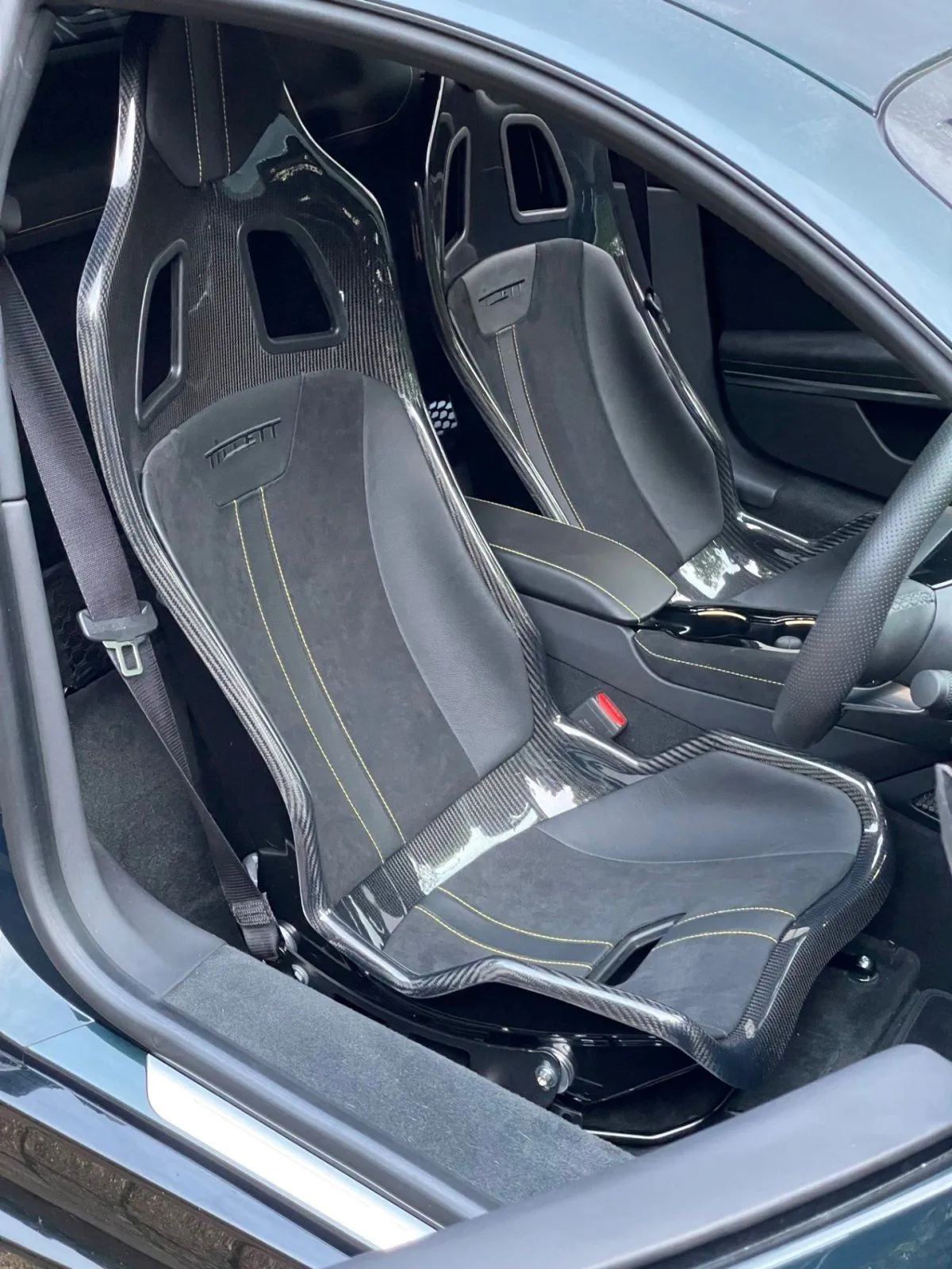

Each Emira seat is 26 kg.

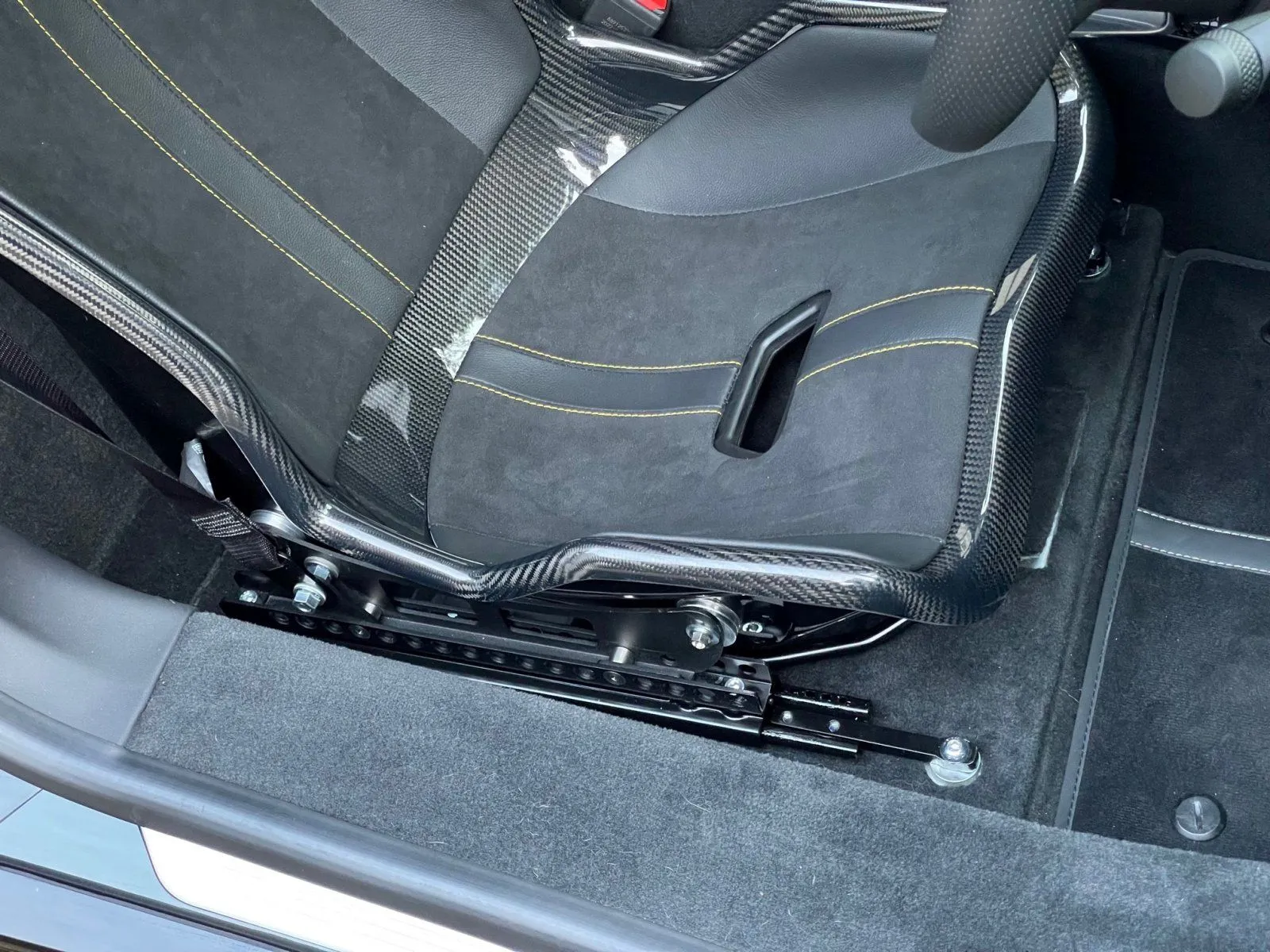

I just put a pair of my B10’s in with our runners and modified Elise brackets and all up with brackets, runners, custom panel set and the stock belt receptor they are 11 kg.
30 kg saved and way better support with no bad back after an hour.

wish yours were a factory option
I saw your other picture on SELOC @Steve Tillett and they look great. What’s the rough cost for a pair with the necessary runners and hardware?
I have not got the final bracket price in yet as I am trying to simplify the bracket. This is fitted using modified EBS brackets on our PTRi runners but the B10 XL with the carbon/special panels matching your other trim and the bracket/runner set, a set will be in the region of £3,000 + VAT.

Academic question: are the floor mounting points in the Emira the same as the Evora? Or is it something new?
Thanks Steve, this sounds great!
There is a difference in the early Evora's with Recaro seats (335 mm I think) to the later ones with Sparco seats 345 mm but they are both different to the Emira (420 MM) although the width between the holes is the same.
The later Evora's use the same runners as the later post 2017 Elise and Exige's.
