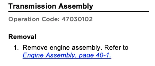

looks like it, step 1 in the service manual is to remove the engine
I thought a UK dealer found a method to replace the clutch without engine pull in an Evora, but never got this confirmed?
But yes, based on the service manual, the engine needs to go out for a clutch replacement which is a missed opportunity. However the Emira does have more space in the engine bay due to the firewall being moved closer to the driver but the limiting factor is likely the steel subframe which wasn't widened from Evora -> Emira and is basically a carry over.
