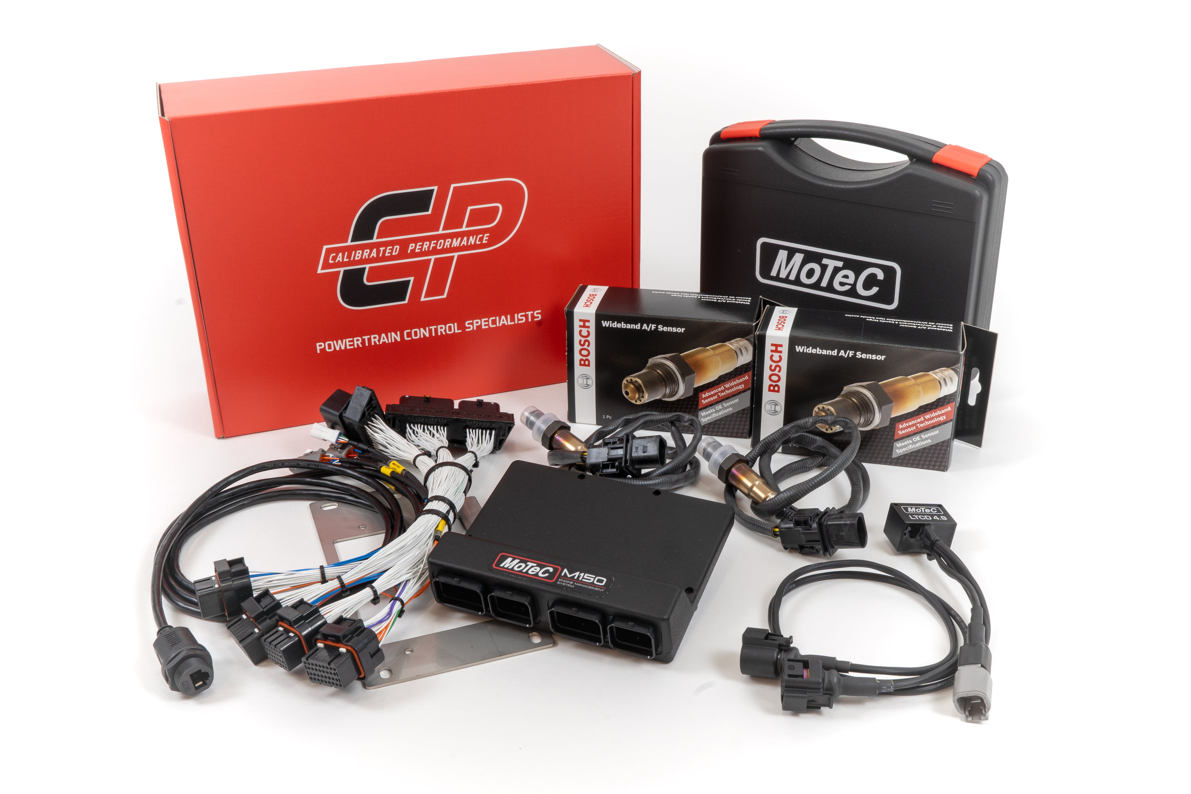

Calibrated Performance out of Australia haven't released any info on an Emira product yet, but they do a full MoTeC standalone plug-in replacement for the Evora, so I suspect the Emira will be on their radar shortly. This will be an excellent full-replacement option as an alternative to the Syvecs.
