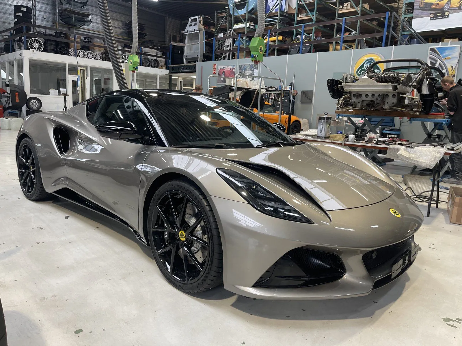

My Emira has arrived 2 weeks ago at the dealer....

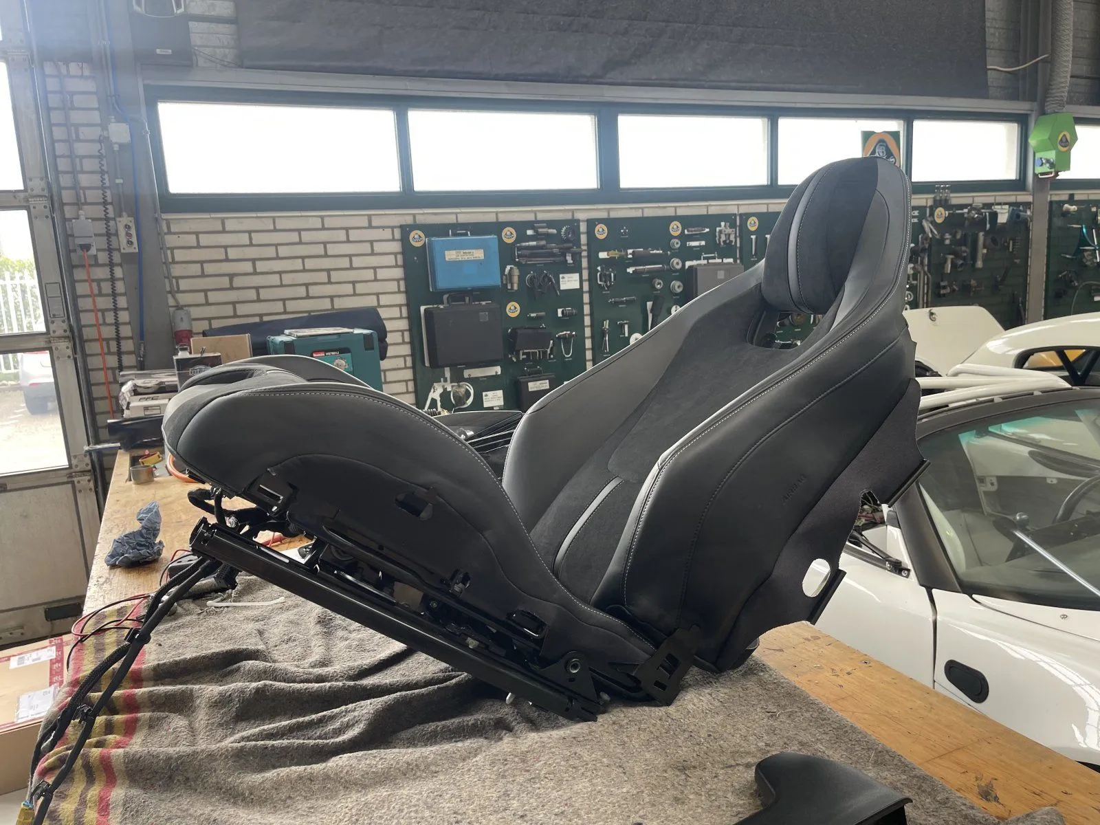

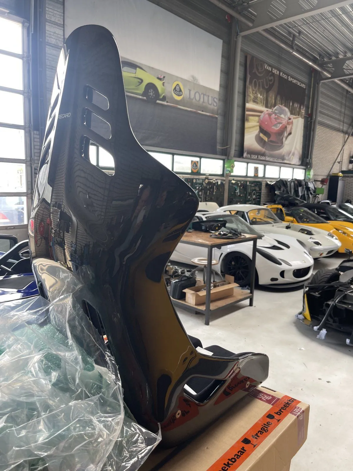

Seats are out...Recaro Podium waiting for installation, but require a custom water cut frame...in the making!

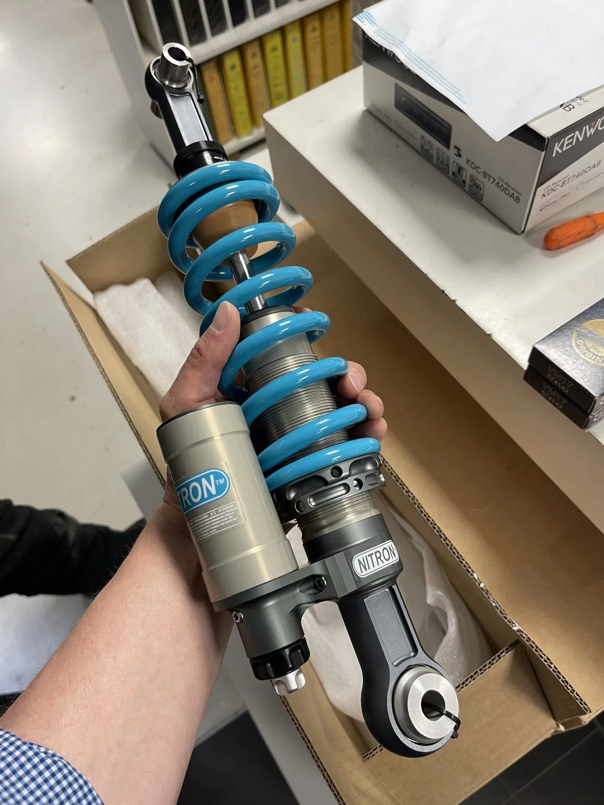

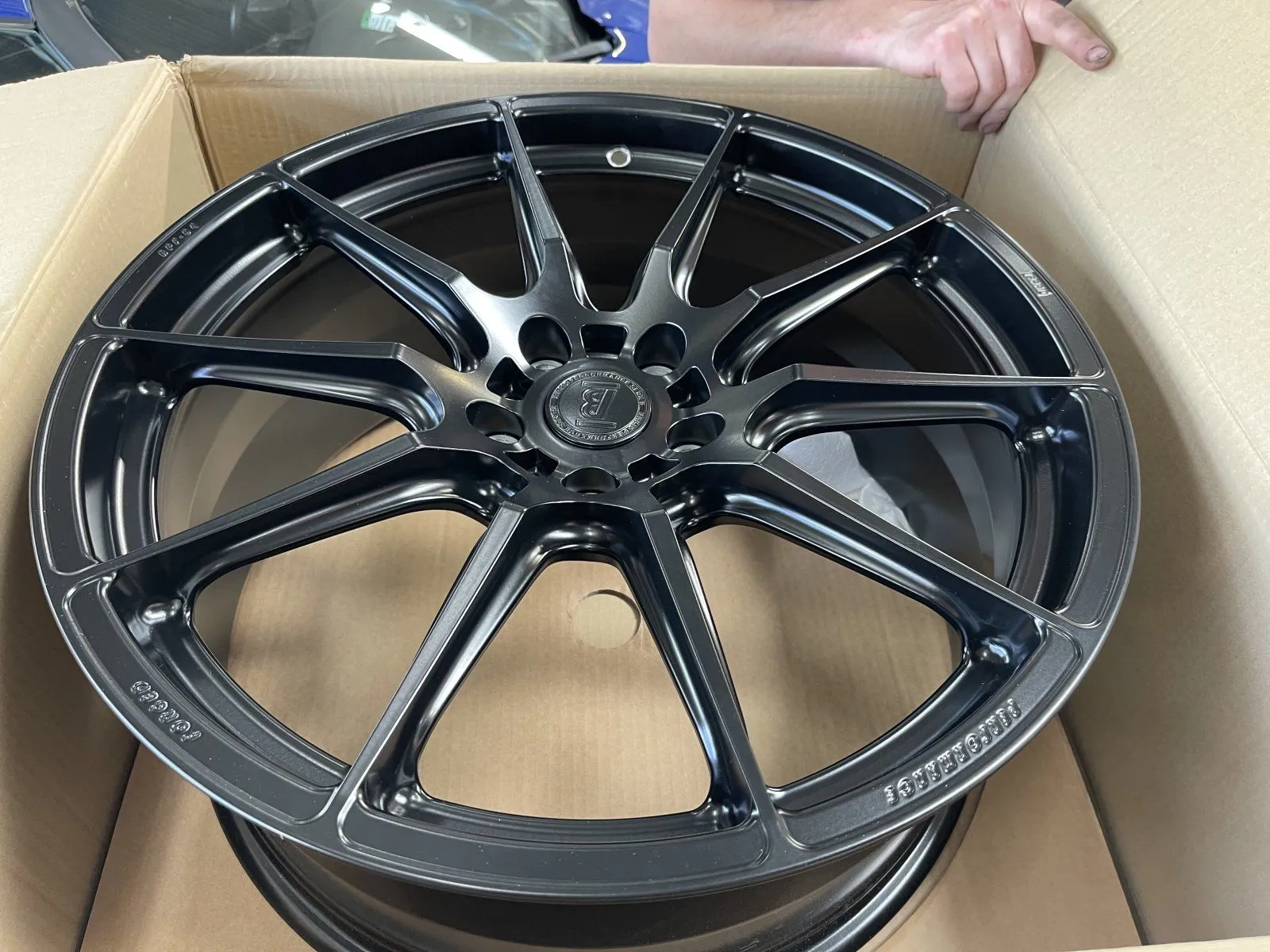

Nitron 3 Way has arrived...will be installed in combination with the Jubu forged wheels...unfortunately still waiting for the wheels, as first set was not passing Jubu's quality control...
Harness bar for the 4point Schroth harnesses will be custom made...pipe bent, now figuring out position and how to mount to original belt points as well as to find a third point to fix to the chassis.
PPF on front bumper has been installed, but needs additional work. It seems Xpell doesn't really have good patterns yet.
To be continued....
If you or the people at the shop don't mind, can you weigh the factory seat? How much weight are you saving compared to the new seat you're installing?
I was about to ask the same thing! @hagen111 might be the first owner with aftermarket seats. Can't wait to see them installed!
  • #6
We didn’t have a scale at hand to weigh them. But just to get the seats out of the car…you can’t believe how heavy they are!!! I estimate between 30-35 kgs, so for 2 seats I am looking at something like 50kgs in weight savings I expect.
Wow, that's a lot! I wonder how much lighter the 4-way cloth seats are? It would be worth it, just to take one for the team, to buy a cheapo scale and weigh the seat, just to have the accurate numbers for those wanting to do weight reduction for their cars.

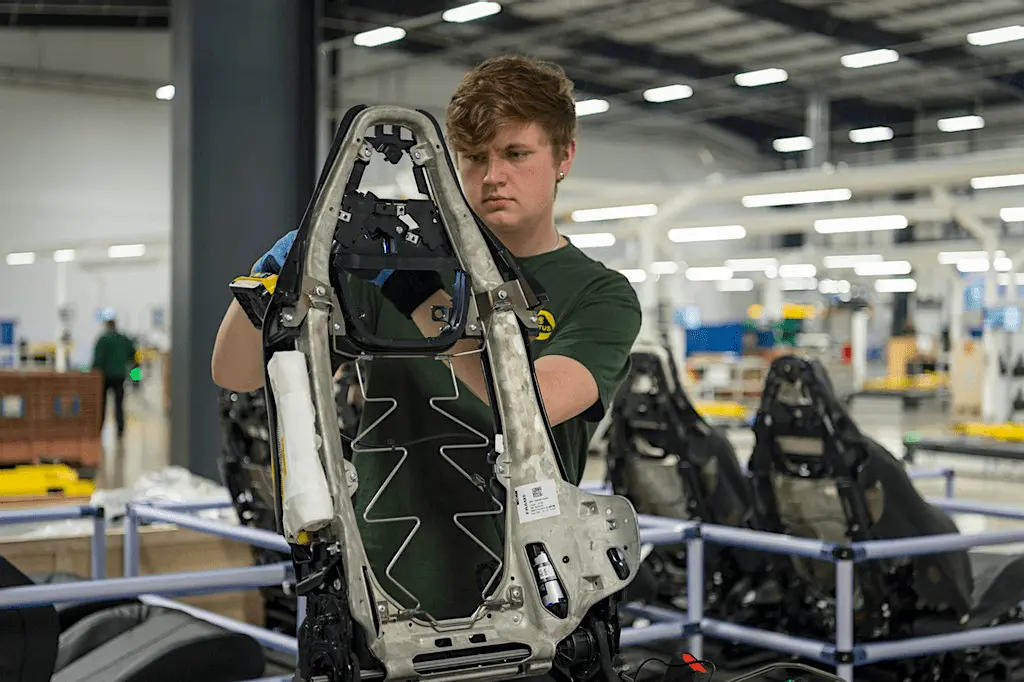

The base seats are still electrically adjustable like the FE ones, so will have motors in the base. Possibly fewer motors but that's one important factor in the weight, along with the frame itself.
I figured these seats would be heavy. Any power adjustable seat vs a carbon or light weight bucket would be a massive difference. I'm sure the lotus lightweight bucket seat will be coming in the R and S variants.
Based on Porsche 18 way (heated and Vented) vs Carbon Buckets is about 80 lbs in weight savings. The 4 way seat vs Carbon Bucket saves 32 Lbs (heated but not Vented). So in Porsche land the 4 way power seat is 48 Lbs lighter (combined) than 18 ways. Crucially the 4 way seat also sits a bit lower than the 18 way seat. I have tried both numerous times and always go with the 4 way. Also for some reason it feels more padded/support. I suppose less motors and other stuff in the seat makes more room for cushion? I dunno, just my experience. Hoping the Emira 4-way power seat is similar in both weight difference and a tiny bit more head room.
I'm wondering if the frame is going to be the same, just 4 motors instead of 12. Even without the motors though, according to this photo the frames look to be pretty hefty.

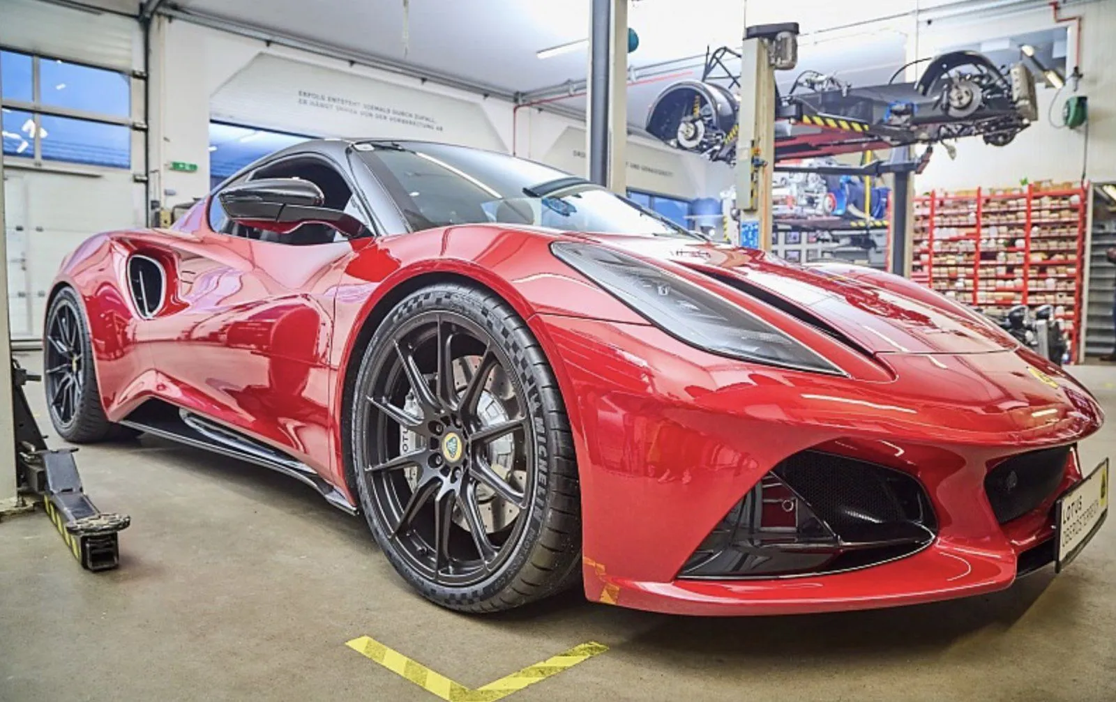

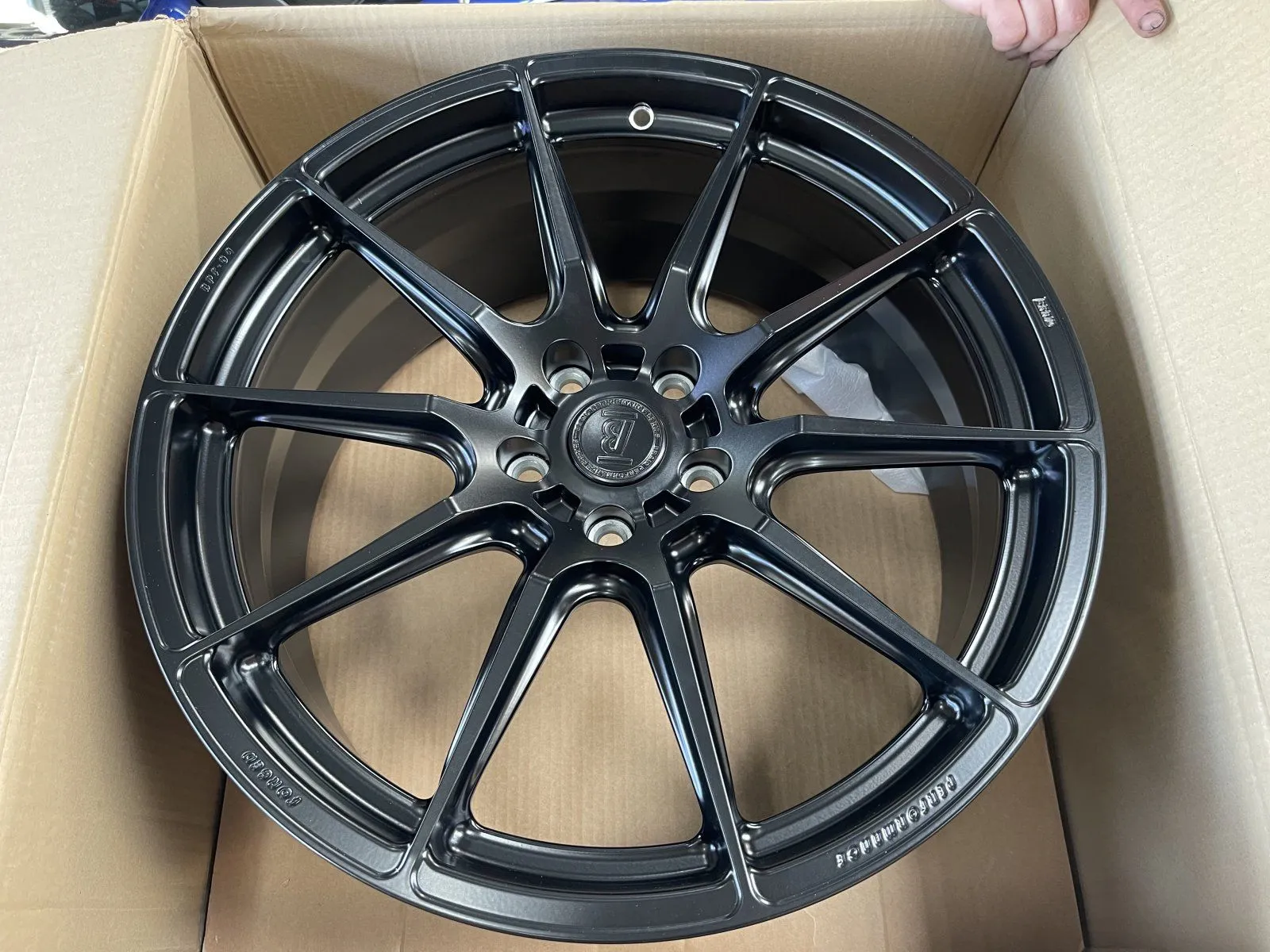

What's the main advantage of those wheels? I don't see visually all that much difference from the black stock ones. Or did you go for a different size / offset?
  • #18
The original wheels are actually ok and very good looking, but these wheels are next level in terms of finish and detail. Forged and machined, really really beautiful. It depends what you value in life…food is food, a watch is a watch…a fiat panda does the same as a Porsche 911…
Beauty and sense are in the eye of the beholder. In my opinion stance and the wheel make a car! Also love the process of working on my cars and making them better (in my eyes)
And my guesstimate are they are much lighter vs original. I have carbon wheels on some of my vehicles and weight of the wheels have a MASSIVE impact on how a car or bike feels…as well as it helps change direction faster.
I think the new rim design is much nicer than the stock design. I like all the mods you are making and desire the same car you are building. Nice work! Which rim did you choose from Jubu? If I remember correctly they had two different specs for the Emira. One option stock dimensions and the other had more offset or was wider. Could be wrong but I thought there was two options.
