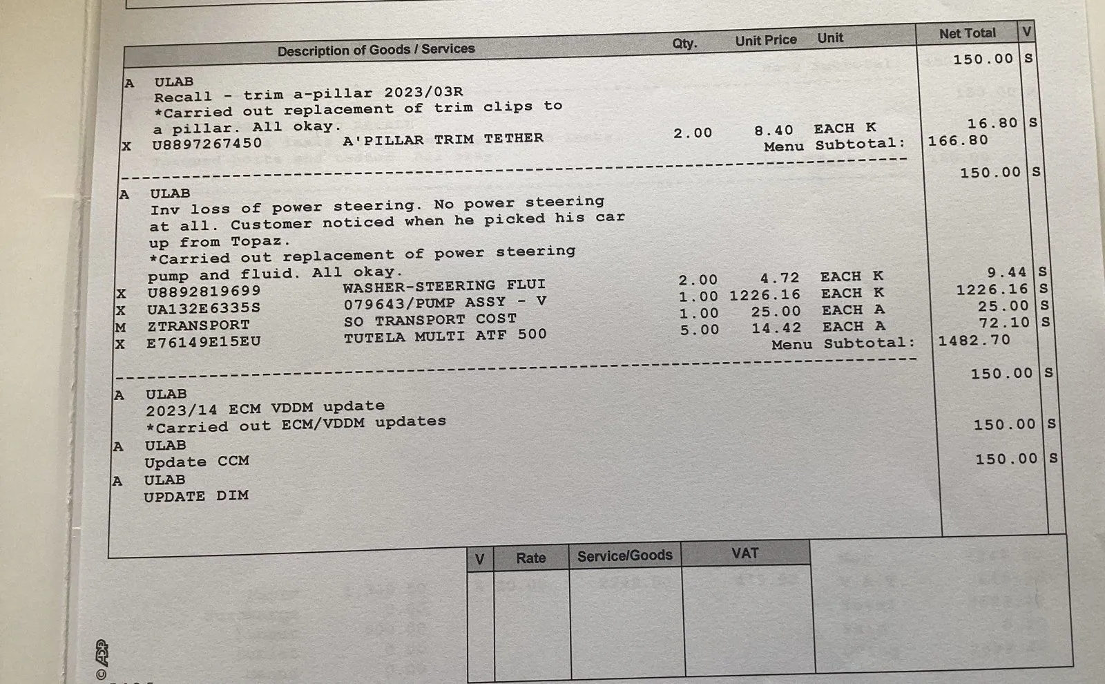

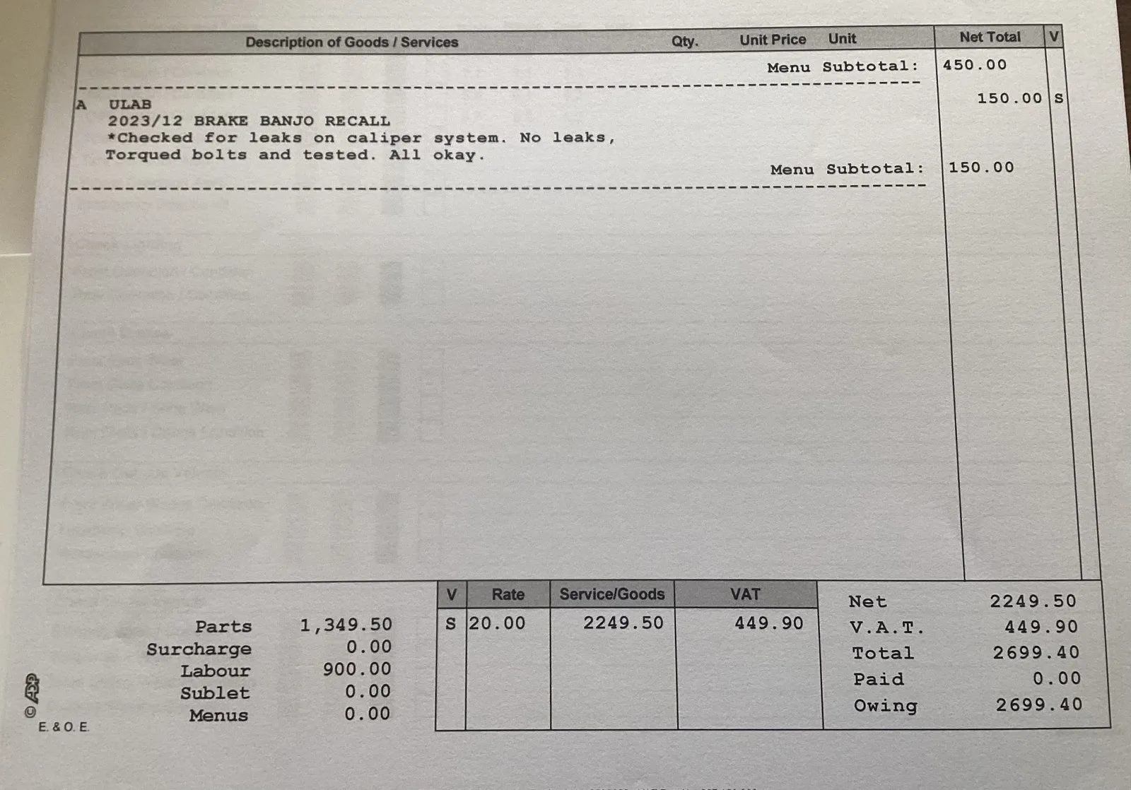

Hi anyone who thinks they have a problem with the power steering pump I would have it checked out before your warranty runs out, I’ve had to have mine replaced and a few other issues sorted out under the safety recall.
This is what the dealer charged Lotus and probably also charged them for the courtesy car on top of this, This must be eating into their profit margins. Quality control my arse🙄
