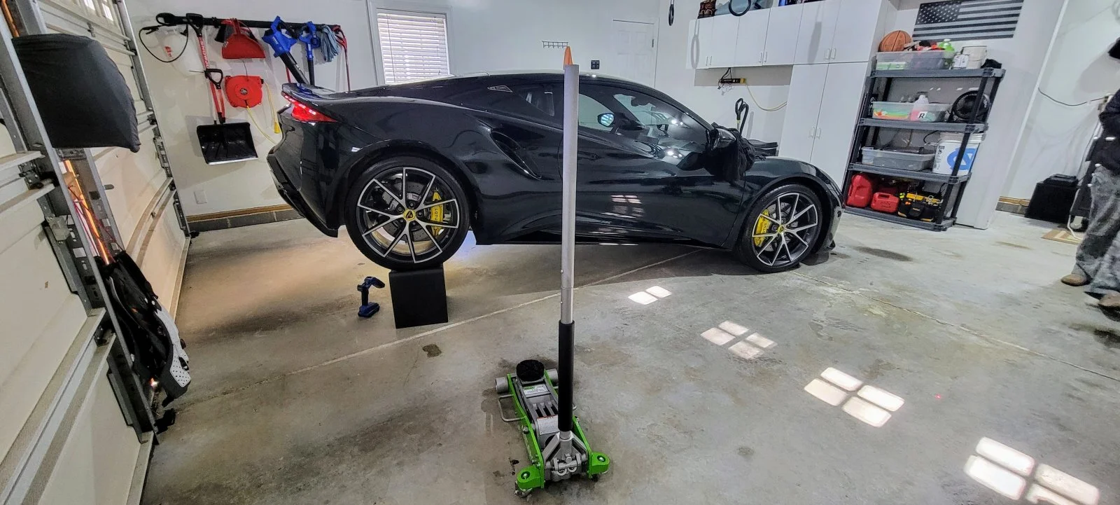

Solid investment -- 2 aluminum 19" floor jacks and a pair of 12" Race Ramps --- the car was so solid up in the air and I felt safe for a change! I did block the two front wheels, but they never budged anyway. I did the @GRP 3rd cat delete and Miltek valve controller today. Amazingly, the exhaust pipe and controller were the easiest part, no struggle whatsover; the freaking diffuser and it's BS clips really got me frustrated though....note to self, get quality spare clips. Anyway, the car sounds amazing!

Nice! The race ramps were stable? I looked into them before but it said 1500 pounds per ramp and didn’t want to risk it

Yes extremely stable -- I was quite impressed and happy with them! If I had to do it over, I might get the 8" instead of the 12" -- I mean it was great having all that space under the car, but it was more than I anticipated or really needed. The Emira did well though, so there's that!

The weight supported by each rear wheel on a V6 Emira is about 1000 pounds- wouldn’t be a problem.
