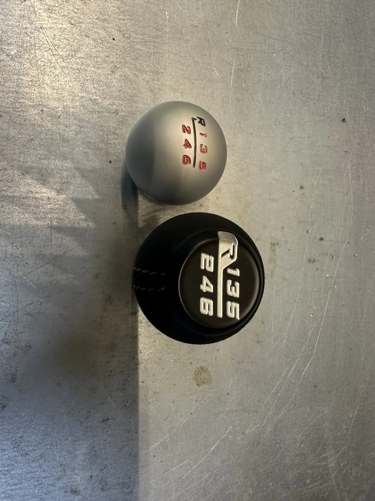

Yes my thanks as well to crestima for the helpful advice. I saw elsewhere on the Forum, the OEM standard transmission Emira shift knob, is 46 mm (1.81") in diameter. That compares to the Raceseng Evora shift knobs that range from about 2" to 2.1", for any that I'd buy. My preferred Sphereology with letters/number, looks to have 2 available, but in the brushed aluminum only, whereas I'd like it in red/black to better match my Emira. The Nitro, Stratose and Traction styles (which also came in red/black at one point), look to be out of stock, as well. I've sent a "customer enquiry" to Raceseng today, asking if they'll be selling Emira shift knobs and the Sphereology one I'm looking for, in particular. I'll advise of their response.

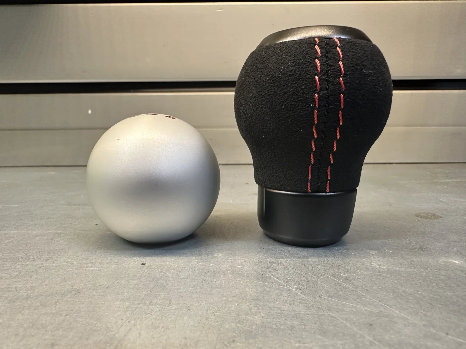

Ordered the “Evora/Emira” Stratose Raceseng shift knob (black alcantara; red side stitch; gear shift silver top numbers), being one of the few types they had left. Ordered September 6, so it took 10 days to reach me in Canada (including weekend days), so pleased with their ship time. Need some blue locktite before I try install.

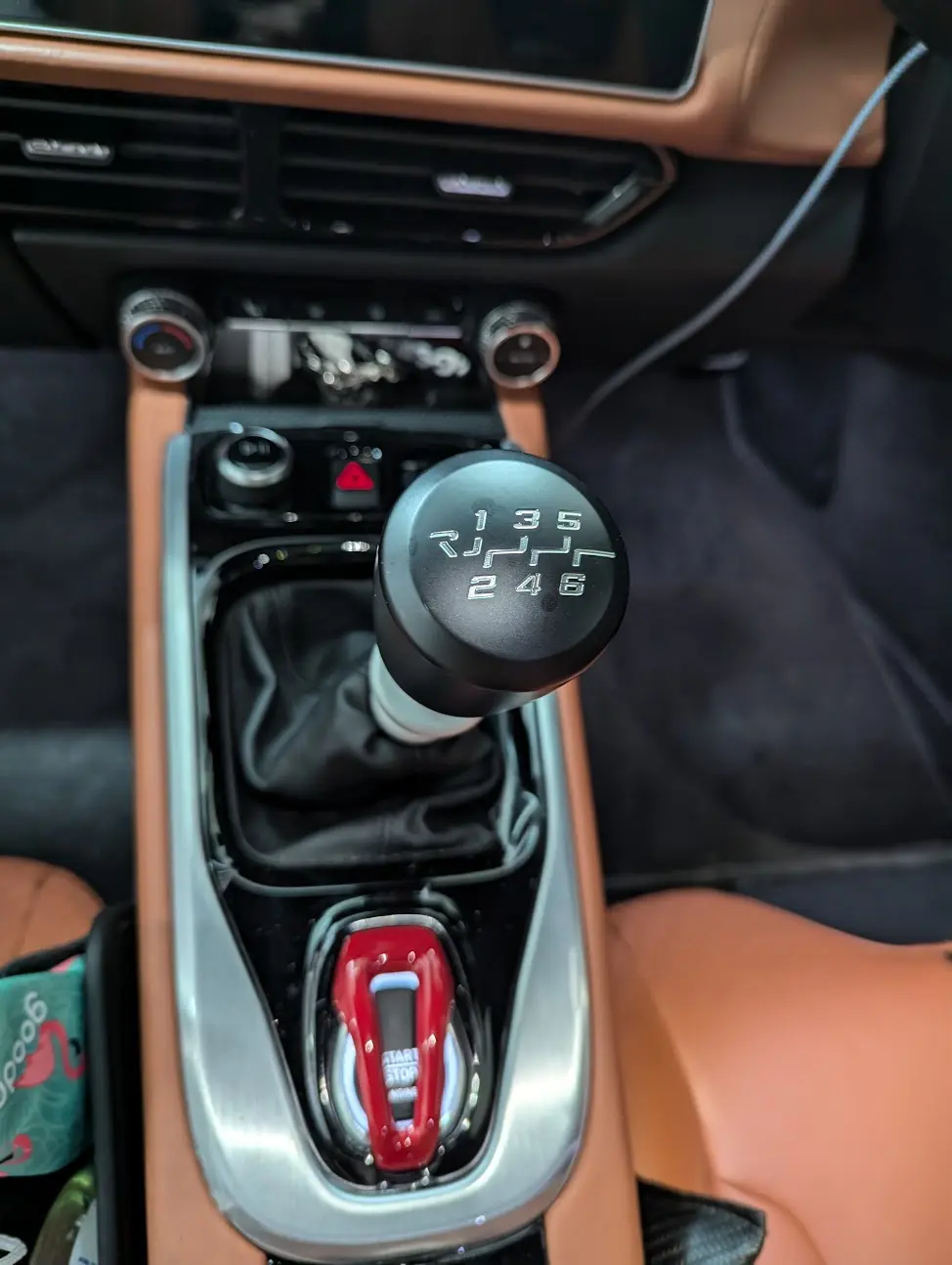

Raceseng shift knob installed and I'm happy with it and like the extra weight. A few things to add to the helpful advice above from crestima:
-don't forget to install the spring that came with the OEM shift knob set-up. The install video on the Raceseng website, doesn't show that; likely because it's a different vehicle;
-the rubber washer inside that OEM shift knob, didn't work on the Raceseng shifter I installed. Perhaps it may work on other types?
-like crestima, I didn't have to use blue loctite on the new knob itself; only the adapter;
-the particular Raceseng shift knob I installed (see my post above, for the description) sits higher up from where the OEM shift knob was. Not too much but I'll have to get used to that different feel;

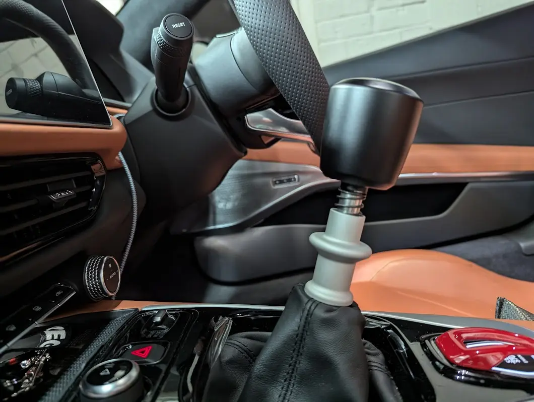

-since you have to lift up the "shifter collar" to get into reverse, you can't install a Raceseng shift boot collar below the shift knob, to eliminate the exposed shifter "shaft";
-a few photos attached, which may help some. One photo shows me lifting up the "shift collar" as you would, when shifting into reverse. We'll see how the alcantara (which matches my steering wheel) holds up. Cheers!

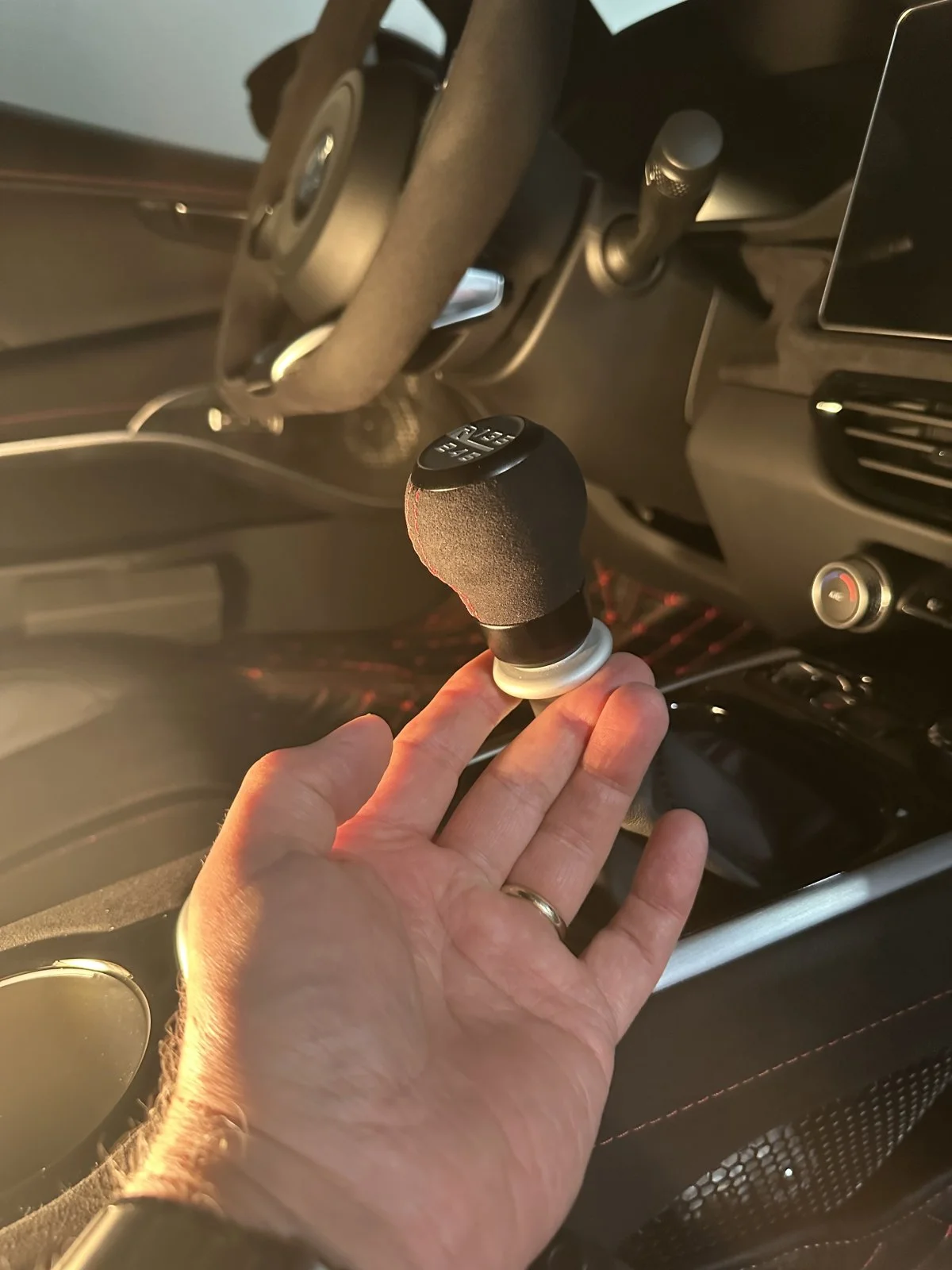

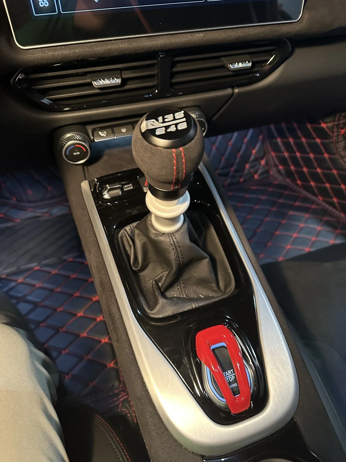

Fitted the Ashiko knob. The extra weight feels good and help but not happy with the fitment. Would have gone with latheworks if I had known about them before ordering this as they have a lot more customisation options
