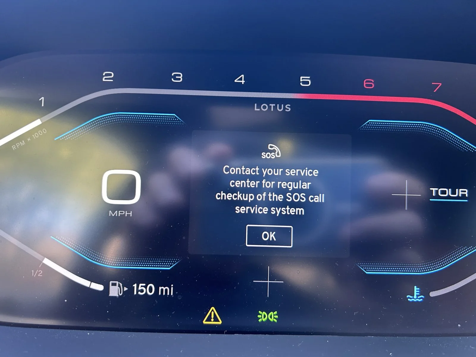

Just started getting this, twice in the past two weeks. Went away after a while and come back again today.
