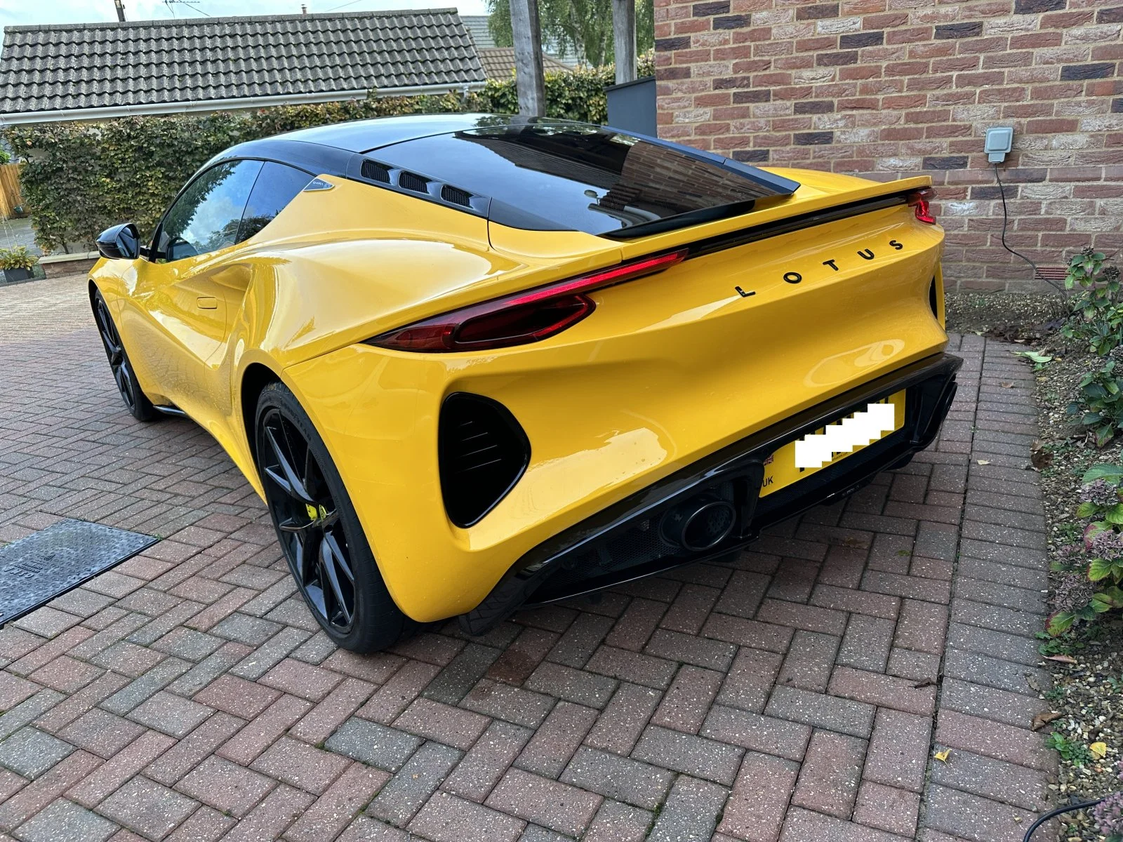

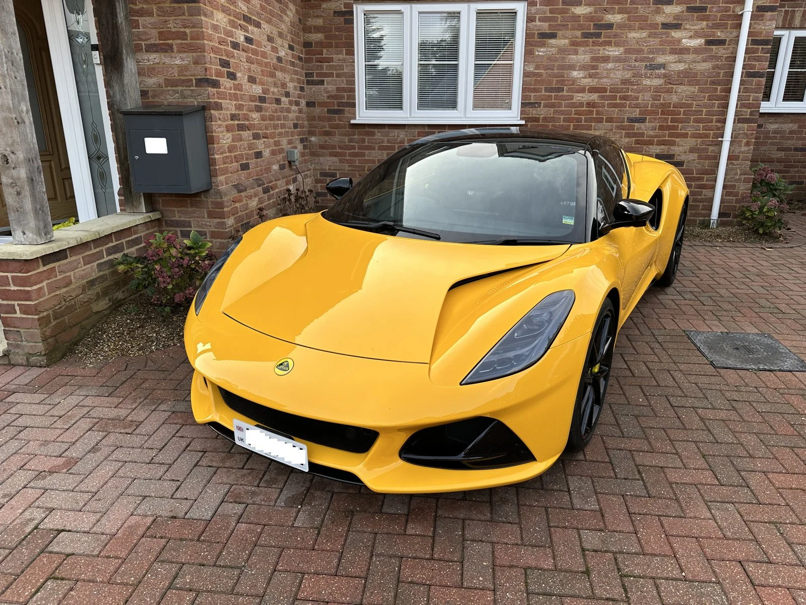

View attachment 55864View attachment 55865
I found warming the old plate with a hairdryer and then using dental floss to cut through the old adhesive pads worked great. The only issue is getting any old pad/adhesive from the plate holder before sticking the new plate on.
