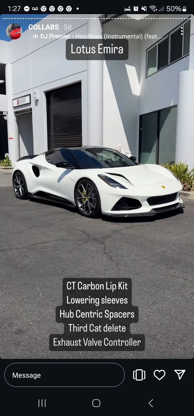

Hello everyone,
I'm experiencing some vibration in my Emira at high speeds. I can manage it by gripping the steering wheel tightly, but I wanted to reach out for advice.
Recently, I've installed the following:
  • Lowering sleeves
  • 12mm GRP hub-centric spacers
  • CT carbon kit
  • Eventuri intake
  • Miltek valve controller
I thought an alignment would resolve the issue, but it hasn’t. I previously had worse vibrations with non-hub-centric spacers, but I still feel minor vibrations with the hub-centric ones. Is this normal for a sports car, or should I consider getting my tires balanced?
I appreciate any insights that can help me fully enjoy this car!
Thank you!

PS. your car look sensational!!
