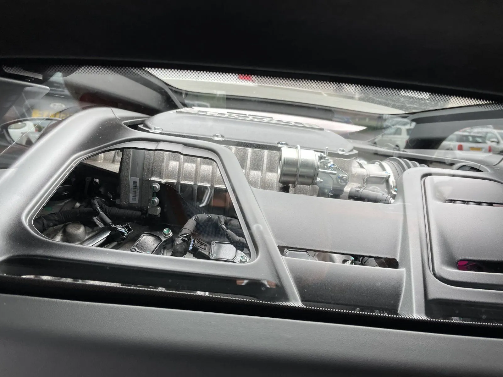

Down behind the engine probably.
Be a test of your gymnastic ability to get it out!
That panel is quite fiddly to engage so I normally don’t bother and just pop off the whole front cover to check the oil.

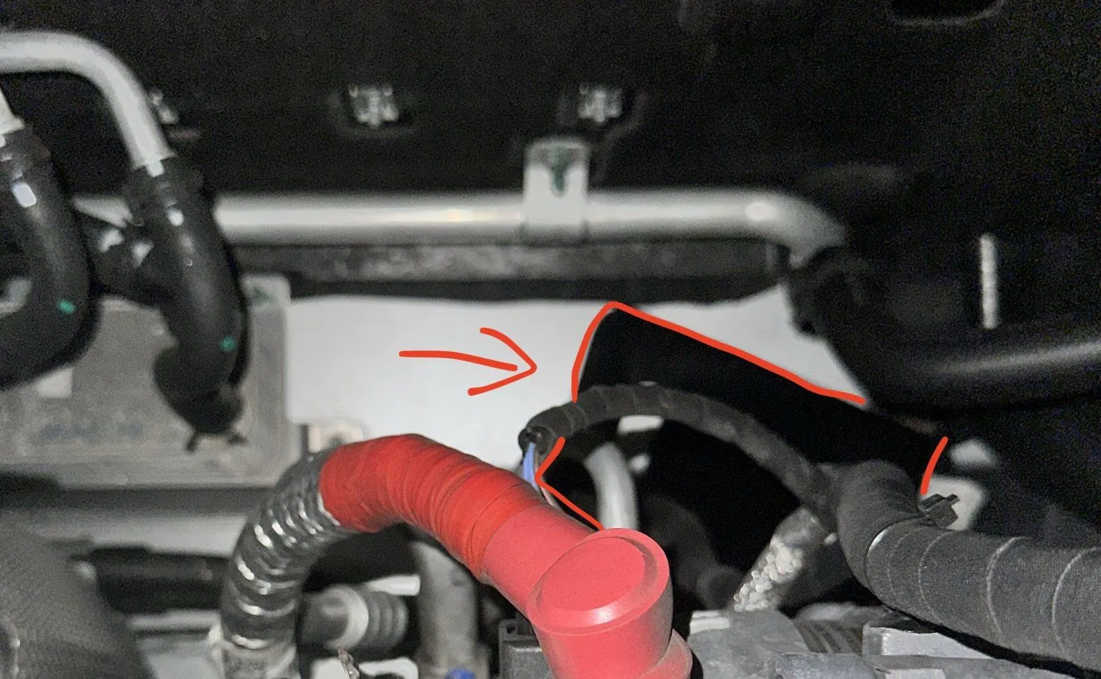

Ok... managed to get it out. Looks like it was just lying there flat on the engine bay floor:
Just reached out deep with my arm (cold engine) and managed to grab it. Mind you, I am quite tall / long arms and even for me took some stretching to get it.
Upon inspection the design is flawed in that the shape of the cover is such that it can fall through. I will have to think how to more solidly attach it so it doesn't fall off on bumpy roads. Taping it comes to mind, but a more elegant solution must be possible.

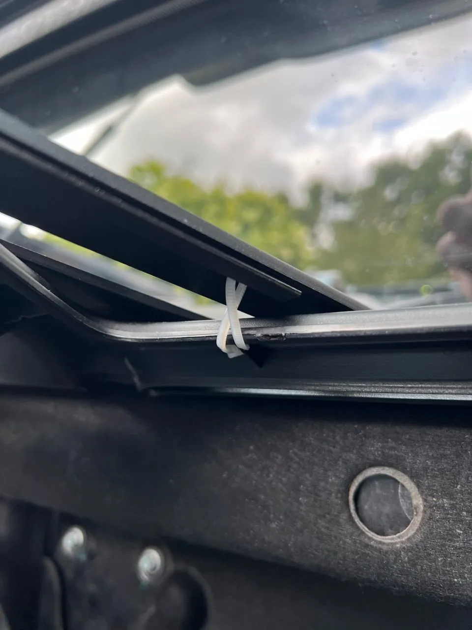

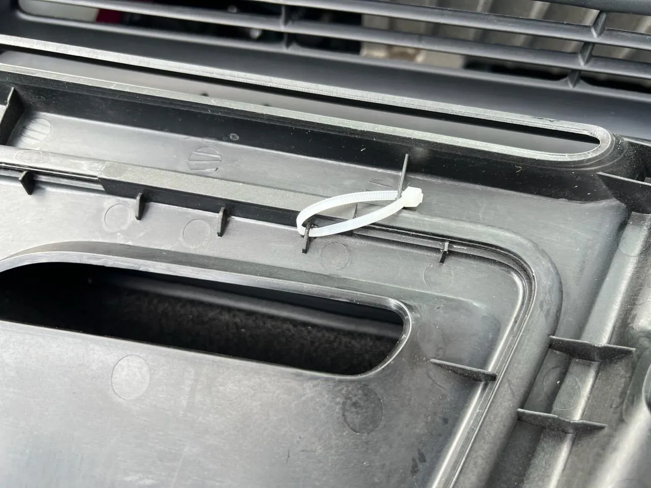

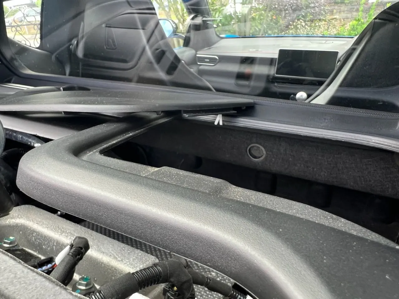

My fix - drill some holes on the underside for a small cable tie.
This is only to stop it falling down as I don’t use the little panel. It much gives much better access to pop off the whole front cover, which is nearly as easily removed as the little one.
It’s a good idea. Mine was under the engine and retrieved successfully - not melted or chewed up thankfully
