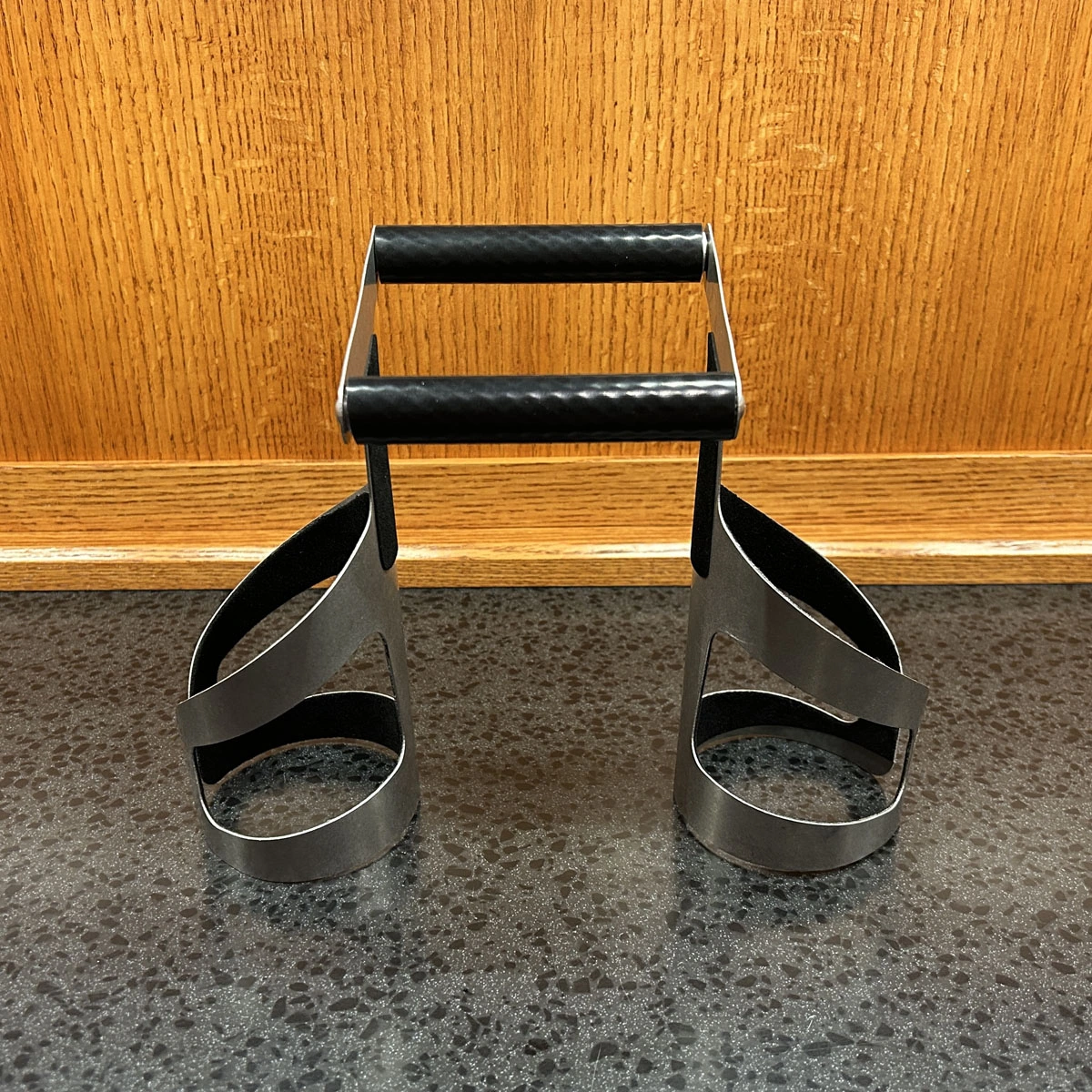

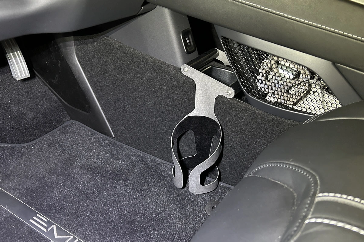

Finished my prototype for a touring cupholder.
The first iteration works pretty well...goes in and out quickly without a trace...

Something removal like this would be ideal for road trips, nice job!
Would love to hear and see more about how you created these. Any chance you'll be creating/selling more down the road?
This looks like 2 bicycle water bottle holders, minimal brackets (with felt/alcantara tape to cover bolts) and then some kind of threaded rod connecting the brackets with squishy hose over the rod section.
There's no "bottom" to these holders so coffee/bottle/whatever rests on the carpet.
  • #5
The holders are 20ga stainless steel cut on a waterjet. Connectors are 6061 Aluminum covered with silicone hose…
No intention to sell them, but they could be improved and reproduced pretty easily I would think. Carbon might be nice… 😎
