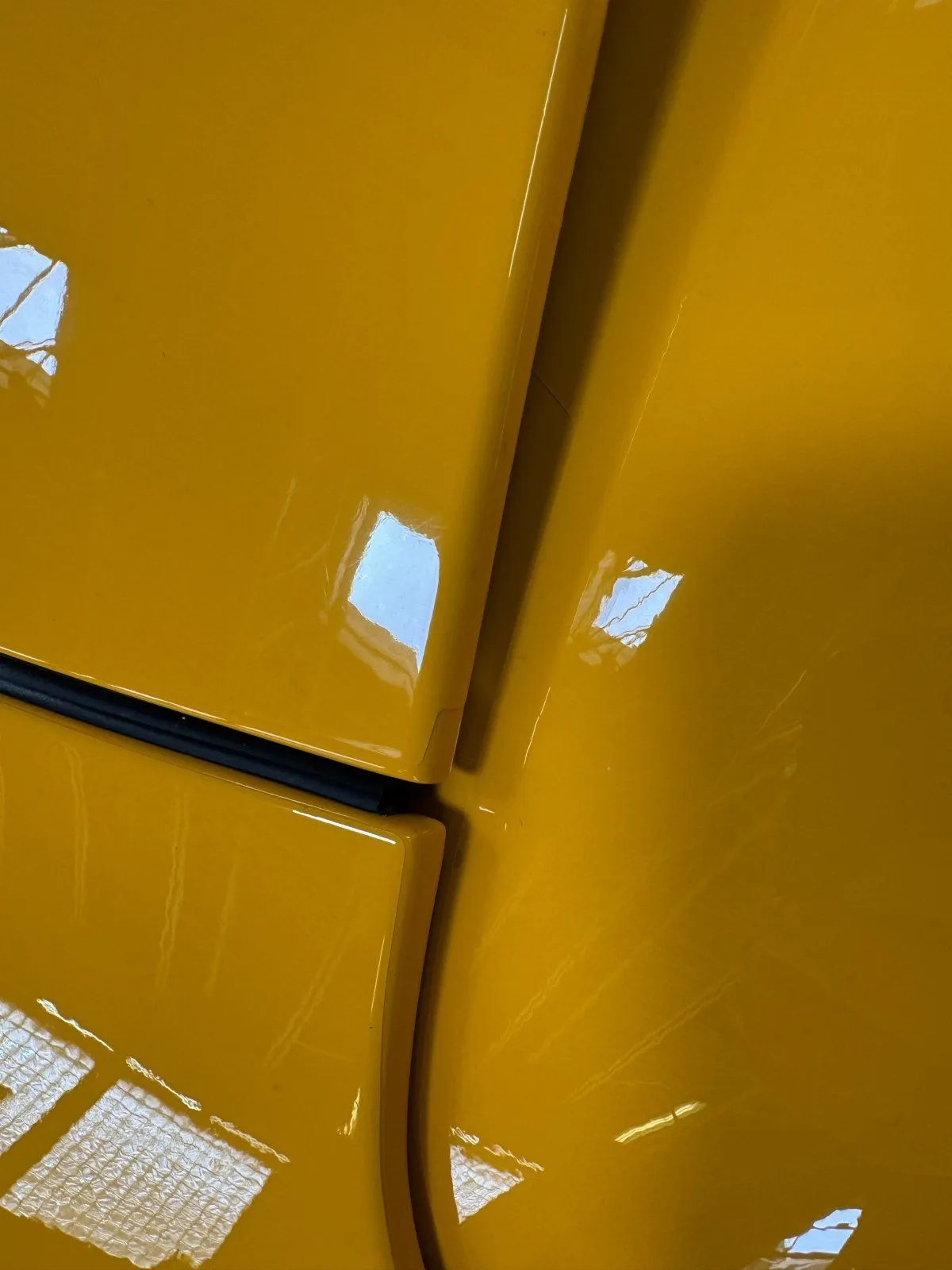

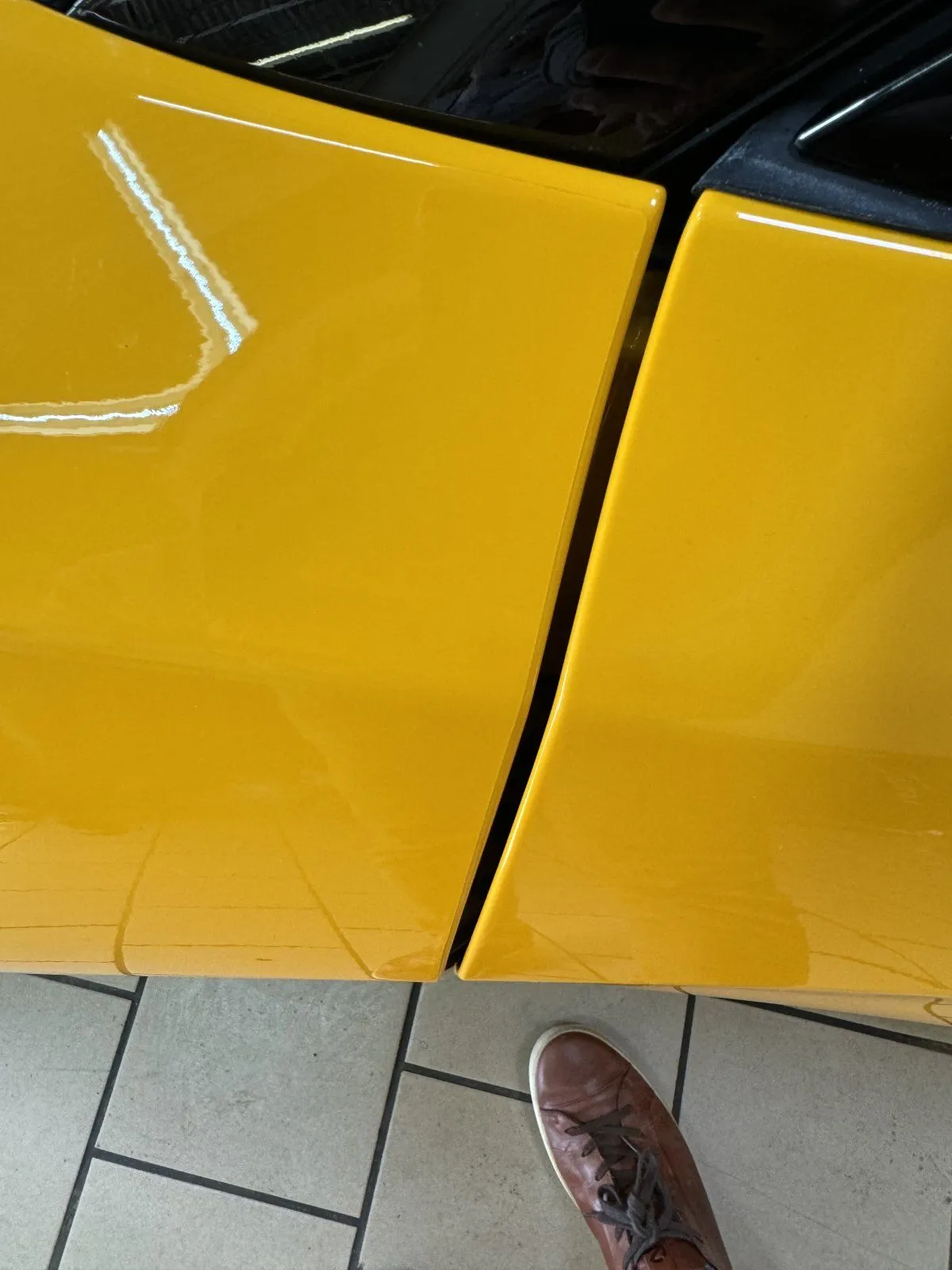

Thatā€™s what Iā€™m thinking - 30 years of using old techniques and not keeping up with the times. This is pretty bad right?
I like my dealer but this doesnā€™t look ā€œnormalā€ā€¦

Very little of this back and forth we have on the forum is useful without knowing what product we are talking about and who the installers are.
They use 3M and XPEL, I asked and they said both are 8MM and itā€™s pre-cut. He says he 3M is better but I havenā€™t heard that anywhere else - price is the same for either.
Other speciality shops I checked out said they would use a combo of pre-cut and have their own equipment cut the scans with extra to wrap around edges depending on which sections theyā€™re dong and the only place they wouldnā€™t wrap around is if there are 2 adjoining panels where there isnā€™t space. Most are using Xpel. And recommend ceramic where they would use a different ceramic for the PPF painted parts and something else for the glass and wheels.
Yeah I would never pay for that. That is really bad. Looks like pre-cut pieces and I believe even with that, an installer can modify it to over size the pieces so they wrap around so the edges aren't seen. Aside from aesthetics, the coverage isn't as good as it should be, plus if there ever is any lift on the edge of the film, it will attract dirt and that looks very bad as it shows up very dark against the paint.

You can tell our cars are getting closer! Same experience yesterday. Visited a ppf installer. Was surprised by the gaps around many of the panels. Never really looked that closely. I'm out. Ceramic will do
Yeah, when Iā€™ve looked at other pplā€™s cars with PPF they look great but Iā€™ve never looked up close like I want to for my Emira and now Iā€™m not sure if what Iā€™ve seen is really how it is, or if this is just a half ass jobā€¦
I would be furious if I could see all of those seams. Iā€™d rather not have PPF than see that many edges.
Thanks for that, my thinking exactly - just wanted to know if Iā€™m crazy, but I think consensus here has confirmed Iā€™m not and need to look elsewhere.
Jesus, those are bad. I would be pissed if that was my car.

Those photos are 100% a pre-cut and it's quite common to see that at many PPF installers. Check out some non-exotic cars at your local cars and coffee and you'll see others like that. They can modify the patterns to be oversized in order to cover most edges, but it's clear this install did not attempt that. The PPF on my daily looks exactly the same. I'm not too upset because it's just my daily and it cost like $4k for the whole car back in 2018.
For the Emira, I'll be looking for someone who does custom wraps with either STEK or XPEL and wraps as many edges as possible. It will cost more, but it will be worth it if I keep the car as long as I think I will.
