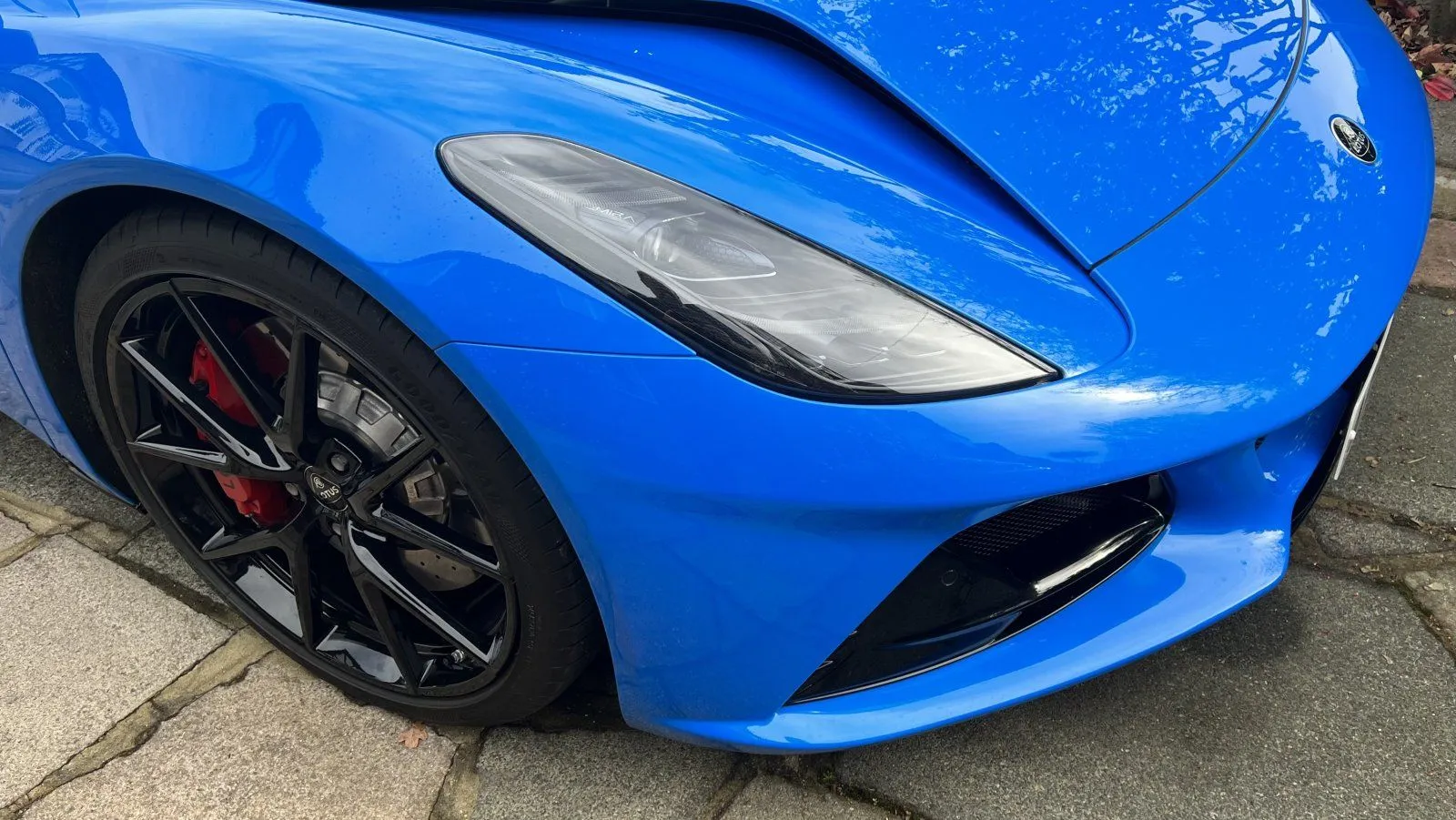

Finally got round to installing the nose badge to complete the black’n’blue look.
Note for extra OCD points, black valve caps!

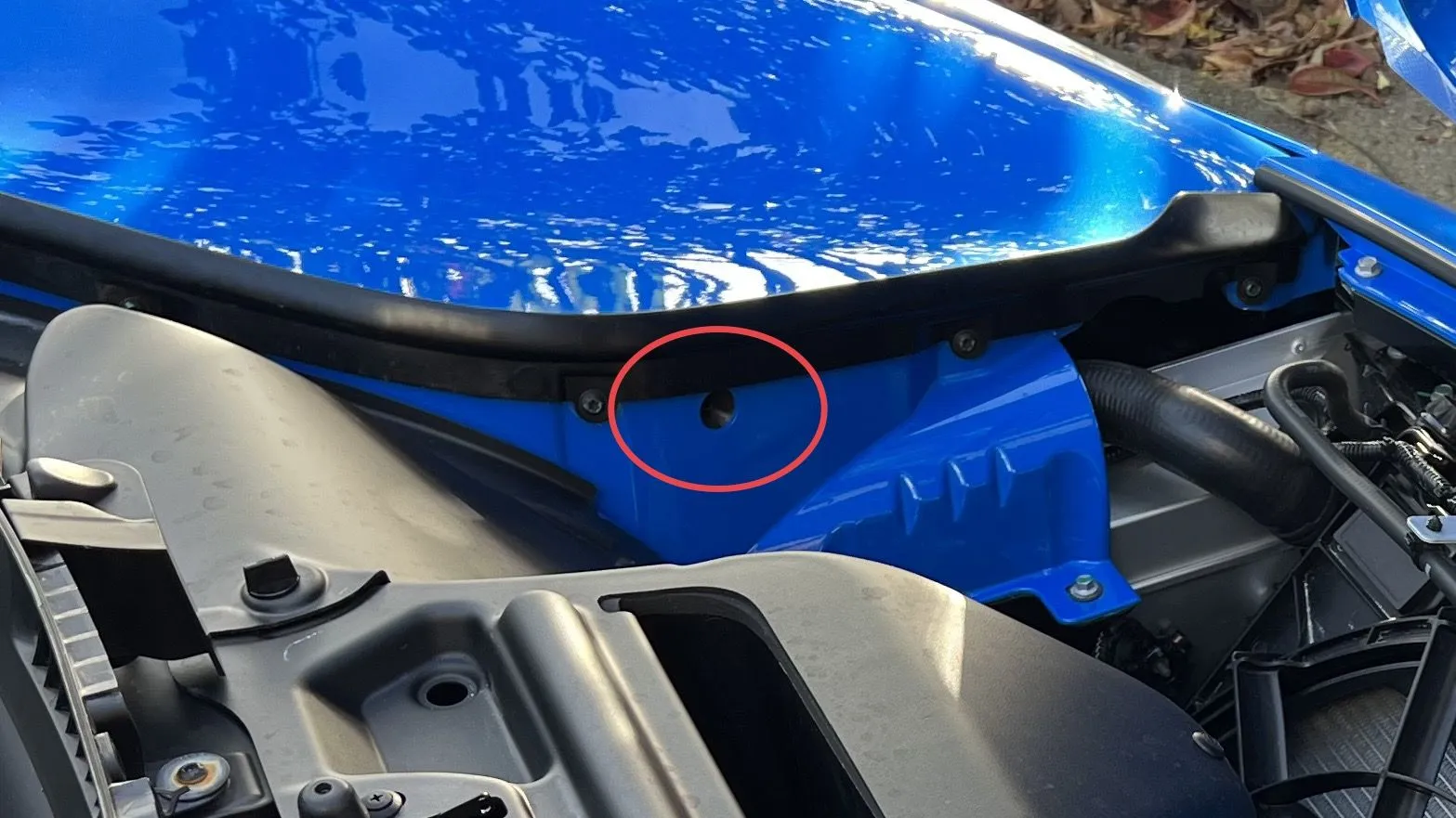

While waiting for Autoglass I’ve found another “new thing”.
This is a headlight adjuster.
Behind this allen socket is a bicycle-type cable that goes to the back of the headlight to adjust (presumably) the up/down.
In front of the front wheel in the wheelarch liner is an access panel behind which you can see the mechanism. The above adjuster in the front space saves having to mess around behind the wheel.
It’s not mentioned anywhere in the handbook or service manual that I can see.
Maybe they don’t want us messing with the carefully set up (🤔) LED lights.
