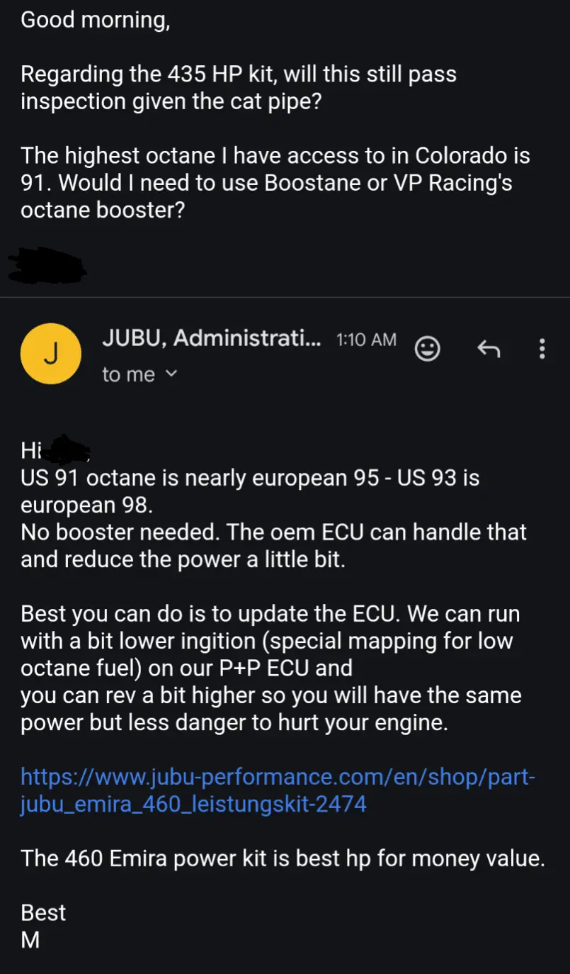

I reached out to them regarding the 435 kit and received a pretty underwhelming response.
No answer regarding emissions testing, and nothing about whether octane boosters would help. They do imply that 91 octane available locally wouldn't get it done though.
