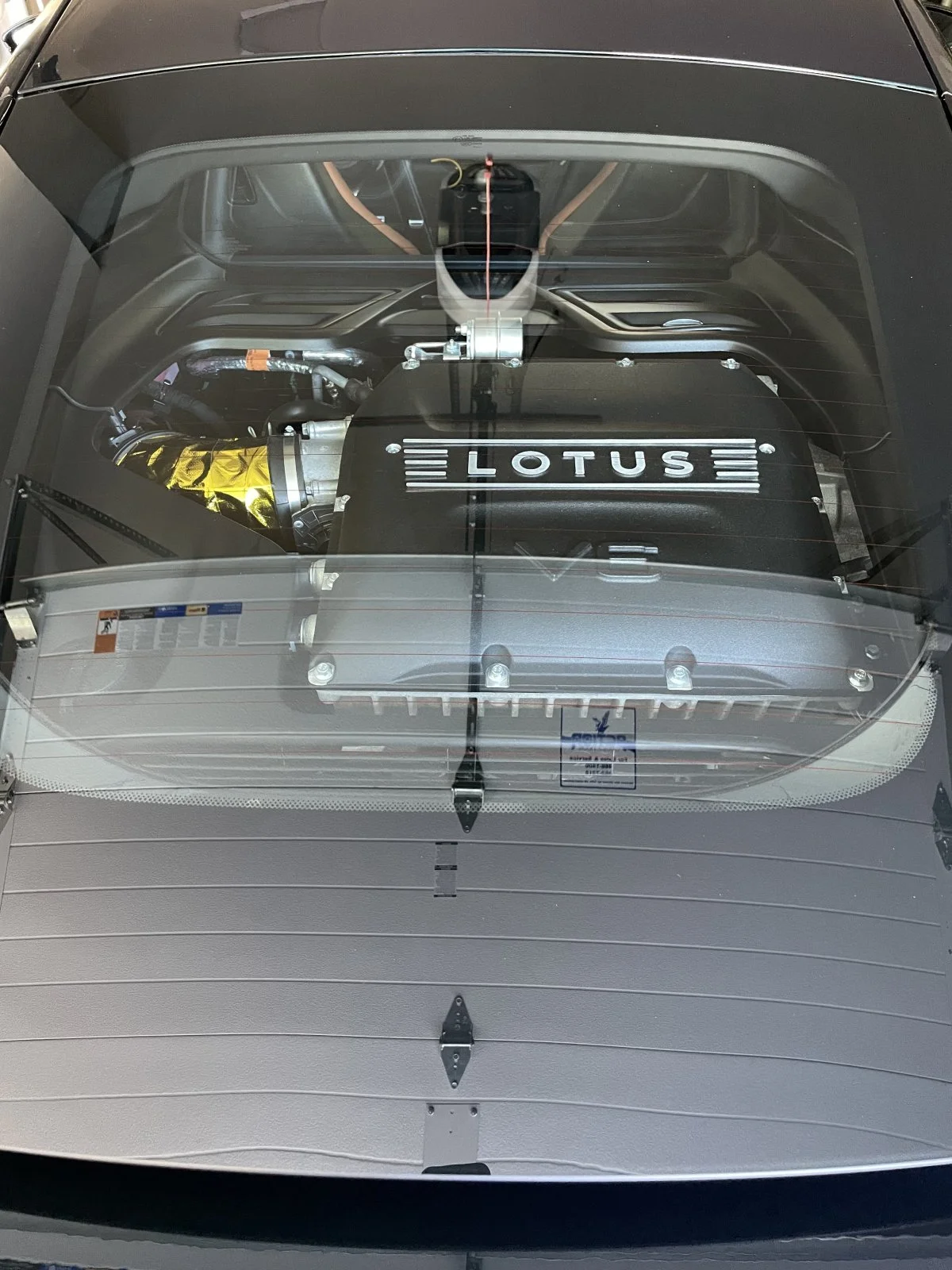

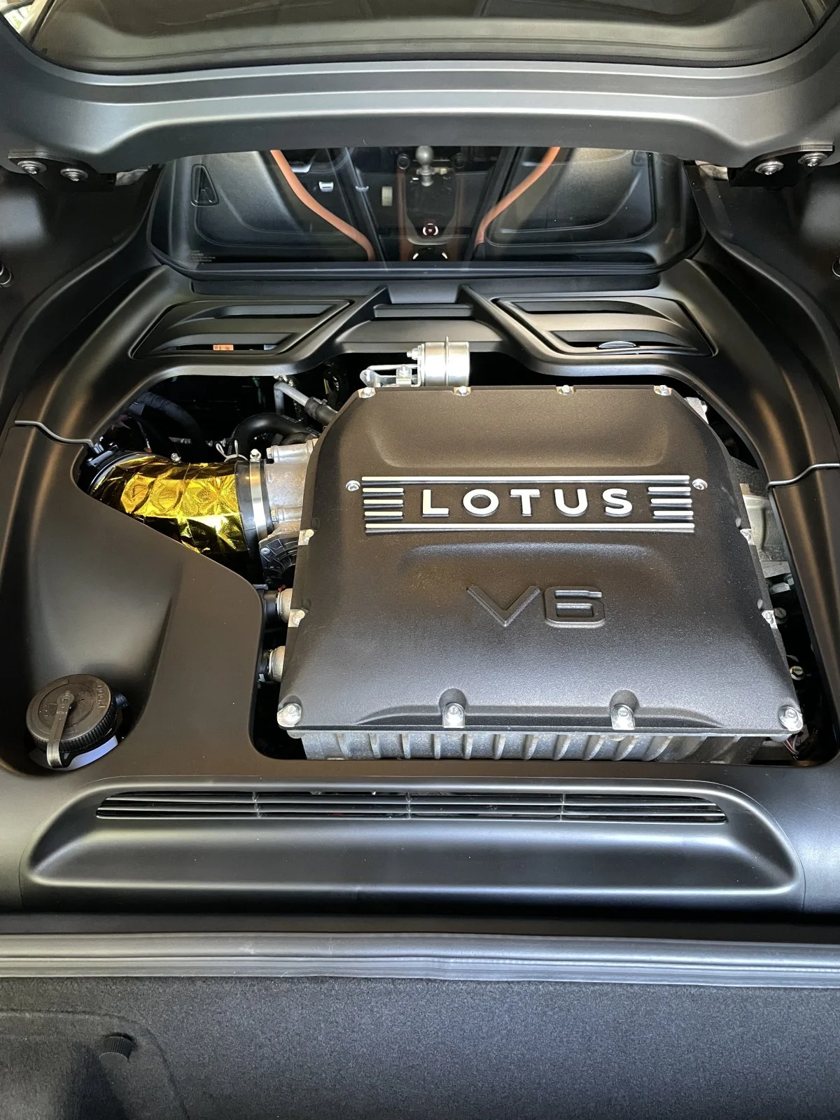

I got some gold heat reflect tape and put it on the Eventuri connector tube. I did it mostly for cosmetics, although obviously it will keep the tube cool. The travel path from the side of the car to the supercharger is so short, I doubt it will make much of a difference for street driving. For those taking their car to the track, it will probably make a bigger difference; especially to help minimize heat-soak after you come off the track. I just like the way it looks. There are a lot of small ridges all over the tube, so it made it a bit difficult to get everything to lay down. I washed the whole tube in dishwashing liquid and let it dry thoroughly before putting the tape on. It stuck to it with no problem. If anybody else is going to do this to their Eventuri tube, I'd recommend using smaller cuts of tape instead of trying to wrap it with long pieces. There's a lot of changes in shape and angle that are just easier to cover with smaller pieces.
Through the rear glass (I don't have the privacy glass) I think it jazzes up the engine compartment nicely.
