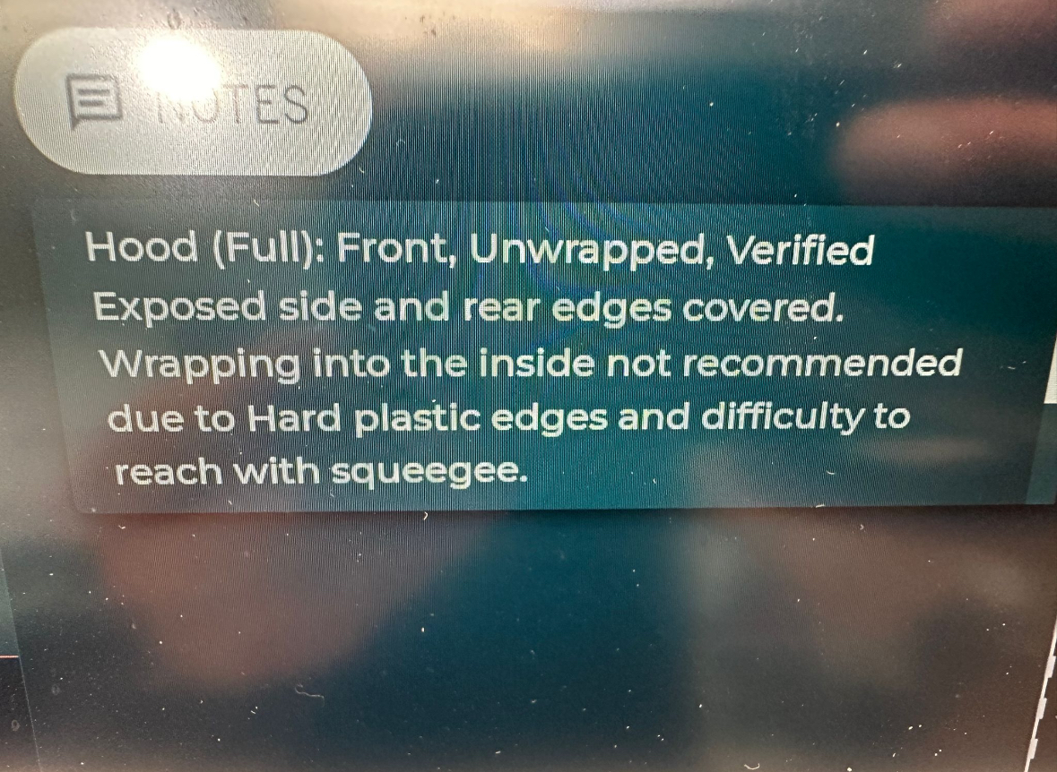

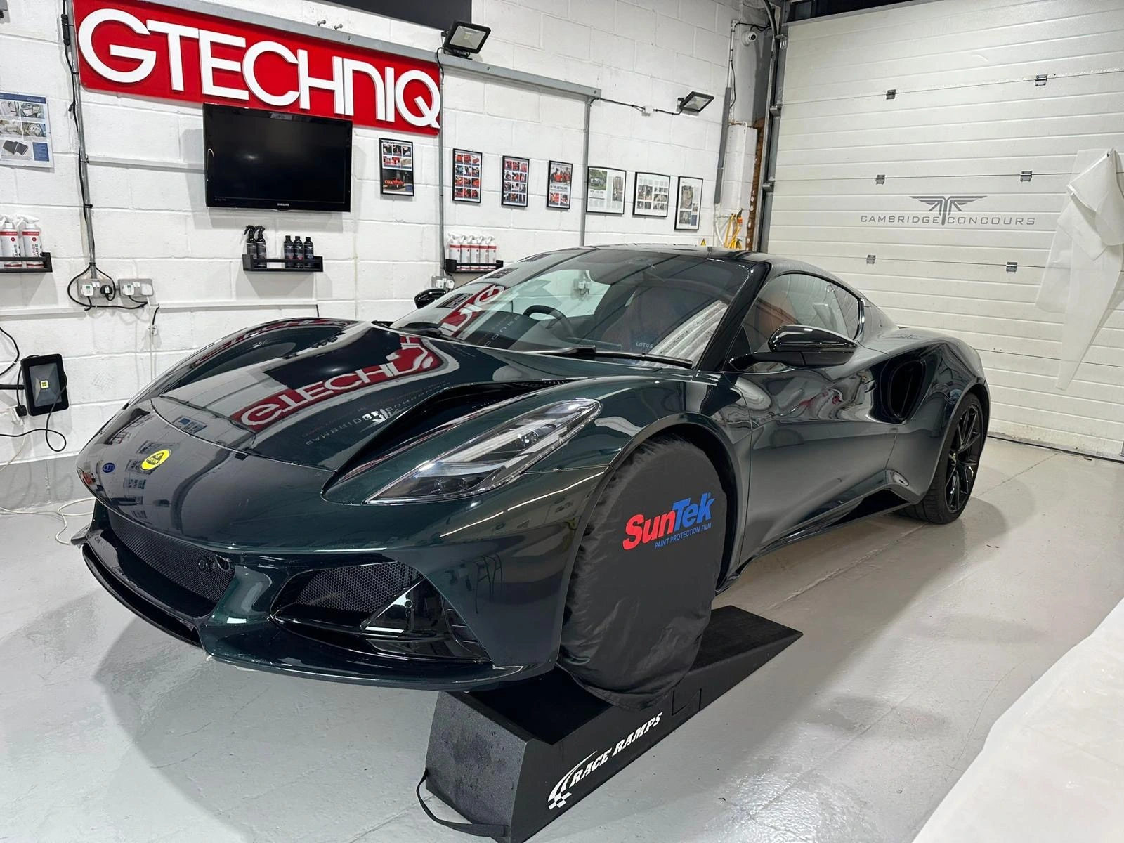

They have used precut templates but interestingly there was a note on for the bonnet saying not to wrap it round (see below). This is using Suntek Reactions film.
The installer extended the template and managed to do it, but it was a PITA by the sounds of it!
