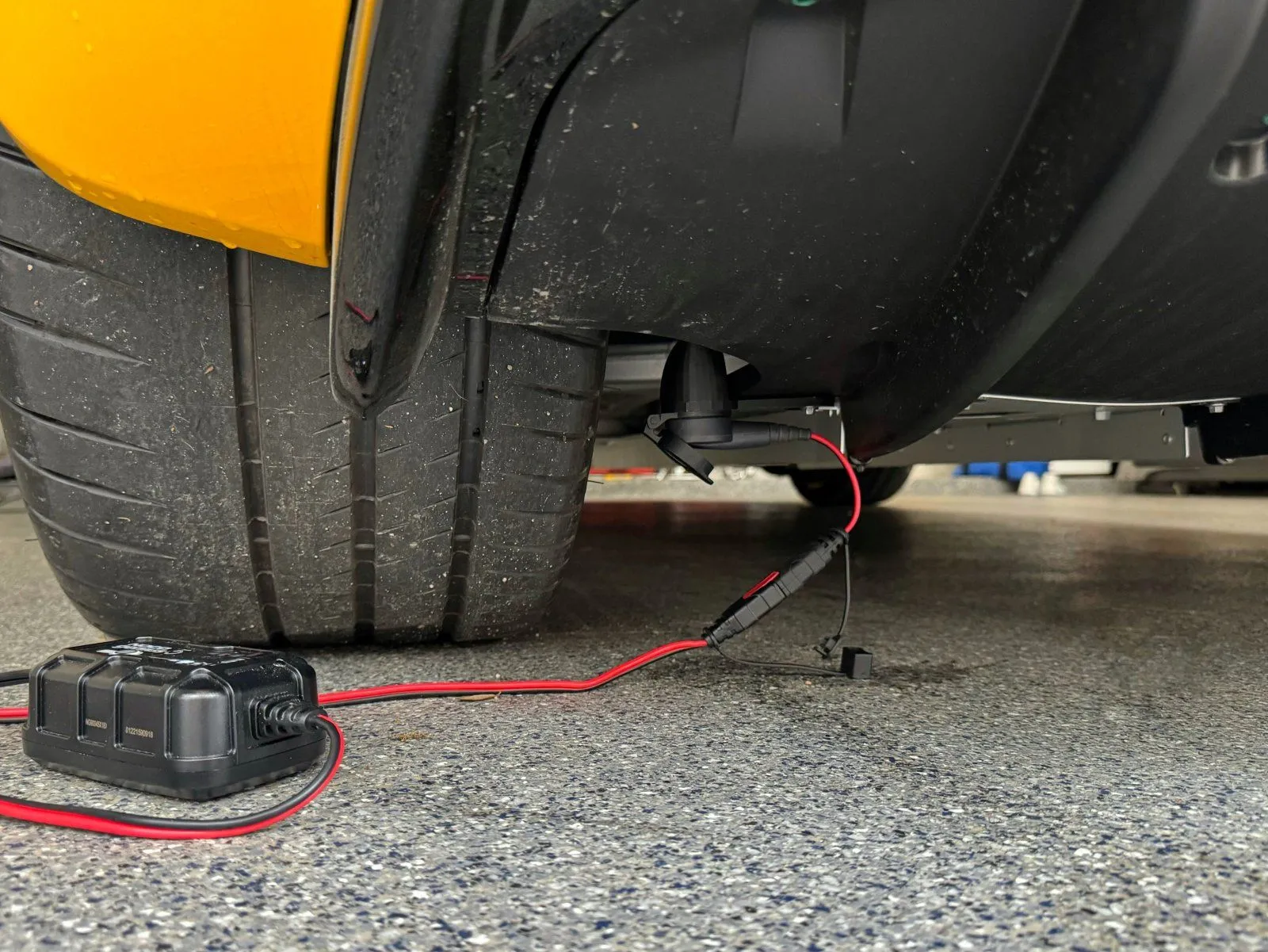

I didn’t want to be fumbling with the hatch every time so I got this.
I modified a bracket someone made for an Evora so that it could be attached using one of the diffuser mounting holes.

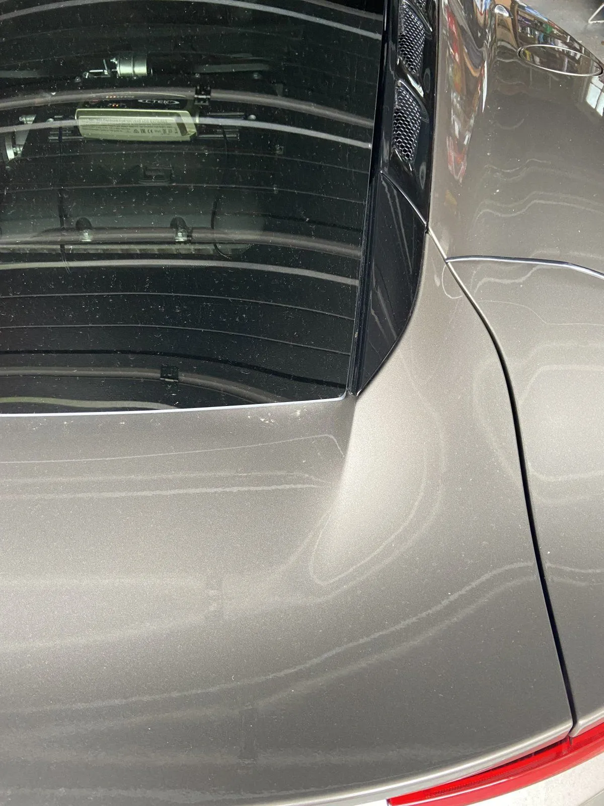

As a few others do, I position the mains cable to the CTEK at the side of the rear hatch and balance the charger on the supercharger cover. When the rear hatch is fully closed it still does not pinch the cable - you can even move the cable with the hatch closed.
I live in Houston. So hot and humid but when it rains it pours. I just made sure the wires are insulated properly and then added silicone for good measure.
Bracket could be modified as to protect better from the elements but for my use case this will do
There’s plenty of give in the boot (trunk) seal to simply close it on the (low voltage side) Ctek cable. Just run it to one side and avoid the latch. Car can then be fully locked and alarm set to comply with insurance requirements. I use a Ctek extension cable to run to an indoor location where the charger “lives” and connects to the mains electricity supply. I’ve been doing this for years with my Evora and now with my Emira….

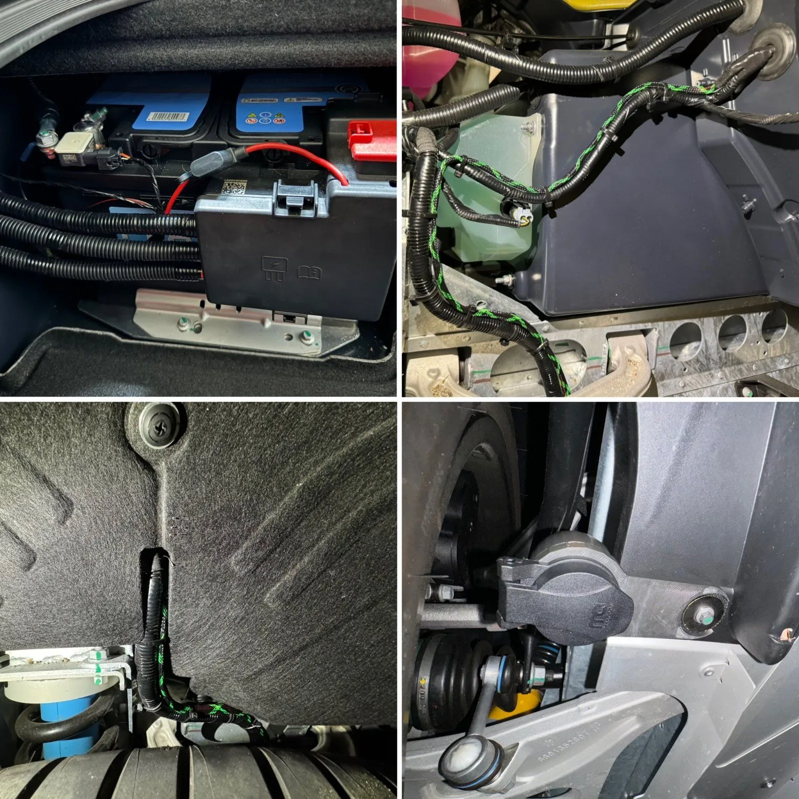

Catching up on this thread as I'm now to the point of attaching the leads to the battery for my Lotus tender. Some questions for you who have already been down this path:
1. Where did you connect the negative lead to? Directly to the battery? Or some alternative earth ground? If so, where? Most references seem to strongly encourage not connecting directly to the negative battery post and some forum posts suggest other not so nice things happening maybe as a result such as error messages that can only be cleared by the dealer.
2. When reconnecting the battery, did you have any issues (errors, alarm going off, etc?)
3. With the method of closing the hatch without pinching the wires described above, how do you get the hatch reopened (since it's not really closed, but "fake" closed)? Can anyone/you just pull open the hatch?
Thanks!

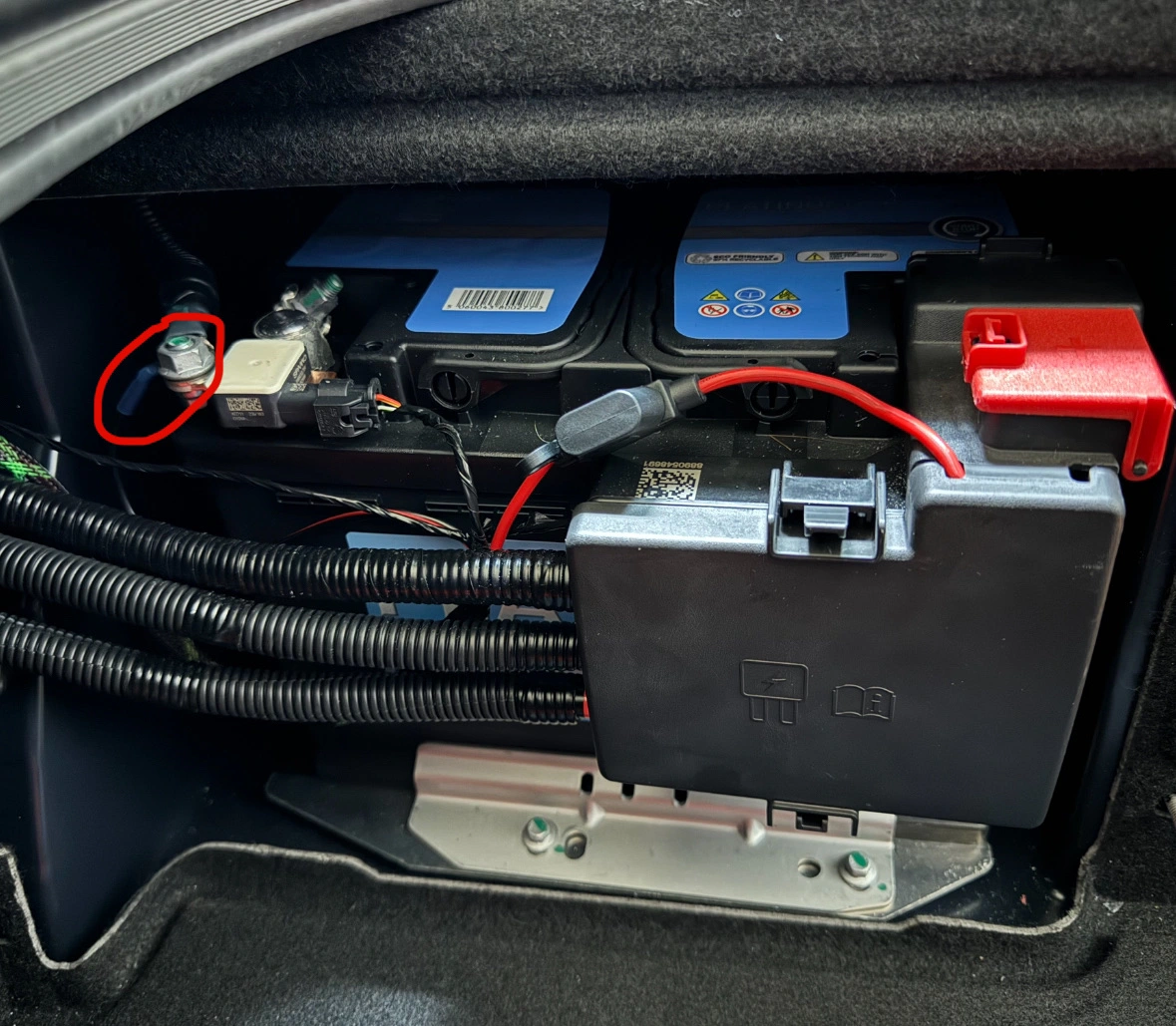

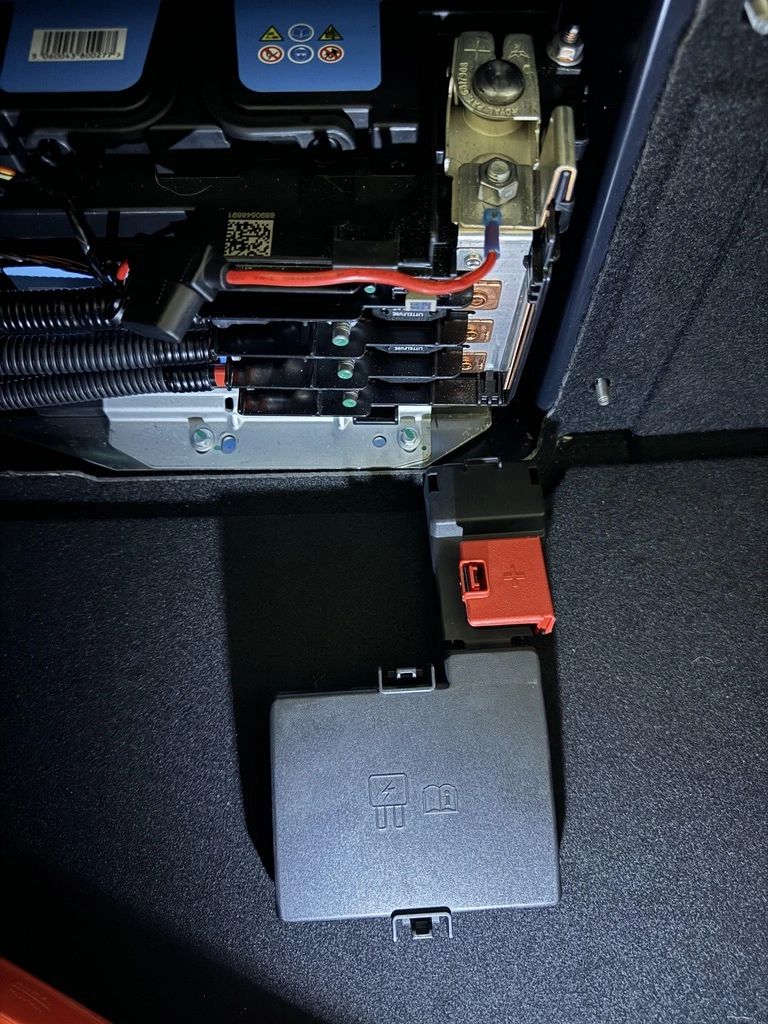

I didn't disconnect anything when installing the tender. Just connected the ground first, removed the inline fuse from the + lead, connected it to the positive terminal, then re-installed the fuse, no issues or codes. I've had it for over 3 months.
Thanks! So I can see that those two nuts you removed to install the lugs is not the same as the battery post collars, but is removing these nuts NOT disconnecting anything?
When I removed the nuts everything stayed in place and maintained contact, but yes with the nuts removed it is possible to disconnect things if you wanted or if you are wiggling stuff around.
The nut on the positive side is mostly just holding down the little metal bracket that you'd use to connect an alligator clamp to.
Thanks much! It is done, easy peasy. As usual, I was overthinking this. And yes, I tried as best as I could to not disturb things on the negative post side when I removed the nut. The leads are now attached, everything is buttoned back up, and I've restarted the car, no error codes or other anomalies, so first test done. In a abundance of caution, I'll wait at least another 30 minutes before I attach the tender and plug it in. Thanks for your help @silent cilantro!

I connected my negative tender lead to the lower mounting bracket bolt into the body. Have a good continuity there as well. Have seen it connected to the negative terminal too and should be ok that way with the lows amps current from the battery tender. Either way is fine.
