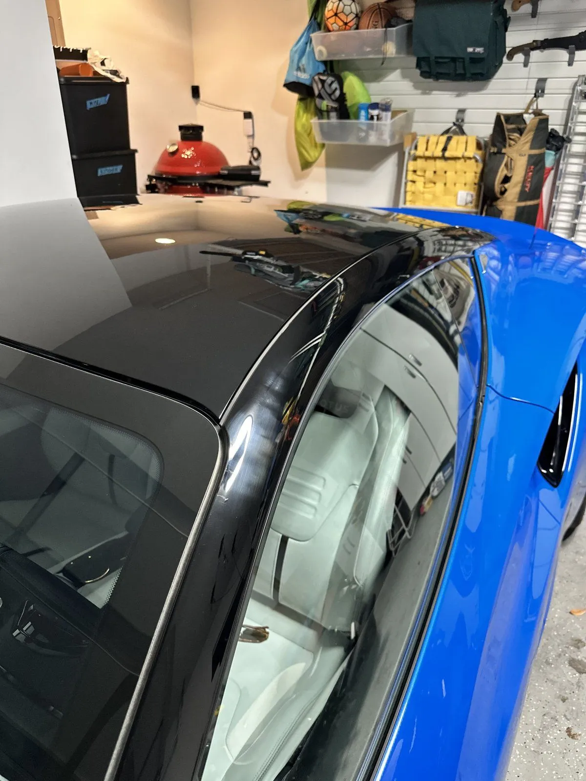

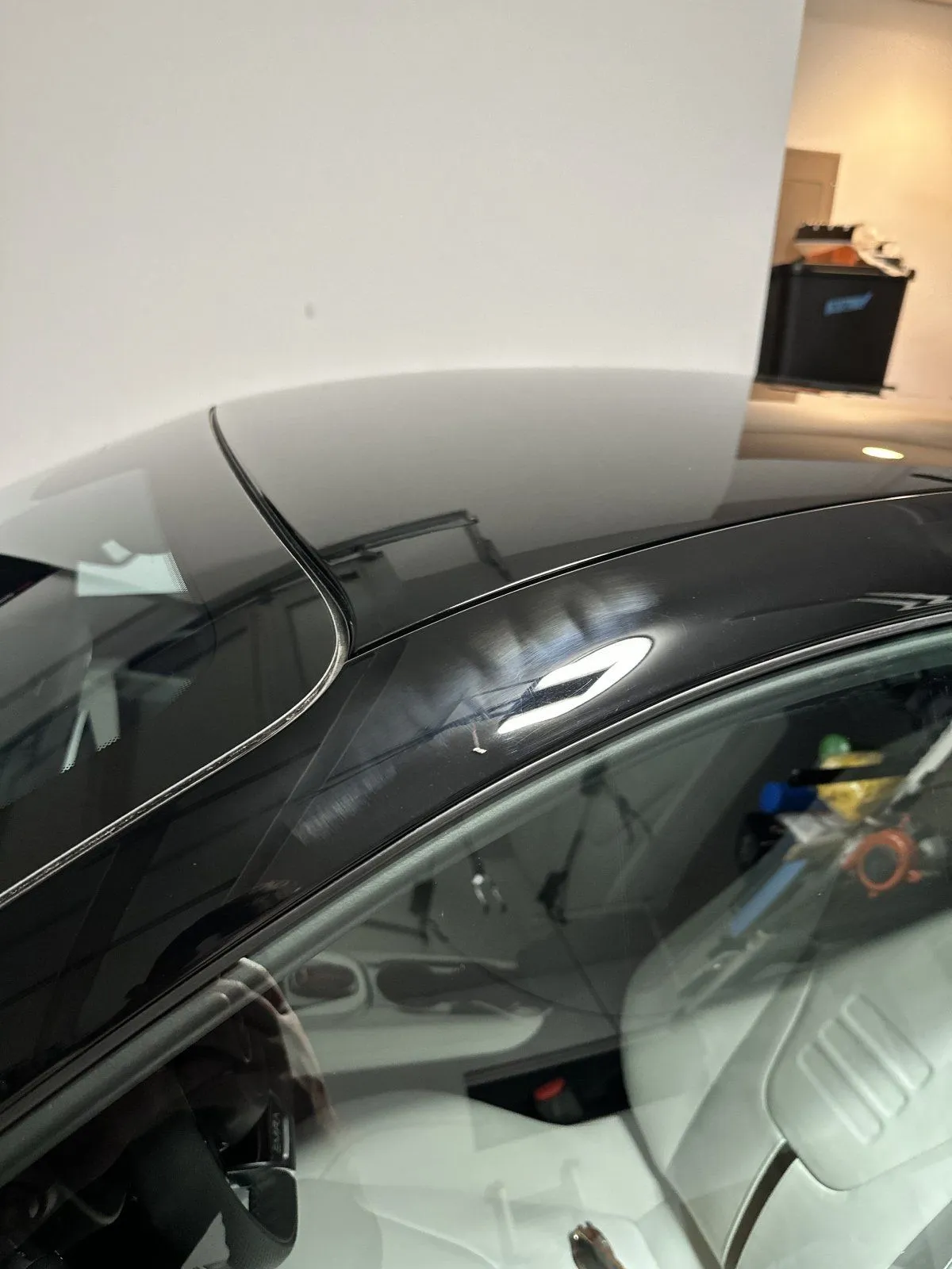

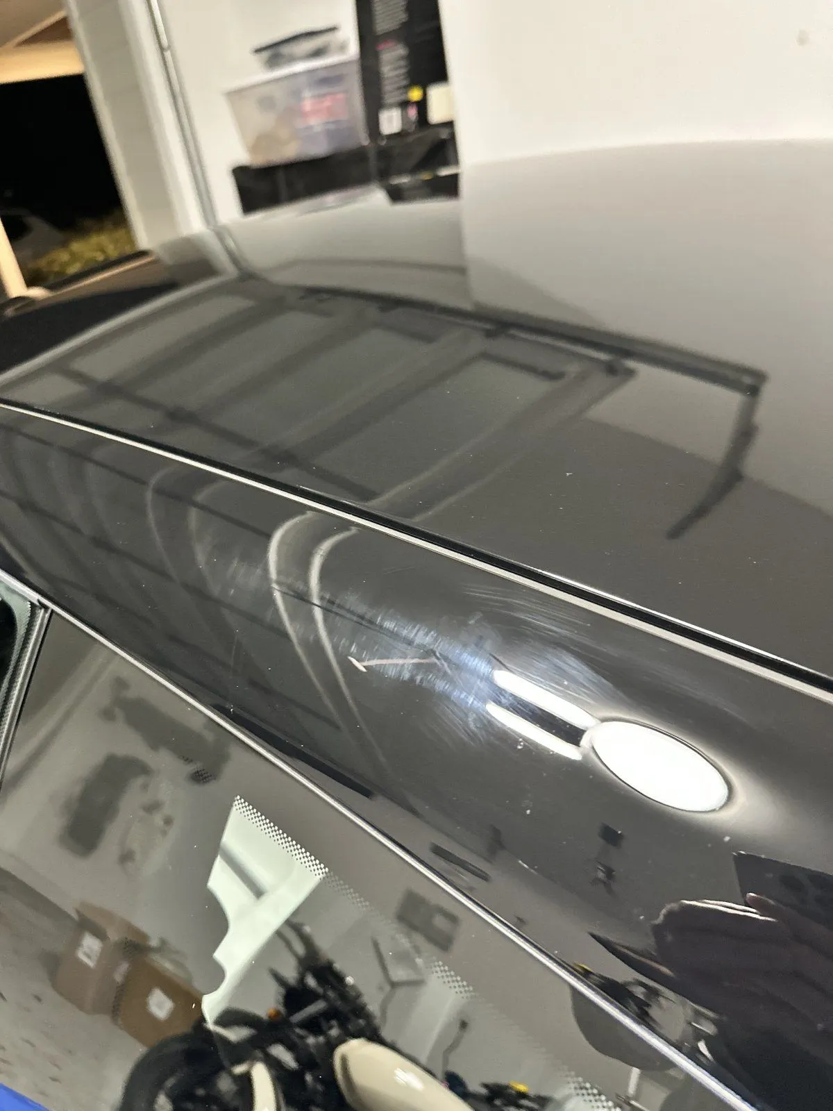

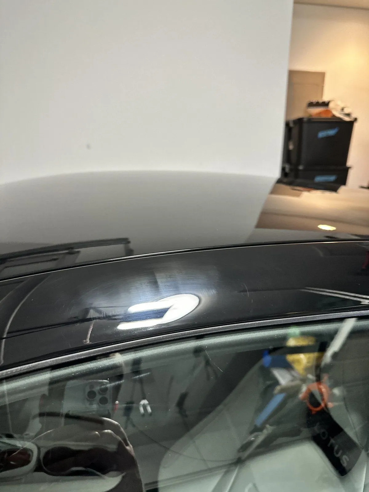

Hey I recently got my car detailed and it looks fantastic, but I’m worried about a few marks I found on the upper black pack. I reached out to them to see what they can do to fix it, but I’m concerned that the marks may be permanent. Does anyone have experience with this?

Oh my... That looks... Terrible! ☹️
Is it just on the A pillars and outer 'rails' of the black pack (not on the main roof section)? Seems a bit strange if so.
Were there definitely no swirls/scratches before you had it detailed? Going to be difficult to prove it was them unless you have some sort of photographic proof, I suppose though, but worth chasing them to see what they say.
Swirls/scratches like that are going to need some (very careful and skilled) paint correction to get rid of (and not sure I would trust the people who put them there to get rid of them IMHO).

Not permanent, that just needs polishing. And likely the rest of the car does too if the top looks like that.
Whoever did this "detail" should not be in the business if they left your car looking like that AFTER the work.
I would seek out a genuine pro and get an eval for single stage paint correction. Your black pack will go back to looking like a piano.

I would say don’t worry about it. As long as you can’t catch your fingernail on the scratches, they will disappear with a paint correction. Even deeper scratches can be greatly reduced with a proper paint correction. My advice would be to paint correct then ceramic coat or PPF those piano black areas that are more susceptible to scratches. That’s what I plan to do to my Seneca blue Emira that also has the upper black pack like yours. Good luck and let us know how it turns out.

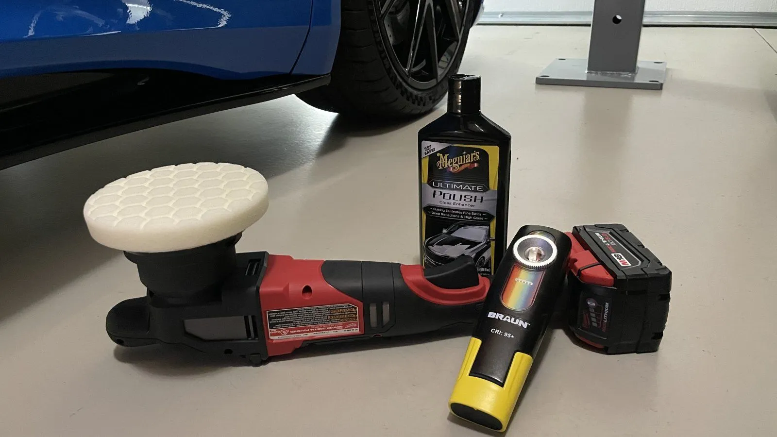

My car also had minor scratches and swirls all over when delivered, including wheels. I have been fixing it all slowly with very good results.
The paint overall is soft. Which means it can scratch and swirl easily, but you can also paint correct it easily.
I found success using this combo:
  • Milwaukee cordless DA (or any other dual action polisher)
  • White foam pad (orange pad was too aggressive and required me to go over it with the white pad)
  • Meguiars Ultimate Polish
I also used a specialty paint inspection light from Harbor Freight to verify results. https://www.harborfreight.com/455-l...l-led-color-match-inspection-light-56354.html

Hi I'm a car detailer from north West England . You need a refund , that's awfull . I also own a yellow emira with black pack .you will find no matter how careful with washing and drying , you will get very minor swirls , same on all similar black areas on cars , like the areas between front and rear glass , they can be made flawless but even wiping with a new microfibre can put in micro scratches . Even after ceramic coating . You actually need to get the rest of your paintwork checked , if that's how the roof is , the paint can't be right either.

Update: I spoke with the guy and he was really bummed that it happened. The rest of the car was flawless. He drive to me to fix it and it looks brand new. He was a mobile Detailer and it got dark when he finished up and neither of us saw it. I noticed when it was light out. It definitely wasn’t that way prior to him working on it. I would have noticed right away because that pillar is the first thing you see when you approach the car.
Thanks for the help everyone! It scared me but is flawless now.
