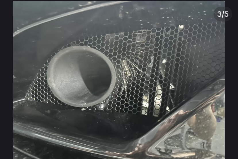

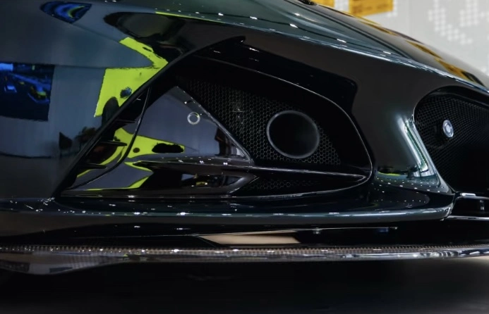

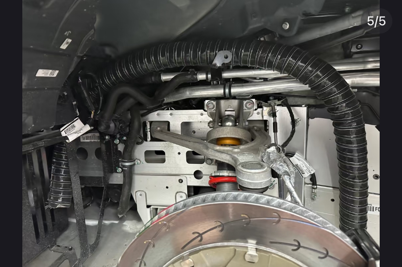

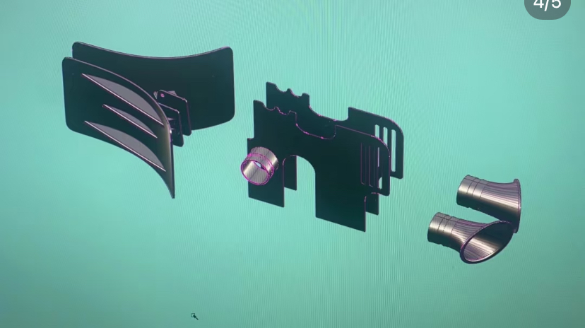

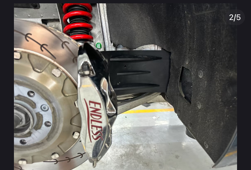

yep, planning to change to motul rbf660 but considering air temps in sydney AU can reach 40C, cooling ducts should help as well.
