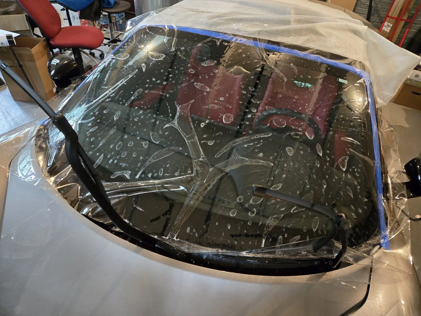

After a bunch of research, I settled on Bray Windshield Skin to try. There are some other windshield protection products on the market, they seem to have mixed reviews. I couldn't really find much independent info on the Bray Windshield Skin but saw a few different PPF installers use it in their videos, and @GRP recommended it so I thought I'd give it a try.
There is no model specific kit for the Emira, so I bought their generic kit which needs to be trimmed to size. The kit is $250 but shipping was $50, so the total was about $300 plus tax.
Installation is pretty straight forward. Anyone who has done DIY PPF or vinyl wrap can do this. It's relatively simple. Just follow their instructions to scrub and scrape the windshield to make sure it is perfectly clean. The only part that's a two person job is flipping the film onto the windshield. Here it is after the flip:
If you have done the windshield cleaning well, then there is no need to re-lift the film to clean out dirt. Just squeegee out the excess slip solution and make sure to chase out all water/air bubbles. The windshield has a slight bow to it, so some fingers/wrinkles will develop at the edges where there is excess film. I used a heat gun to soften/shrink the film in these areas and they laid down well after that. The kit includes a small utility knife for trimming the film, but I had a vinyl trimming knife that's lower profile and better quality and I used that instead. I don't have a photo of the film installed because it's invisible from the outside. I took a photo and it looks like nothing is there.
Tip: If you have some time, don't trim the film until the film has had a day or so to dry and develop tack against the glass. This makes trimming a lot easier. Otherwise, the drag of the knife will cause the film to lift and make it very difficult to get a clean trim. When trimming, angle the knife towards the windshield slightly to get a close neat trim.
I drove the car 2 days after installing the film. Initial reaction is pretty positive:

I've been driving around with this thing and it's still wavy after two and half months. It will definitely bother some people. As you can see from the photo, it lays mostly flat on its own, so I didn't have to any stretching or forcing things into place. So I believe the waviness is just a natural character of the film.
Overall, though I am living with it, because it does protect the windshield based on at least one sizable rock that has already hit it. That one spot has not healed on its own, I guess because it did cut all the way through the film.
The film is super hydrophobic. Even at relatively low driving speeds, water just blow right off and I never use the wipers except by accident when I bump into the stalk. All the edges have remained flat and well bonded so no lifting issues.
