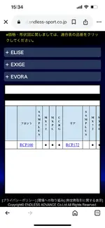

The list on the ENDLESS web page shows the following pads for these calipers. Are they the ones you tried but didn't fit?
F: ENDLESS RCP098
R: ENDLESS RCP100
Thanks for the information!

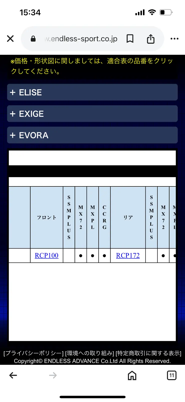

I was looking at the same post, and think the emira break should be the same as Evora, so I went to endless website and bought RCP 100 for the front but the size is different, maybe I should try RCP098

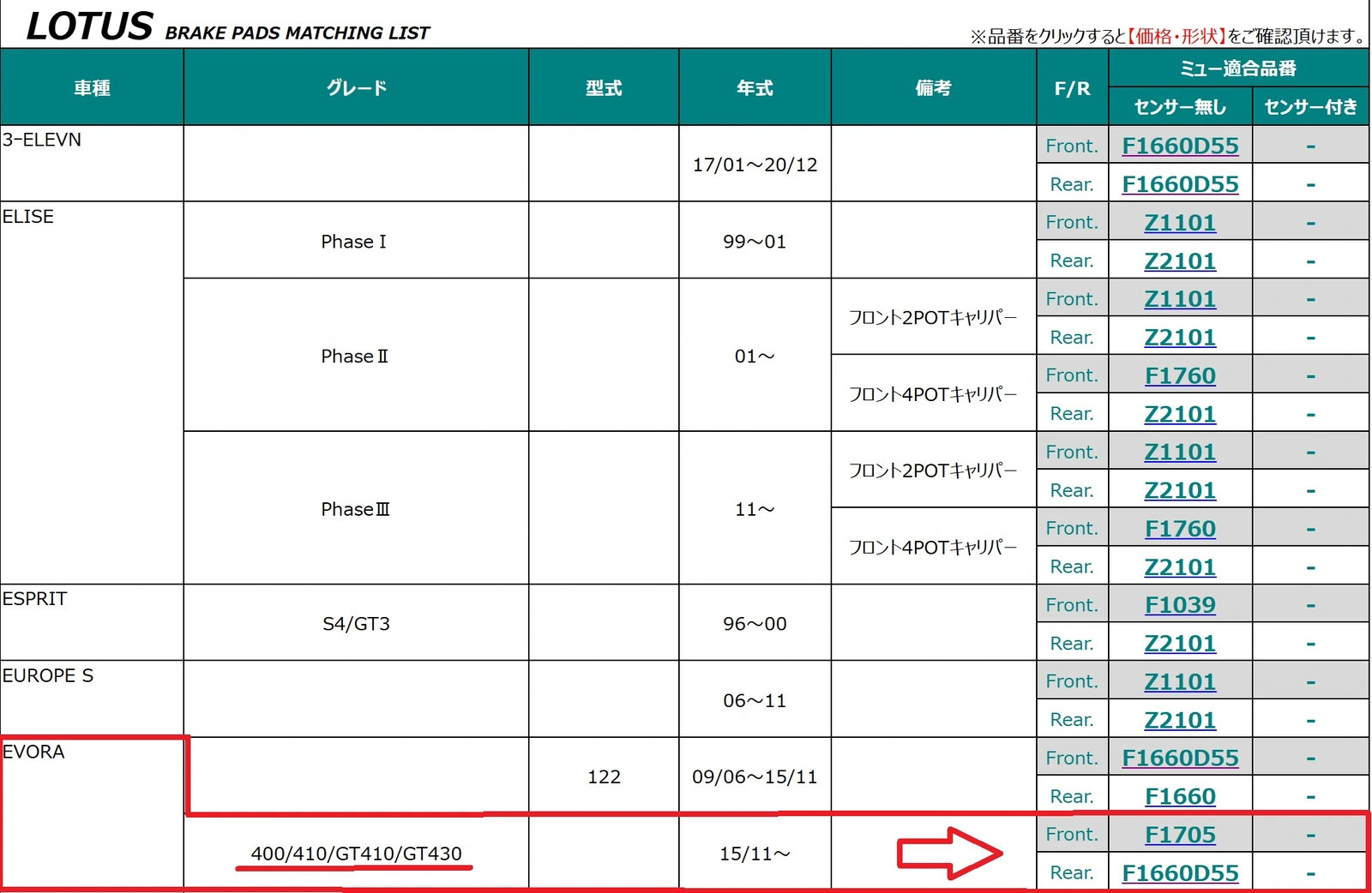

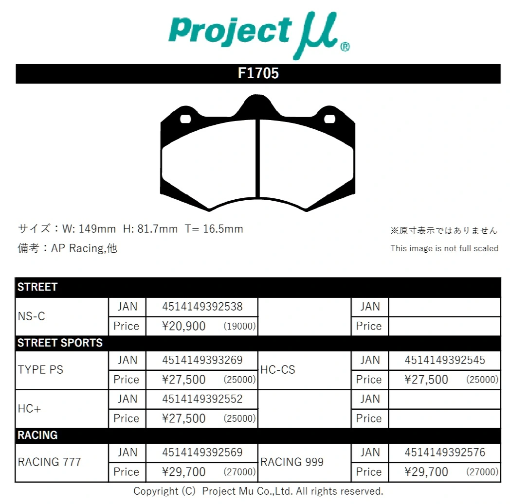

Brake pads that are compatible with EMIRA have the same shape as the EVORA (400/410/GT410/GT430) manufactured after November 2015.
They must be for the EVORA "400/410/GT410/GT430".

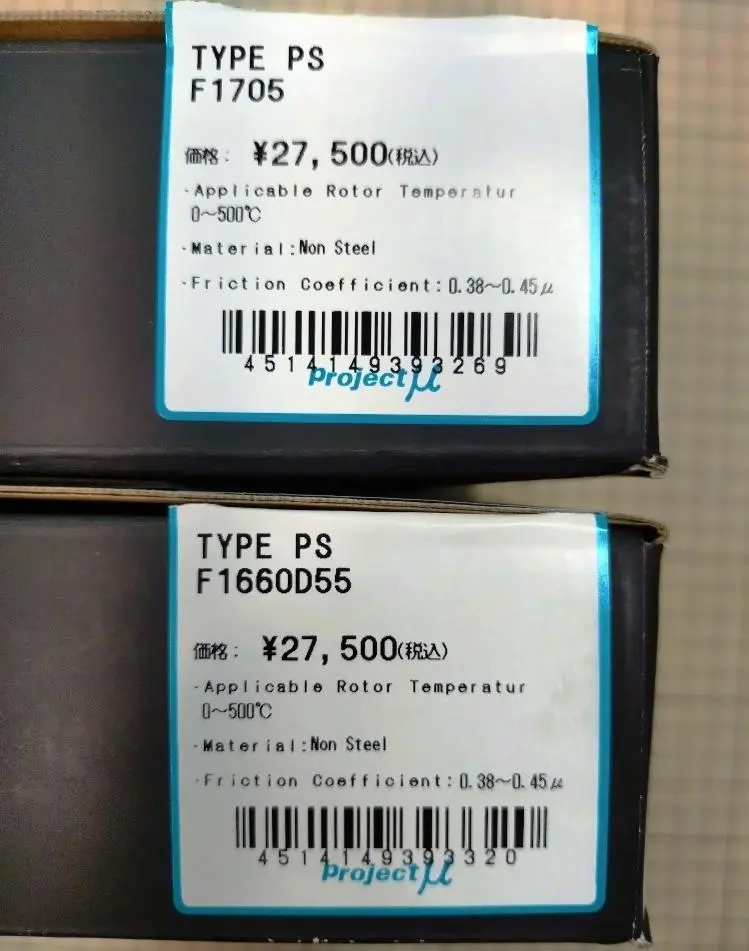

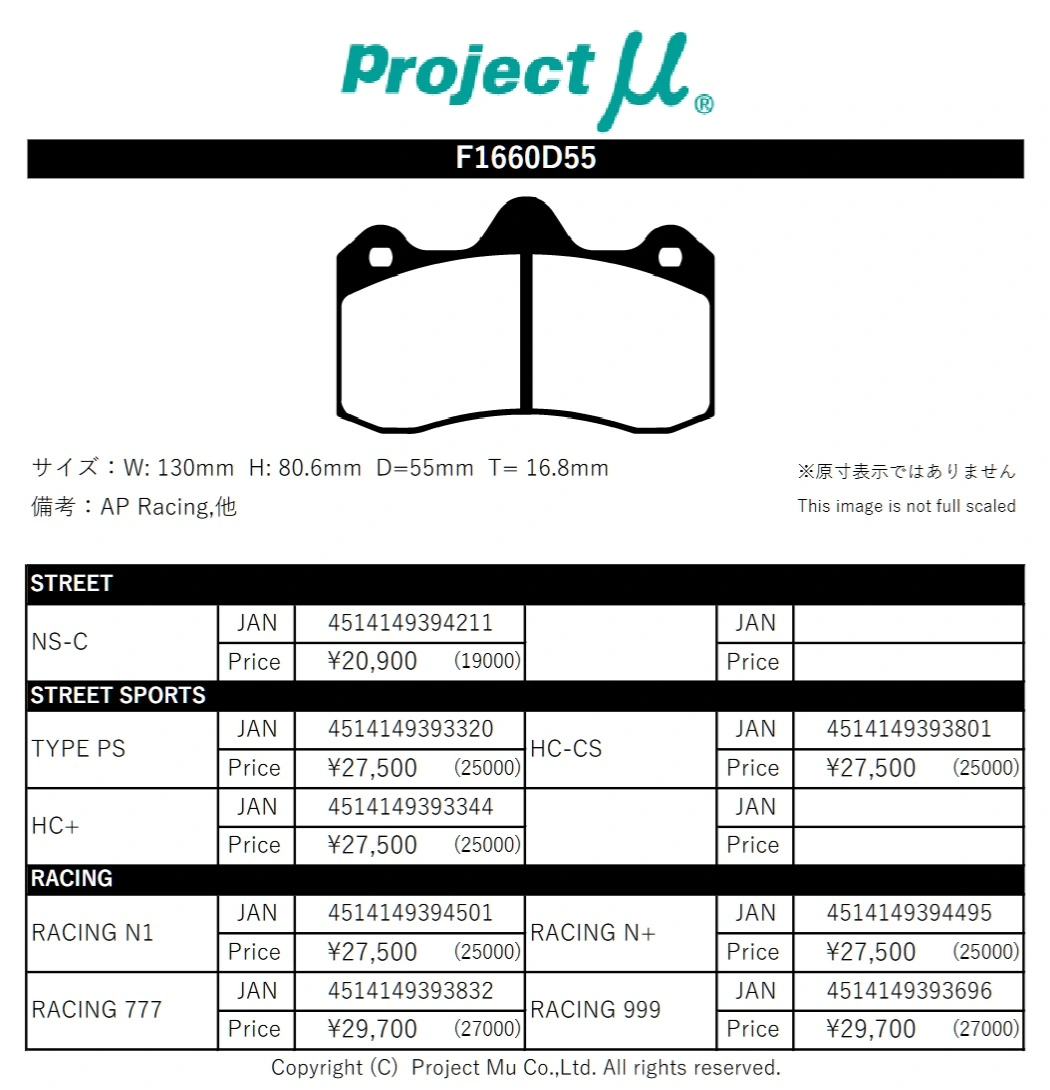

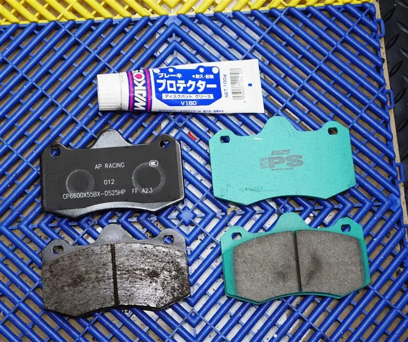

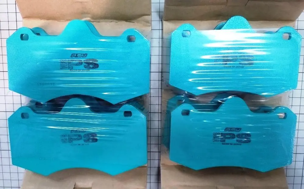

I purchased "Project μ" low-dust brake pads for the EVORA and replaced them myself.
The brake pads were installed without any problems at all.
