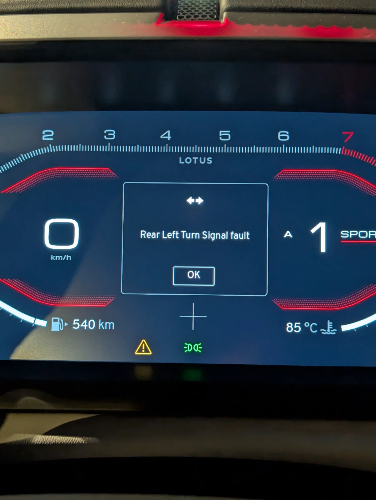

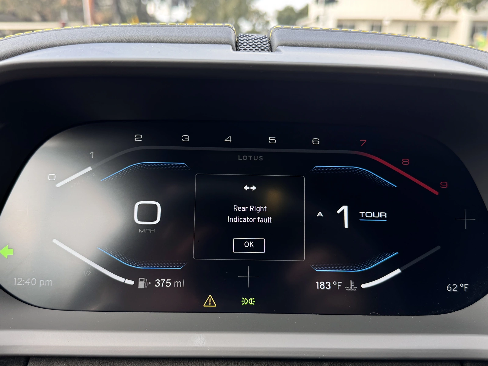

As directed by the owner I started the car several days later and the telematics alarm went off again then shut off, so I drove the car a couple of miles and got a brief fault warning that the left rear blinker had failed. Not long after that another warning about the right blinker failing came up then dissapeared. Over the next three times driving the car the telematics warning came up then disappeared the same with a blinker failure warning. On one of those trips the telematics light stayed on for the whole trip.
