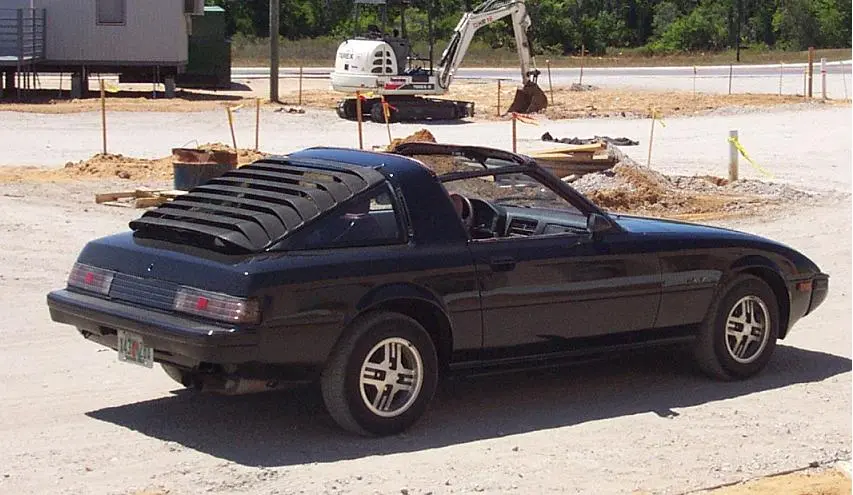

Yeah, with enough money...I converted my 85 Rx7 into a Targa. Once thing you would have to ensure is you are not destroying the structural integrity of the car. I would be interested in stress tests with G's and how much the roof helps reduce that stress. If you remove that, the stress will be transferred to other parts and potentially causing damage.

I see, your car looks amazing! How much money are we talking, do you think?
