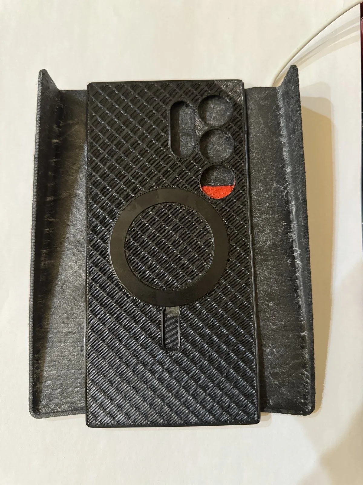

The charging locations are going to be different aren't they?
I designed it around iPhones so it will fit all the iPhone sizes. Based on measurements, the Pixel 8 should work as well as its charging coil lines up with the puck and camera cutouts.
I am not sure if the Galaxy Ultra phones will even fit in the little cubby as they are longer than the Max model iPhones. I just need to get some measurements to verify
Locations? Not sure what you mean. Position in the plate for the wireless charger? It's dead center on almost all phones.
yup correct, the issue with the ultra phones is that if their coil doesn't line up with the puck when the phone is pushed all the way back in the cubby then I would need to lower the puck location in the tray. Not an issue, I just need to find some diagrams and measure.

I did buy a magsafe case for my phone. The phone length extends past the cubby, but plenty of room for height. Could a wedge shaped insert help create a better contact with the charger and phone? Hope that makes sense.
Dimensions
163.4 x 78.1 x 8.9 mm
6.43 x 3.07 x 0.35 in

Alright @Haffway, I found a model of a MagSafe case for the Galaxy S23/24 Ultra and printed it to test.
I need to make a slight modification to the camera stack cutout to fit the S24 but it will fit. Phone will stick out a little less than it does in the OEM tray. (y)
