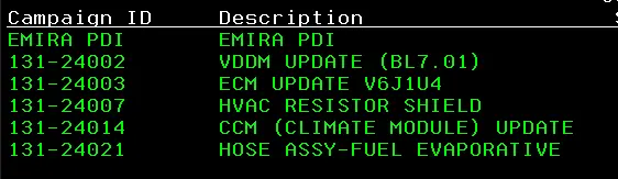

This is just speculation, but I think the TSB ID could be "25143" or 131-25143?
Do you have a V6 or I4?
Example of other TSBs/Recalls:
