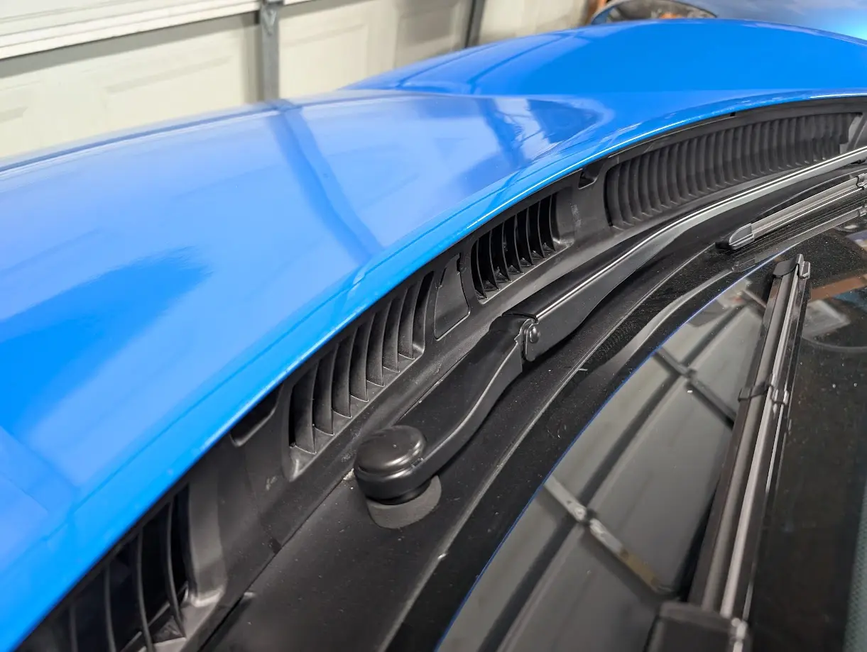

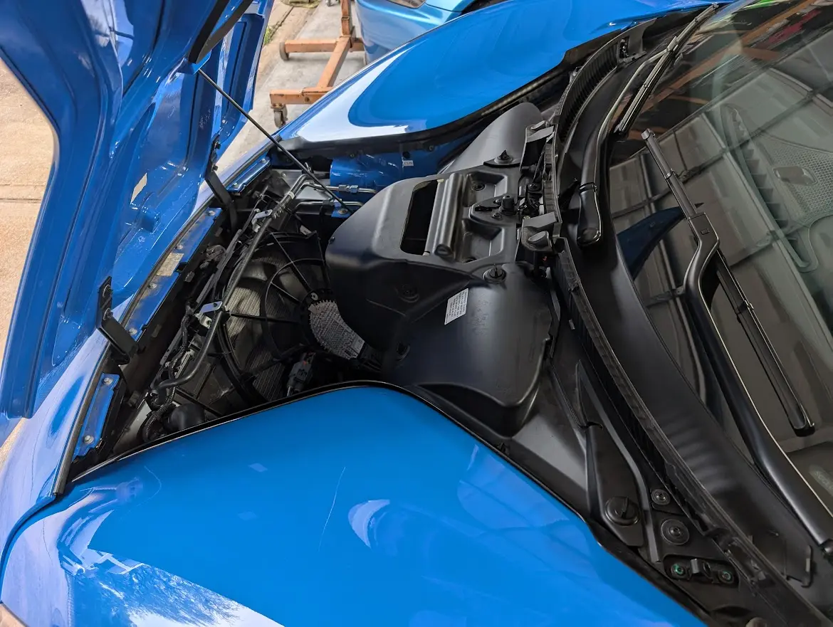

Open front service access cover. Pop the three plastic covers and unfasten the T-30 torx bolt with the provided tool in the tool kit or T-30 Torx bit.
Remove the plastic cover on the driver side (LHD) by twisting the plastic fasteners 90 degrees.

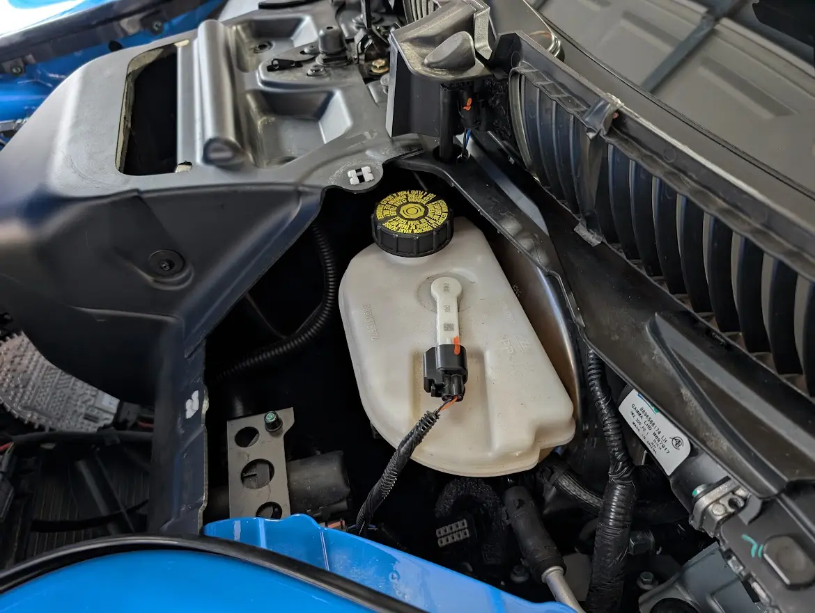

Remove cover to explose the brake/clutch master cylinder reservoir (they're shared).

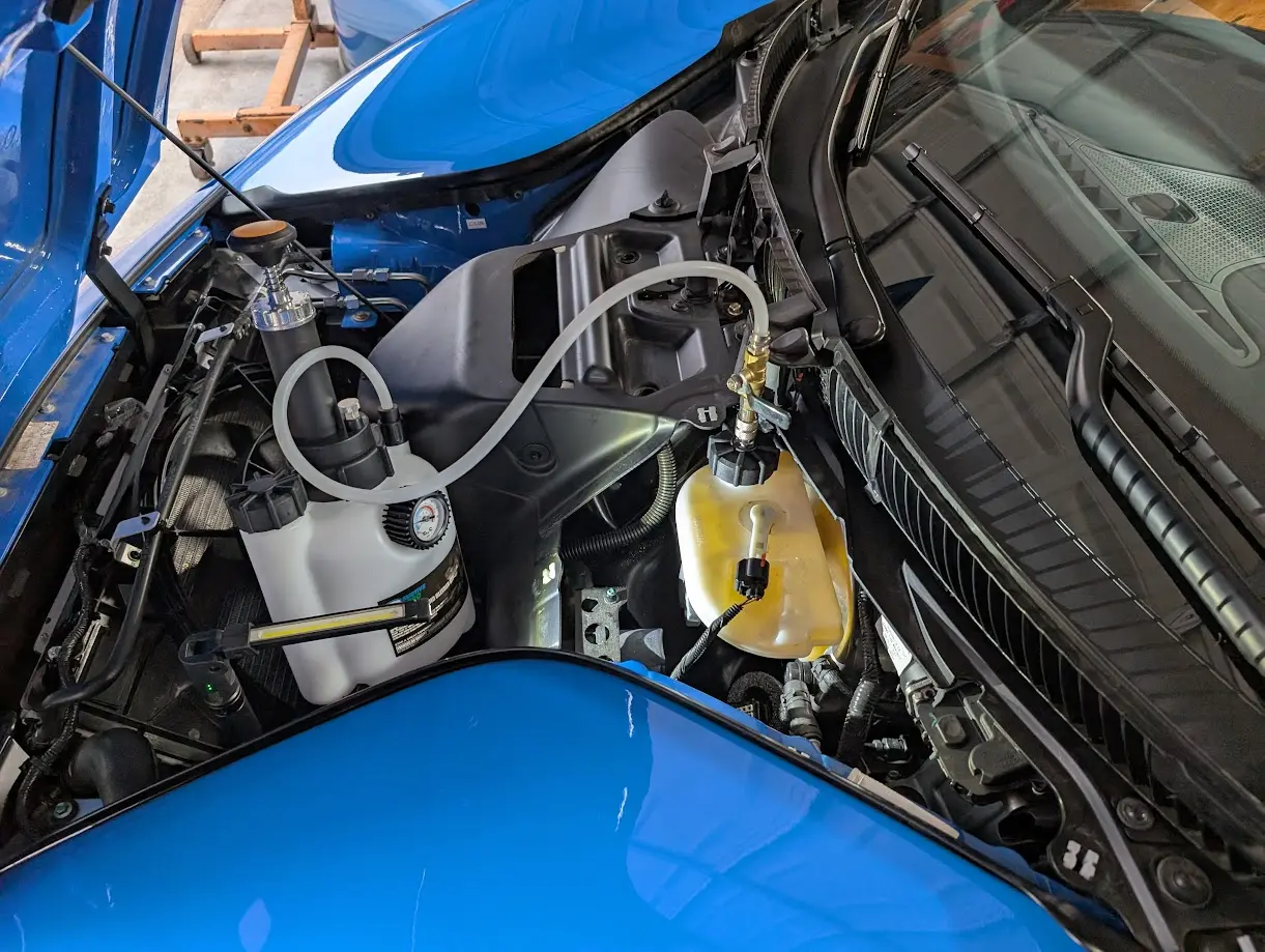

I used pressure bleeding tools to perform this job since it is much easier and faster, with better results.
This particular kit comes with the "European 45mm" adapter that works on our master cylinder reservoir.
Install the bleeder adapter. Pump the pump up to 10-15 PSI. Connect the pump to the adapter via the QD and slowly open the valve to check for leaks.
If no leaks are present, close the valve, slowly remove the QD from the adapter. Depressurize the bleeder pump and fill up the brake bleeder with your favorite DOT 4 fluid. Pump the pump back up to 10-15PSI.

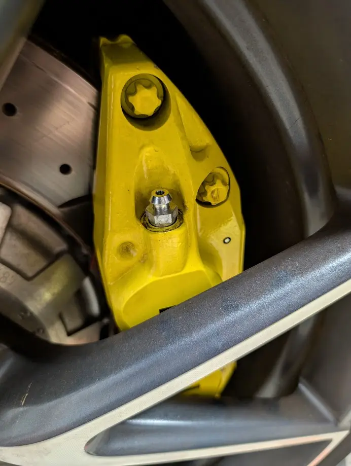

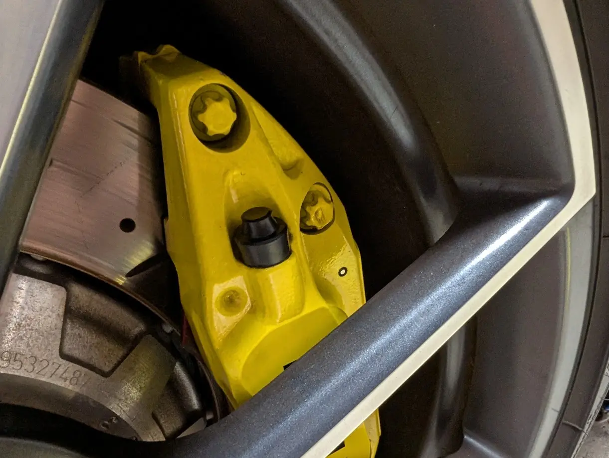

Pop off the rubber protective covers on the bleeder screws. There are 2 bleeder valves per caliper, one on each side.
Attach your hose to the caliper bleeder screws. They are 11mm hex.

Once finished, replace protective cover. Job complete.
