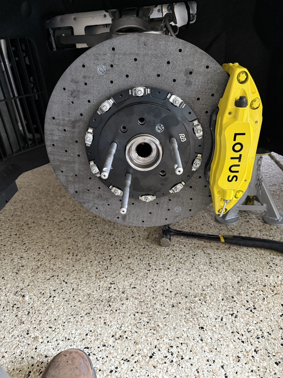

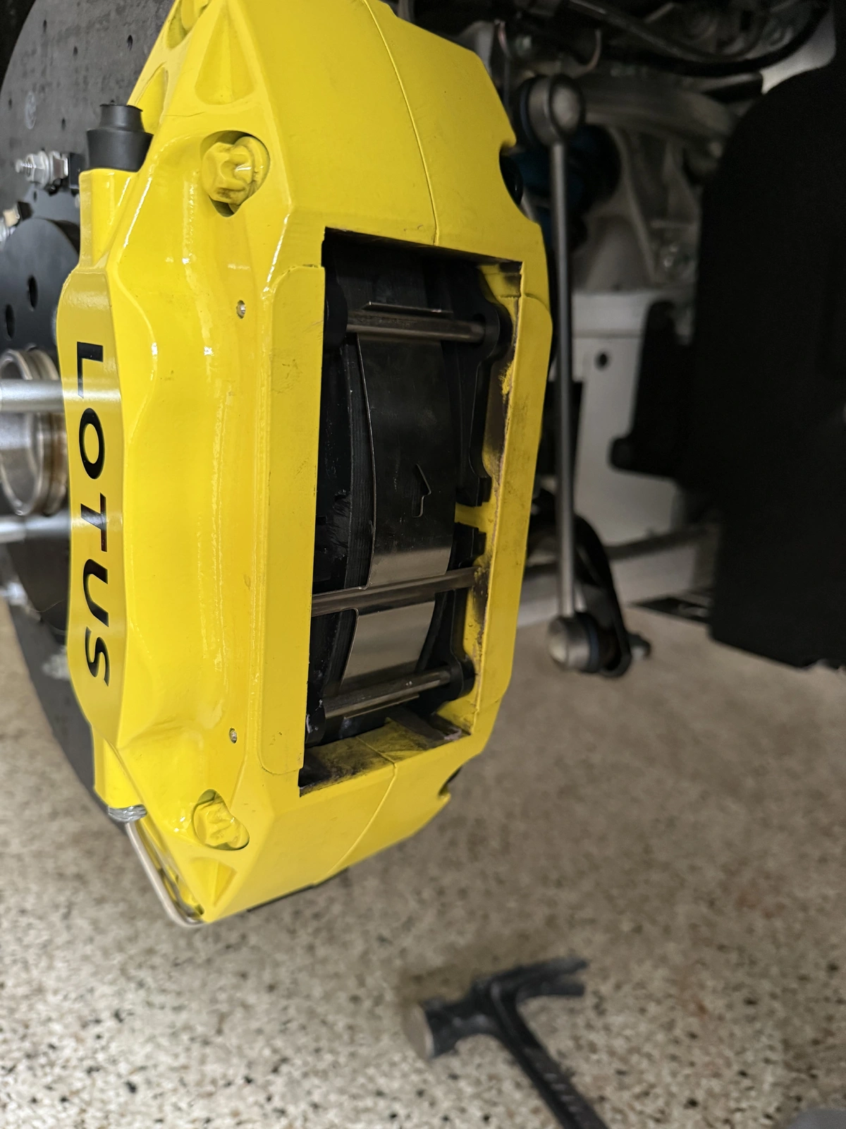

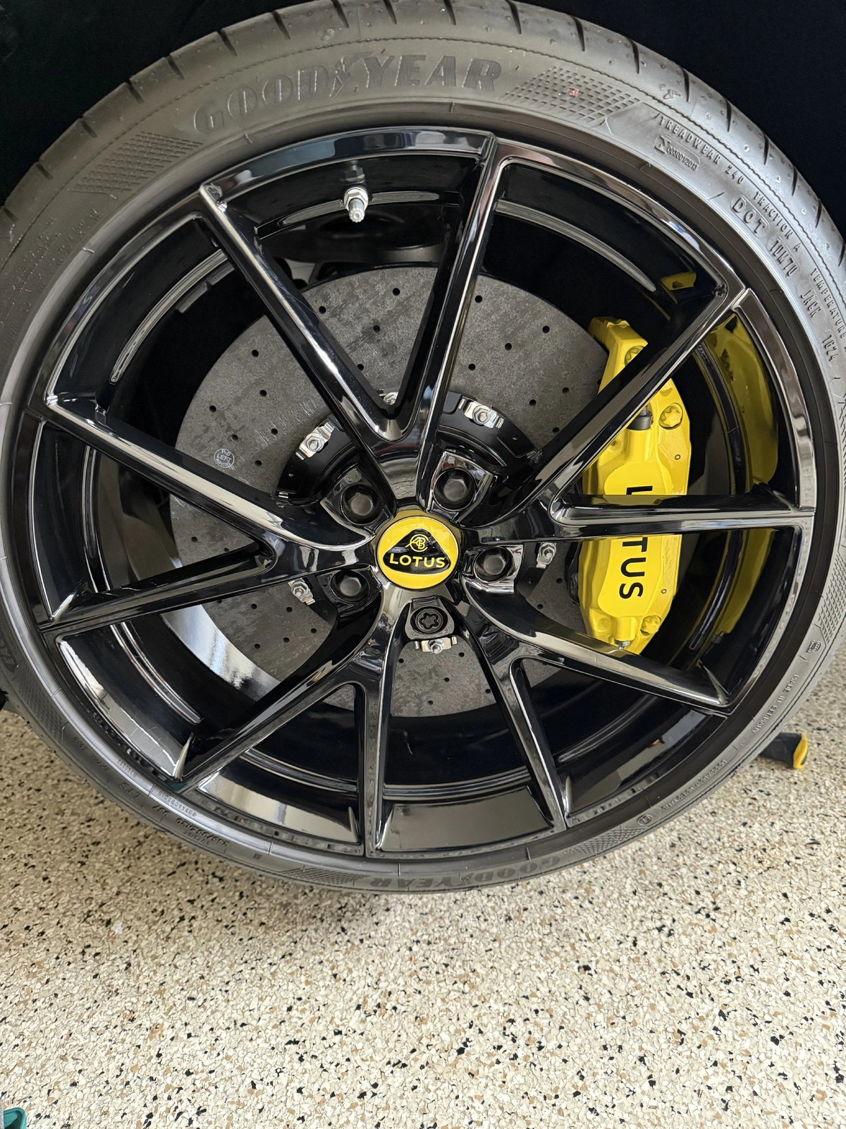

Aren’t these ceramic rotors thousands of dollars?? I wouldn’t be happy with that response eitherA quick update. The team at RB confirmed the issue due (hole was made to fit Porsche 5x112 vs Emira 5x114.3). They suggested for me to enlarge the hole with a Dremel but not to replace the hats. I'm not happy with that suggestion so I'm curious to hear from others who purchased the setup.
I'll just ignore this and use the alignment pins to get the wheel on/off. Install scheduled to continue this weekend.
