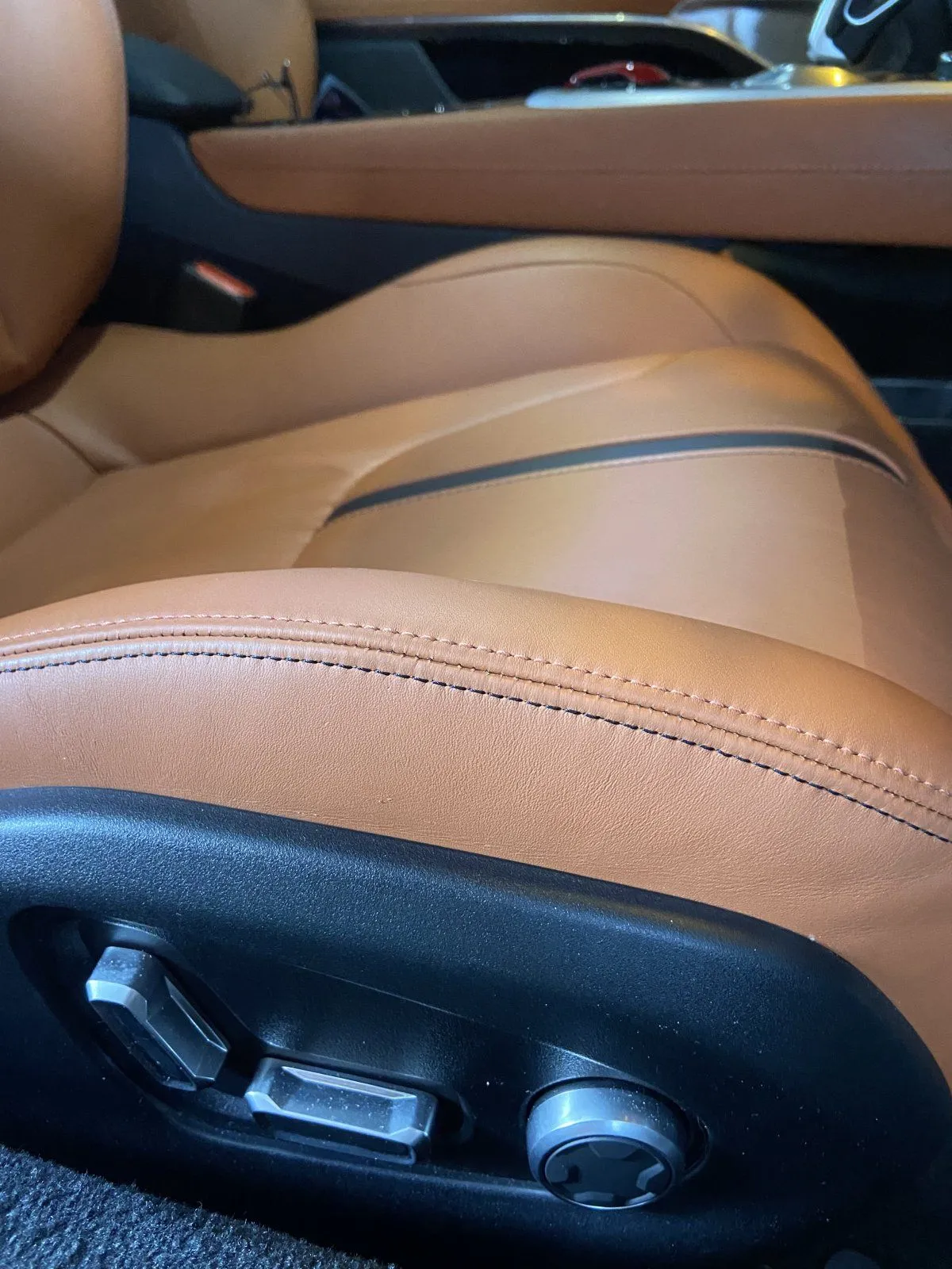

My car has just 200 miles + Just discovered today this leather issue . I’m not fat ! But something like this happened to my side probably from the plastic on the side . Something like this should be covered my warranty ?

Wondering what dealership going to say about it . I got ocd so I know I can’t live with it

I plan to address this issue with my dealership on Monday. Yesterday, while seated in my car, I noticed that the 'leather' material isn't even touching the plastic. The wrinkles in the material seem to be causing it to deteriorate

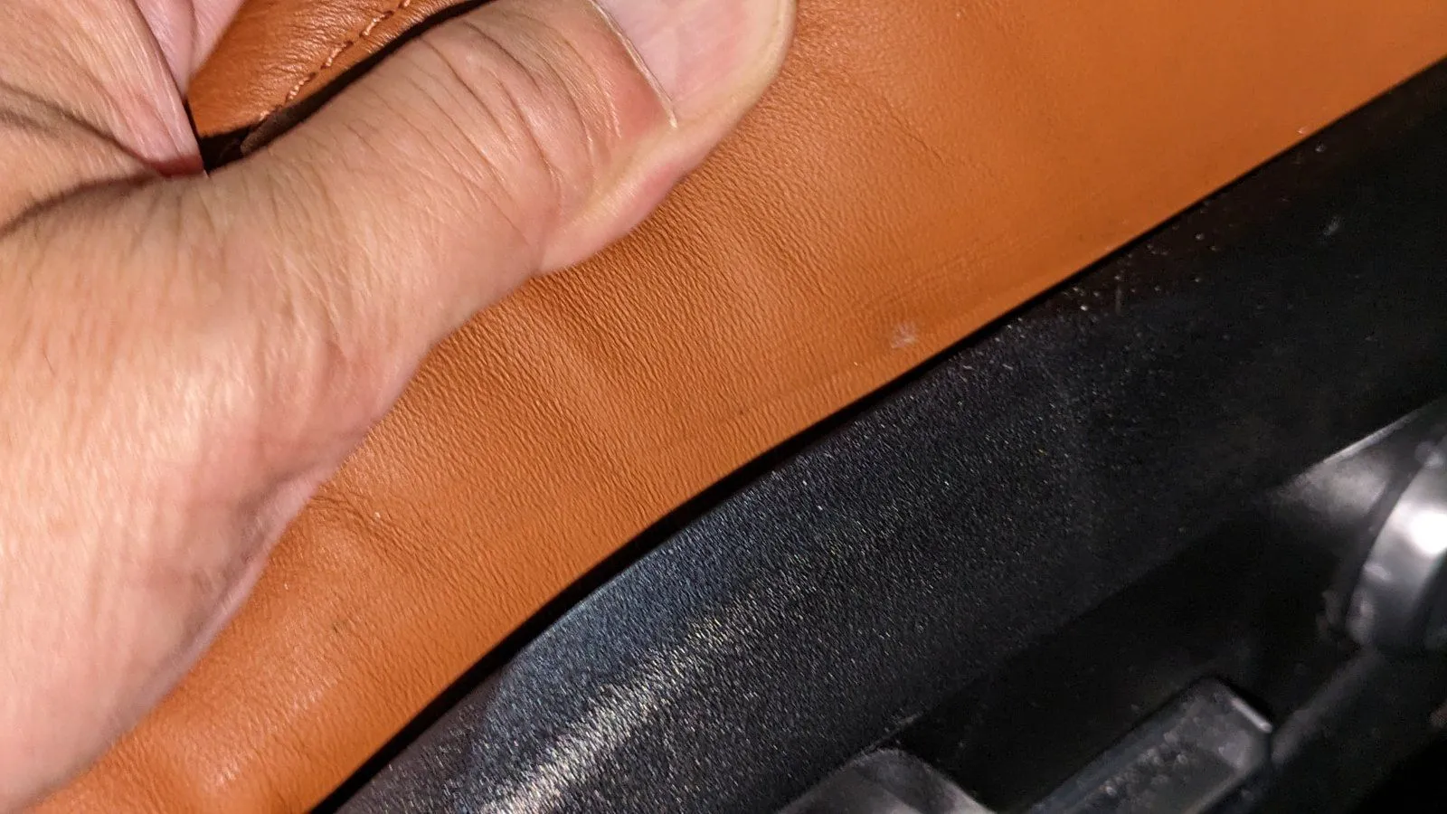

Our car has 600 miles and noticed the same thing on both seats. Neither my wife or I are close to overweight. It appears that the black plastic has a sharp edge where it faces the leather. While the plastic does not contact the leather while you are sitting square on the seat, when the lower bolster is pushed down while getting in and out of the seat (unavoidable) the leather is pushed into the plastic, chaffing it. This is our sixth Lotus and none of the prior ones ( or any other car) have issues like this. Another of the many trips to the dealer over warranty issues is in our future. Most of our mileage has been made going to the dealer or body shop to fix crap like this

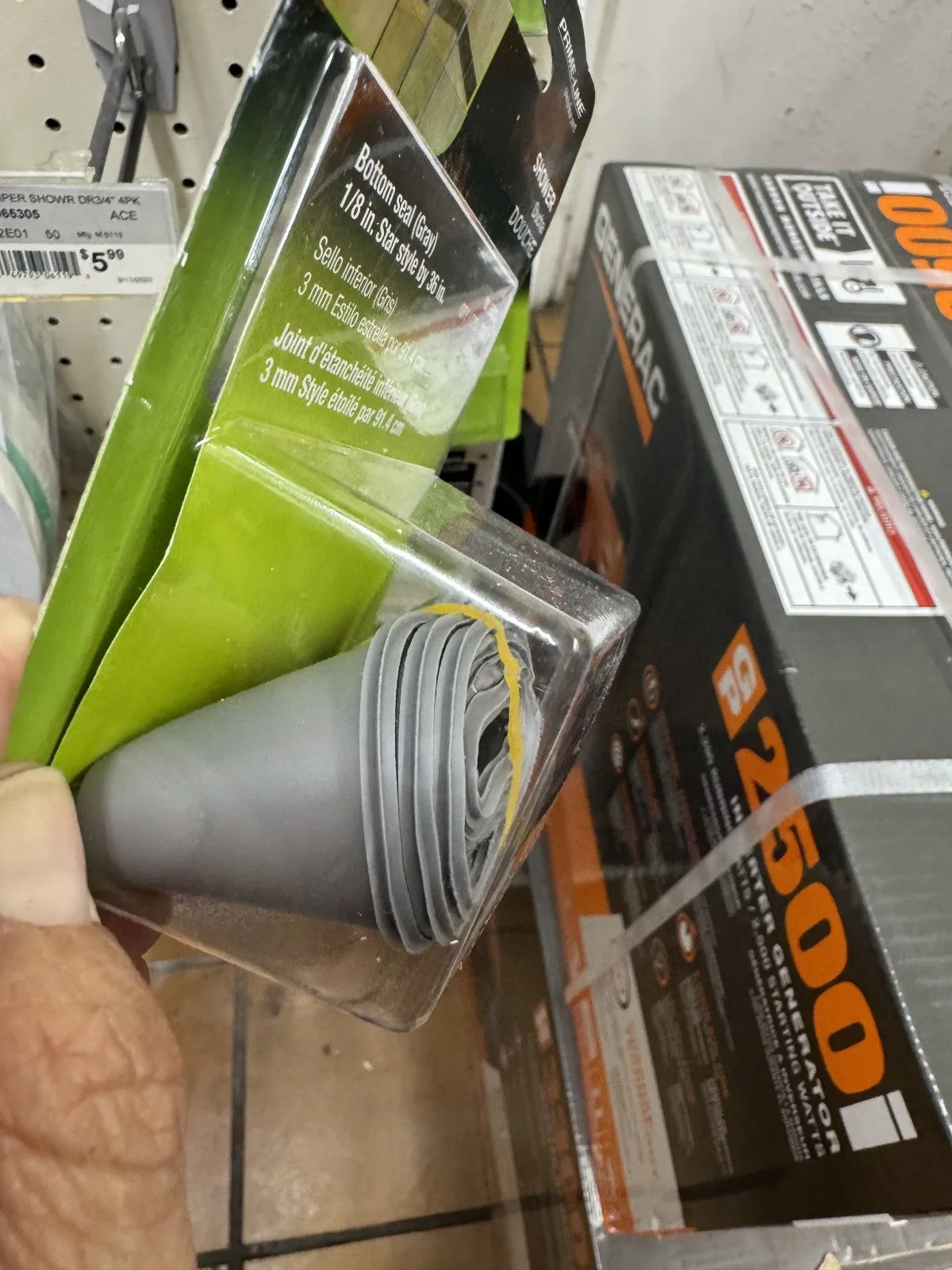

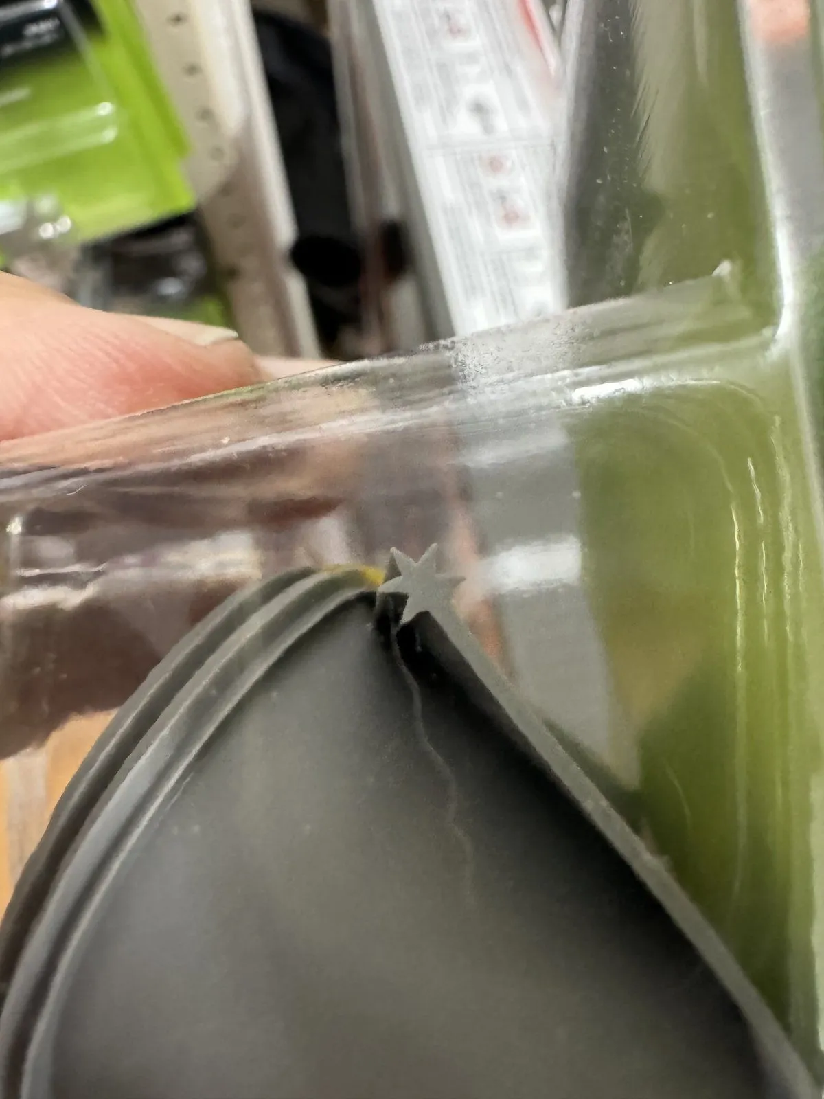

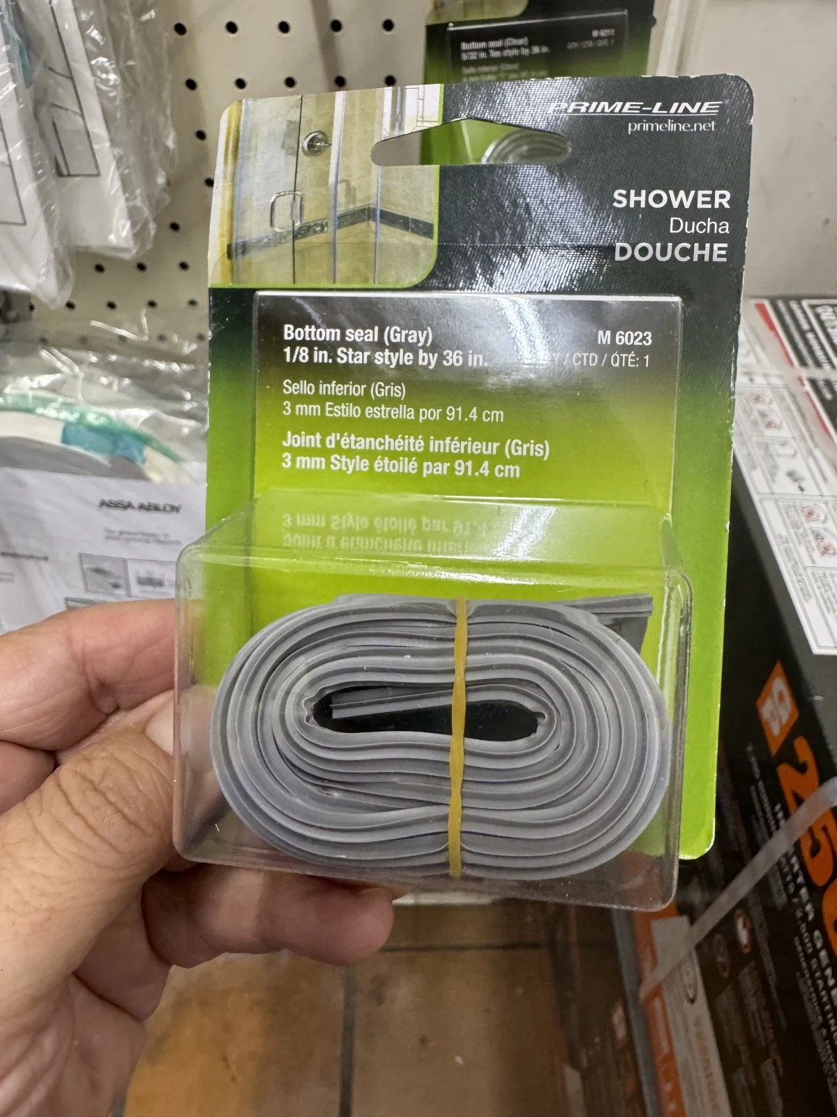

Yes, i did post a solution, i think works....... on Facebook. See photos and video on facebook too large to upload here.
This is not a solution. How can you buy a car for 100k and after 100 miles have seat issue like this ? By putting shower seat at your seats ? For me it’s a solution for Honda accord not for this car

Edit: would a rubber molding like this help to prevent the sharp edge from digging into the leather:
Amazon product
I just dropped the car off at the dealer for scheduled maintenance (mandatory 6 month checkup) and will take a close look when I go pick it up in the evening. I do think the molding will help the scraping if any, but could worsen the creasing...
(btw the "com" is missing from the link) ==> I see it's fixed now.

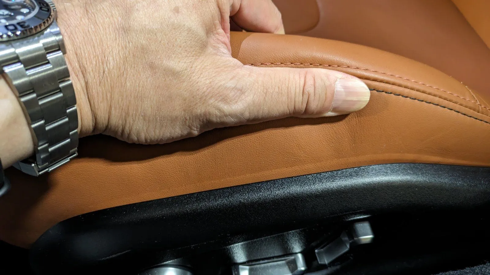

[edit] I picked up my car and checked. Both driver and passenger sides look OK for now, but there is a line where the plastic meets the leather and could develop into deep scratches and creases. The black leather seats in the showroom car looked pretty much the same. Maybe we're better off here in Japan because of the humidity? If so, could be a similar situation in the UK.

Doesnt appear on my driver's seat edge. Although the center of the seat cushion shows some bagginess.
Nappa leather is quite soft & I suppose not as tough as normal leather. 2k miles
