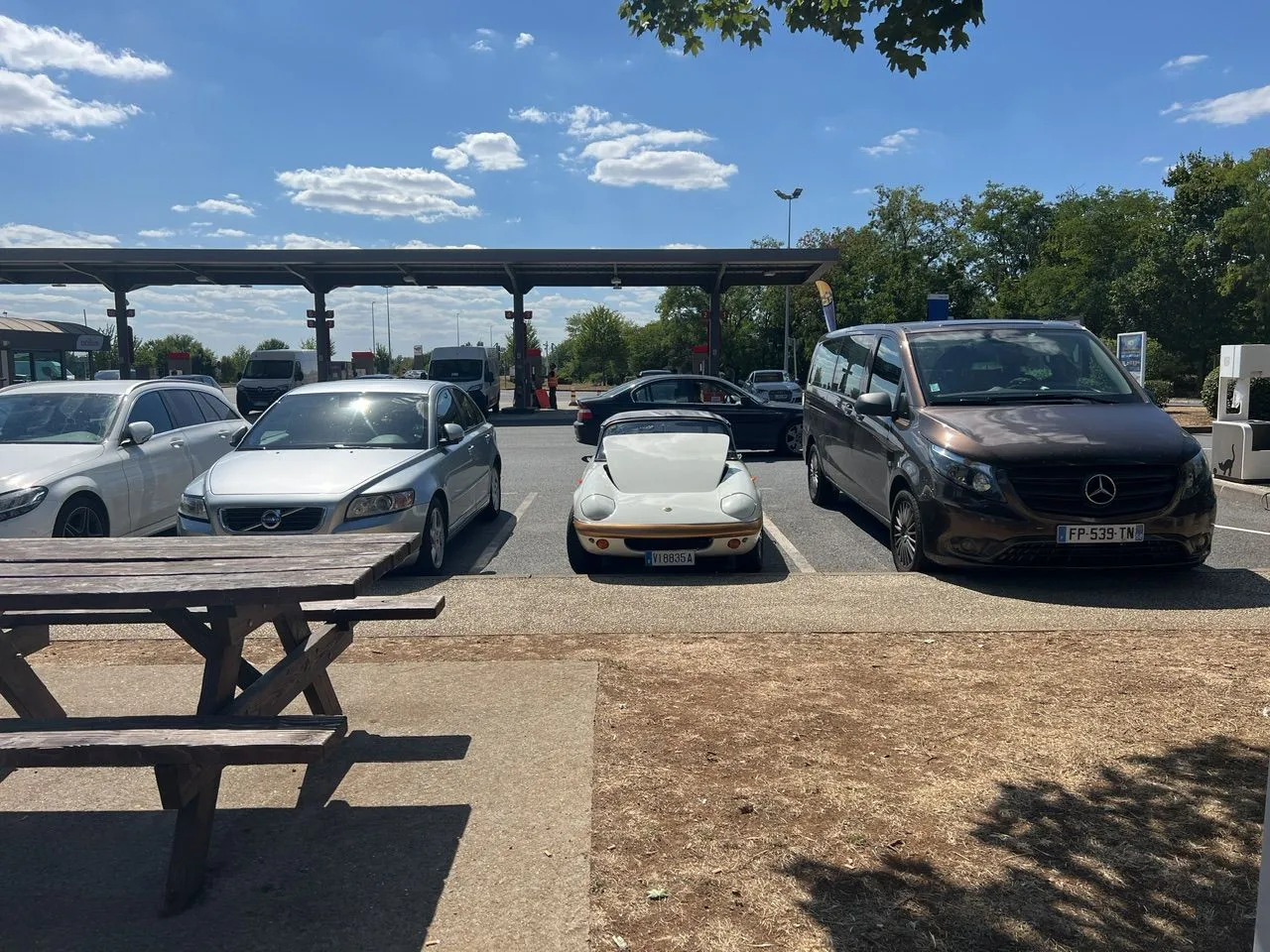

For the size reference conversation - I still have this photo on my phone from when we had to cool the engine in July or August last year on the way back from Spain... I think it shows the size of the Elan really well.

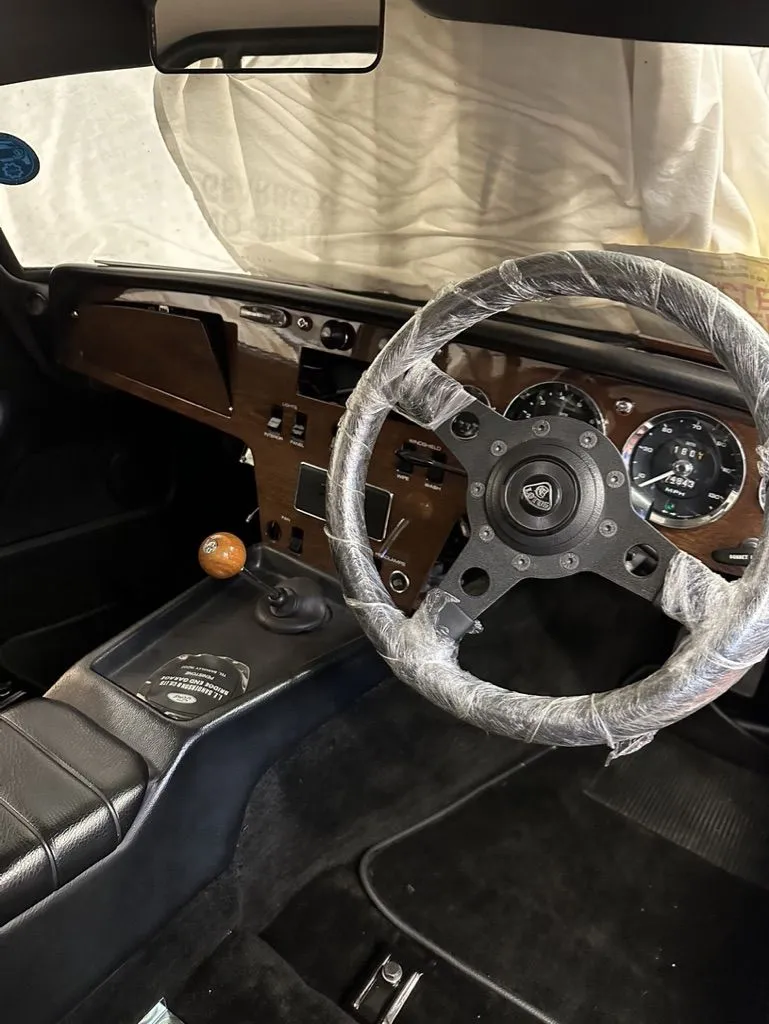

I nipped down to get some interior shots but they are poor.
For info the original 'chapman' steering wheel didnt come with the car and are as rare as hens teeth. Its a period motalita which I have had recovered in Bentley leather (under the cling film).

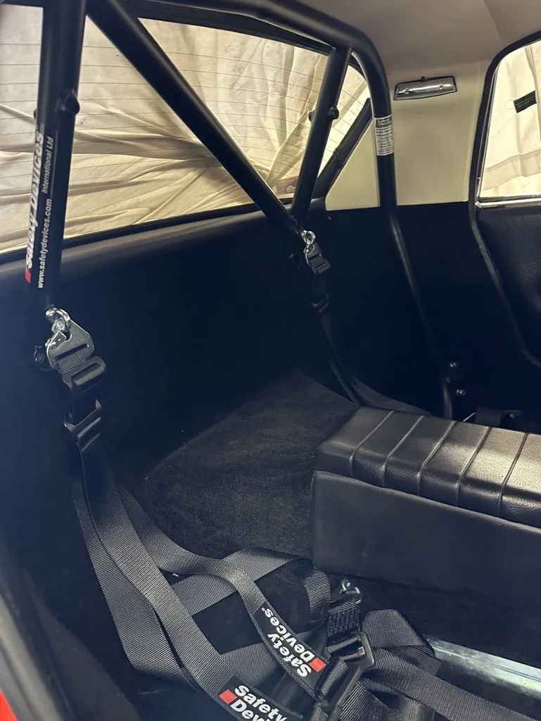

As already mentioned its just a big GRP canoe with an engine so i thought it best to get a roll bar in there and went for the side impact bars which run down the sill and brace across the bottom of the footwell to the chassis.
I had a guy cut out the re bar in the sill and install the bars and weld everything back with a bit of extra steel.
I opted to try a bluetooth amp module thing which sits neatly behind the radio hole. I will fit the blanking plate with magnets in case we need to get in and adjust it. Simply powers up with the ignition and plays via ones phone. Nothing fancy just some sound for longer journeys.
