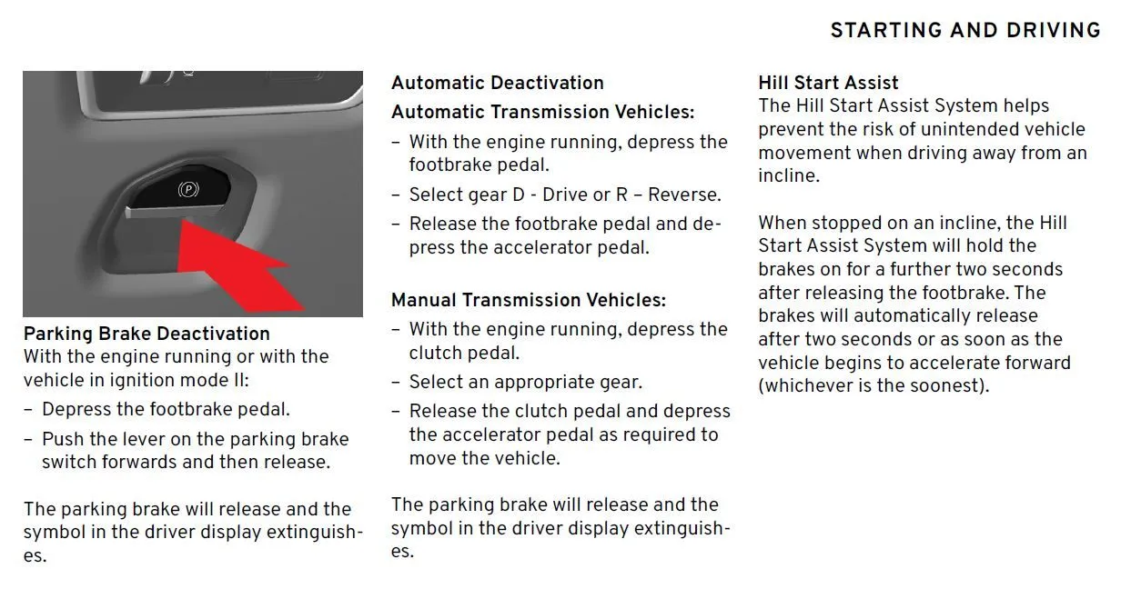

I raised the issue of the parking brake activating automatically (in all driving modes)…Thankfully, according to the Emira manual (p. 100), this feature can be deactivated. Phew!

Nice find! Glad there's an option to disengage it. I assume there would need to be something like that for towing purposes too...
Also worth adding here about being able to deactivate the parking brake manually or automatically, as I think some folks on demos have been told incorrectly that it has to be done manually.

Also important when you are going through automated car washes, amirite?!

Hill Start Assist must be user configurable too. It was not working on the test drive I did earlier today.

By default the 'auto hand brake' is set to off. You have to turn it on in a menu. Track mode turns it off again.
On my demo car, Track mode did NOT disable it.

I didn't see the option anywhere in the car menu. Maybe I'm not right... then tell me where it can be set, please.
All I know is on the test drive yesterday I came to a halt with the car facing up a hill and as soon as I took my foot off the brake it rolled backwards. I did this as a specific test to see if it had hill hold assist. I see above that the manual says it does but when I did what I did, it did not hold it. What does your car do when you stop on a slope?
On my drive it did hold it, so it must be a setting
