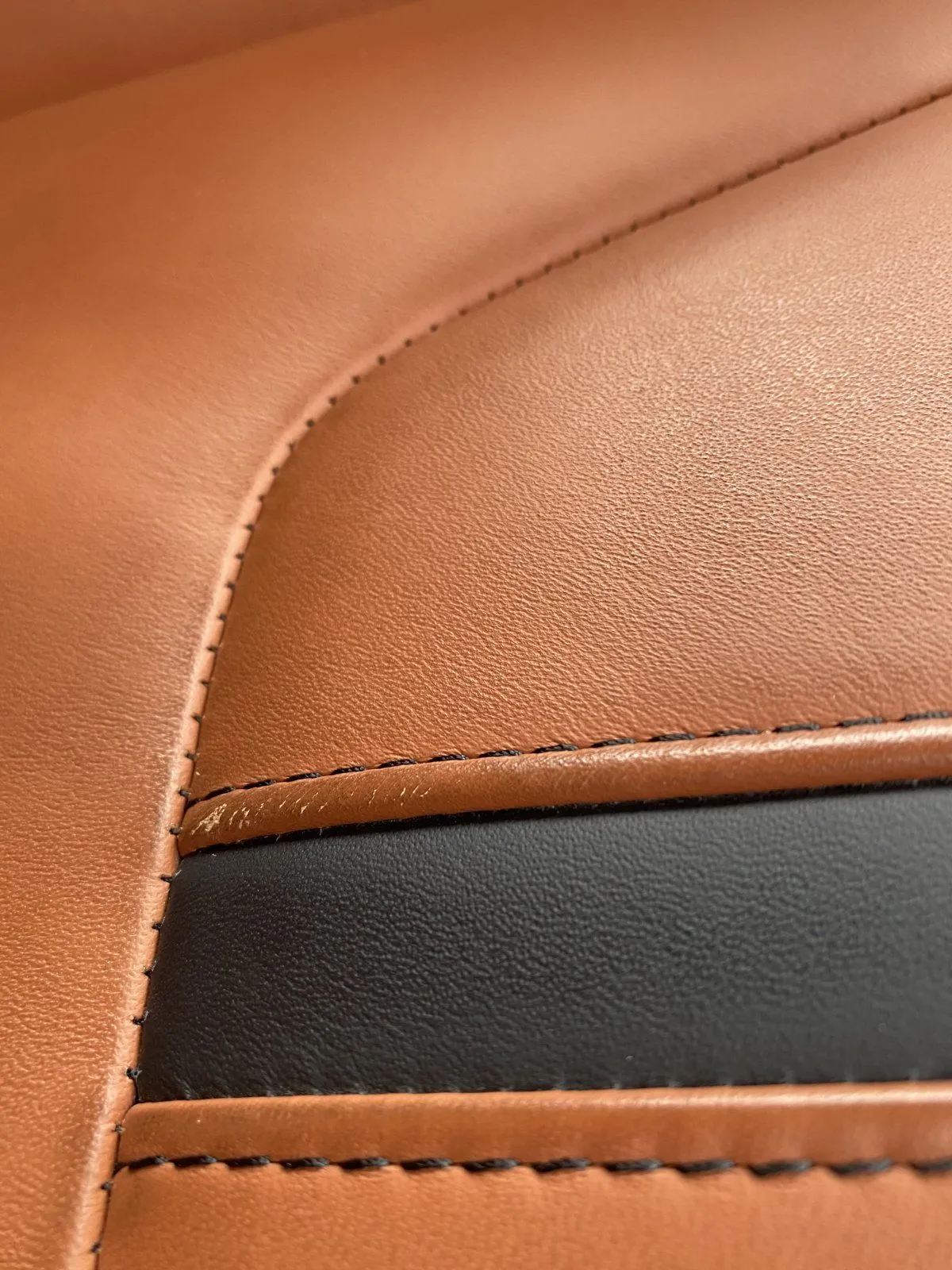

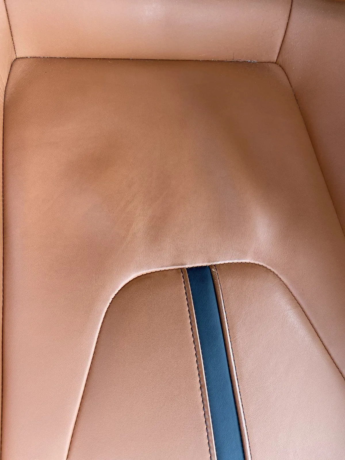

Has anyone else who has owned their car for a few months noticed issues with the leather? I’ve done about 1200 miles, car isn’t used daily.
It’s clear the tan leather is taking onboard some colour from my jeans. None of which are brand new (quite the opposite in fact!).
Of more concern is the piping is showing signs of wear already.
Curious if this is happening to others with leather seating?

What kind of leather care are you using? The leather looks like it's very dry.
None. Maybe I should be but it seems excessive to think the leather would need treatment so soon, when it it used sparingly. I’d expect this and any other trim to have been tested using automated systems (like they do with beds) to ensure appropriate longevity.
I would expect periodic maintenance of the leather but not every 3-4 months. I’ve not had to do that with other leather seats in the past, albeit not with Nappa Leather.
I’d be interested to know if it’s anyone else or if it’s just my car, like many of my issues appear to be!
That leather piping wear does not look normal unless you are wearing very abrasive clothing. I would get the dealer to check it out.

Unfortunately that’s looks like it’s going to be a wear issue because it’s slightly raised. Wearing jeans especially if they have raised studs on the pocket edges will increase the risk of scrapping them. I learned this that hard way one time on pristine white leather seats. I’ve got tan leather in mine and so far it’s ok but I can see it slightly wearing/darkening on the edge.

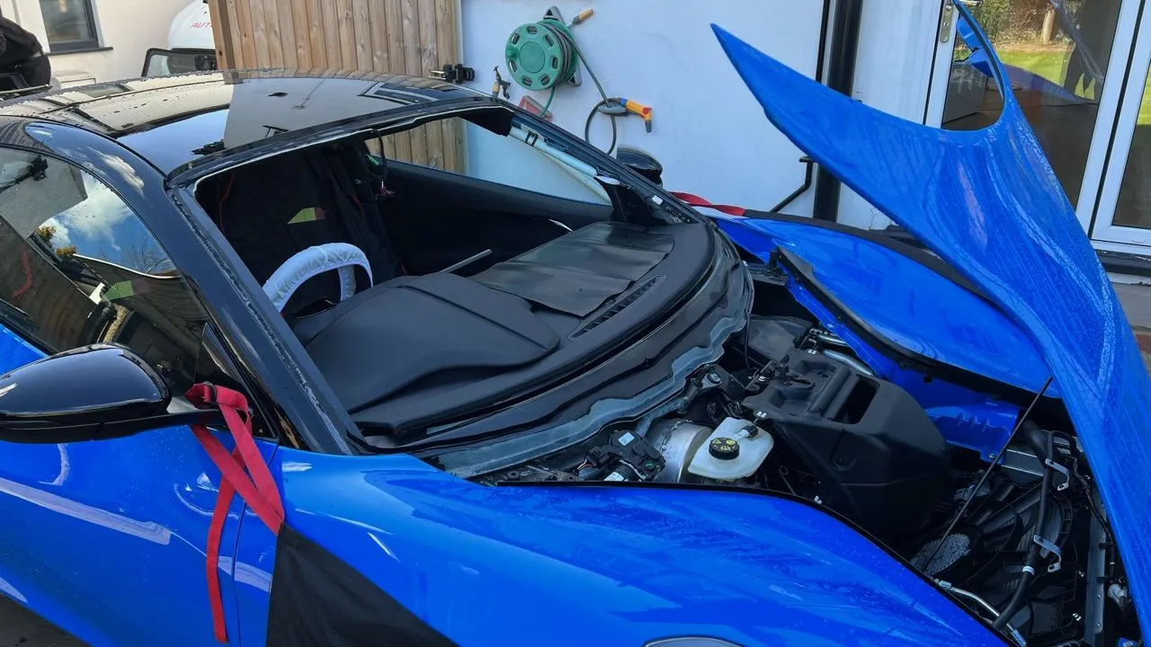

With regards to the wipers. Latest update from the dealer is that they are waiting for new wiper motors to come in and yes there are delays. The software needs to be done together with the new motor apparently.
I wonder how much has to be dismantled to get the motor out. 😟
Well, I open the front bonnet yesterday and had to reach over (because I’m short) was concerned about scratching the panels. Things are never the same when all the panels and parts are dismantled.
