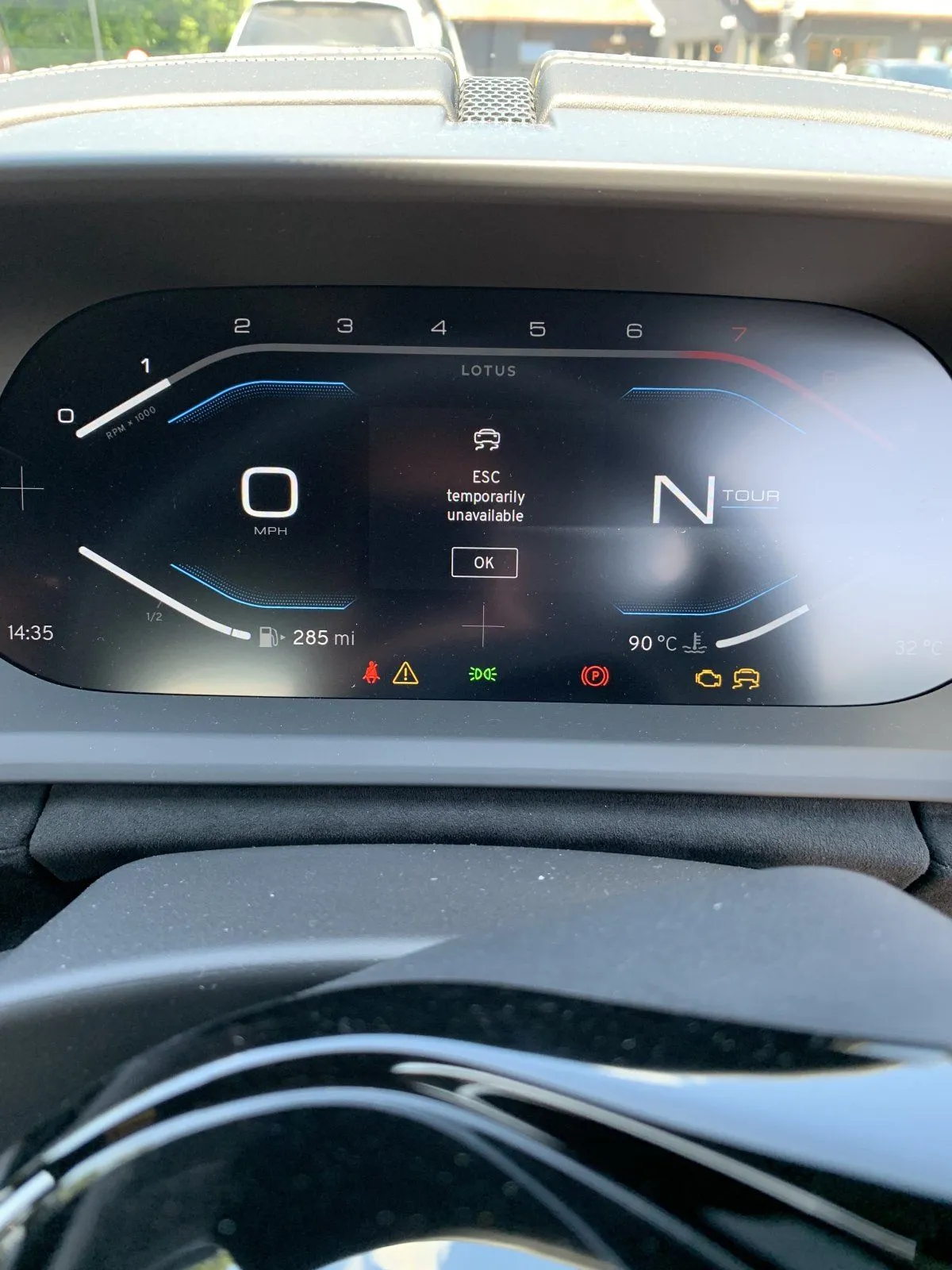

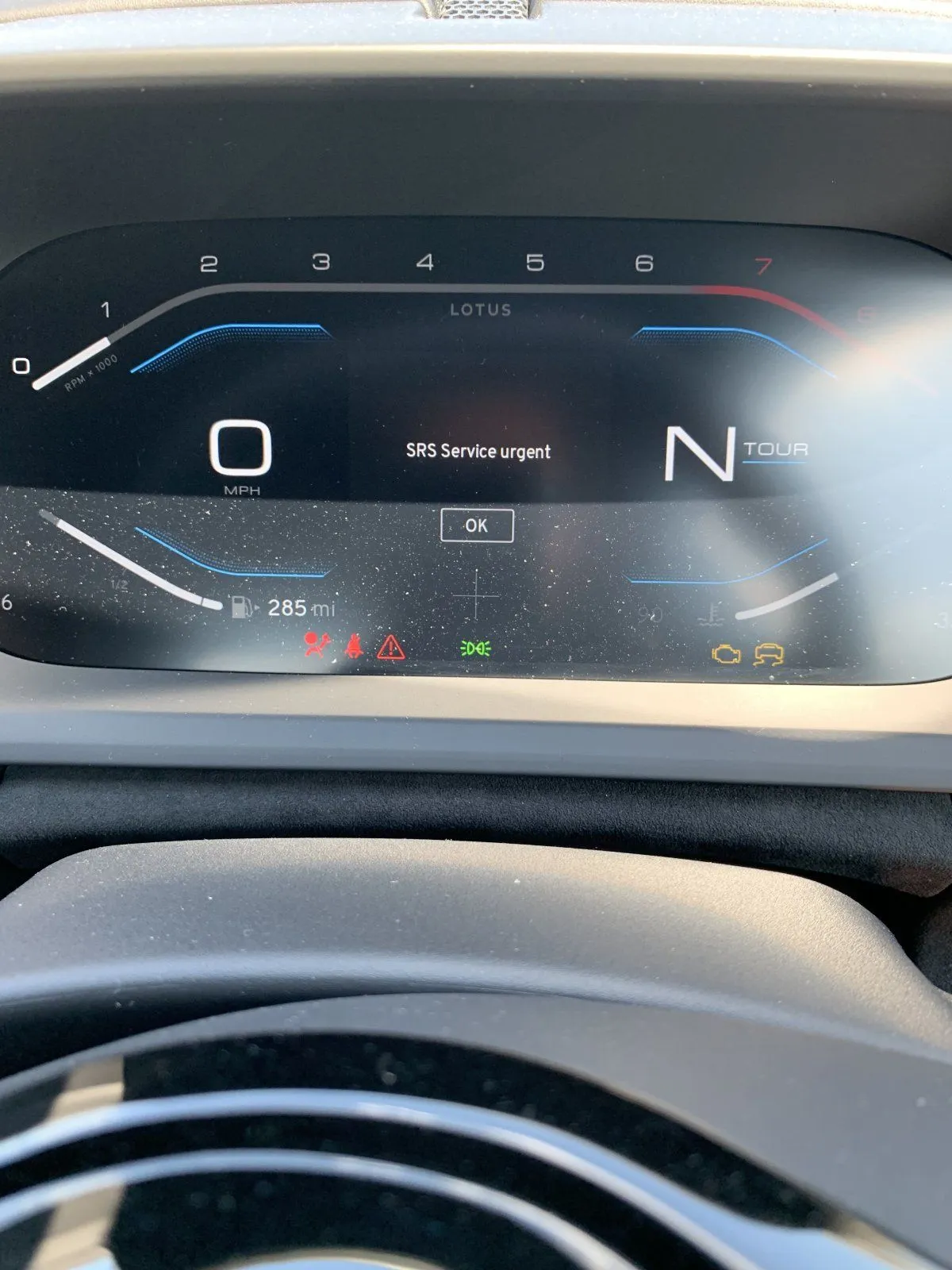

Currently stuck at Membury services on my 3rd drive. Power loss on M4, pulled over to hard shoulder - engine off and on again and power back, engine warning light stayed on.
20 mins at the services, restart engine and the dash lights up like a Christmas tree. ‘ESC temporarily unavailable’ ‘SRS Service urgent’ engine light still on and temp flashing at 90c.
Waiting for roadside assist but added to previous issues that I haven’t reported here yet, I’m not loving life as a Lotus owner right now..

Ugh.. Good luck and keep us posted!
So, AA found a number of fault codes, the most worrying related to throttle valve. He cleared them, started engine and they immediately reappeared. He suggested driving the car home as he wasn’t able to tow and the vehicle was drivable.
5 mins on motorway and engine in limp mode again. 40mph all the way to next services, vehicle now stuck in limp mode and revs are all over the place when idling, definitely a throttle valve issue.
