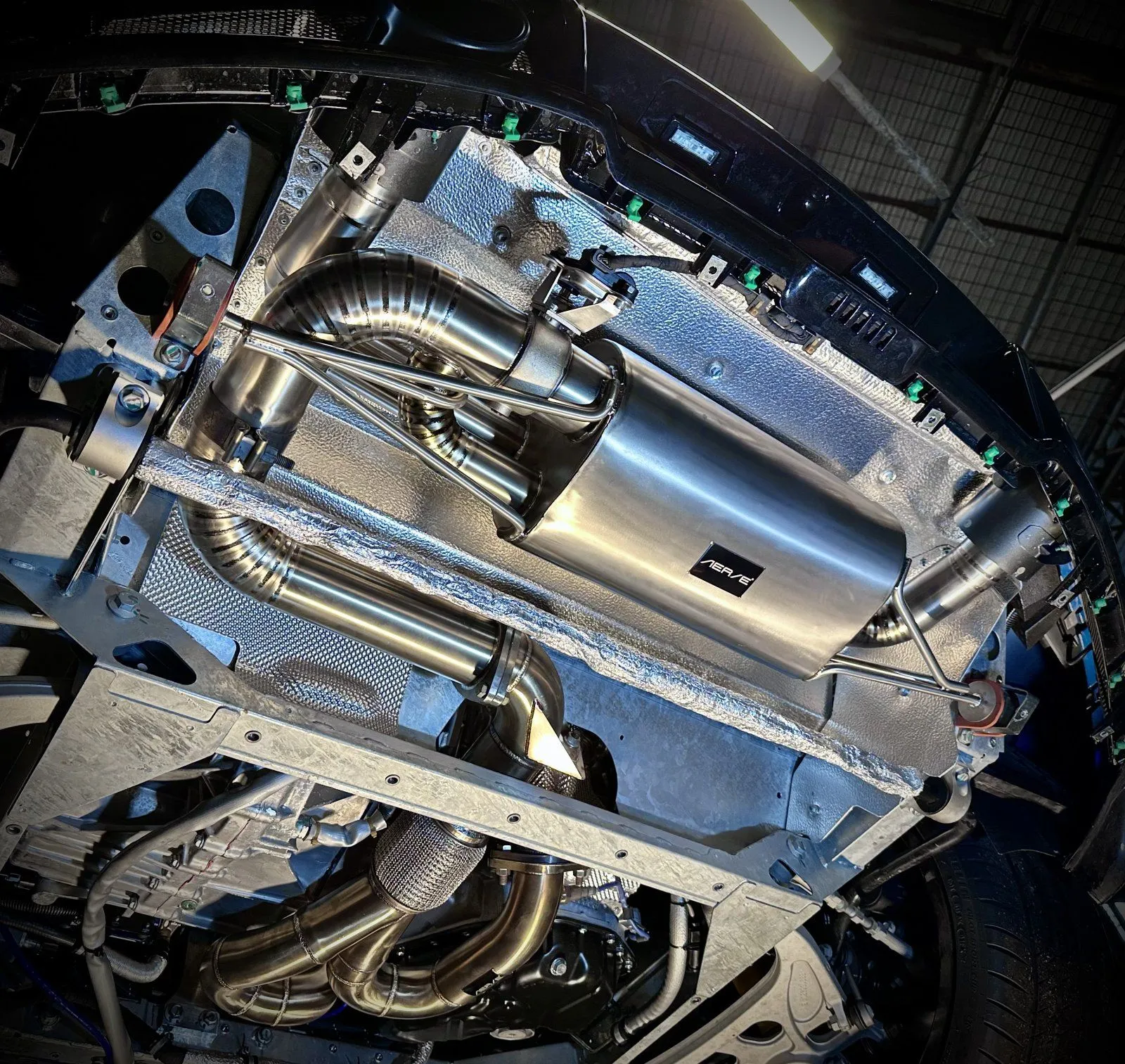

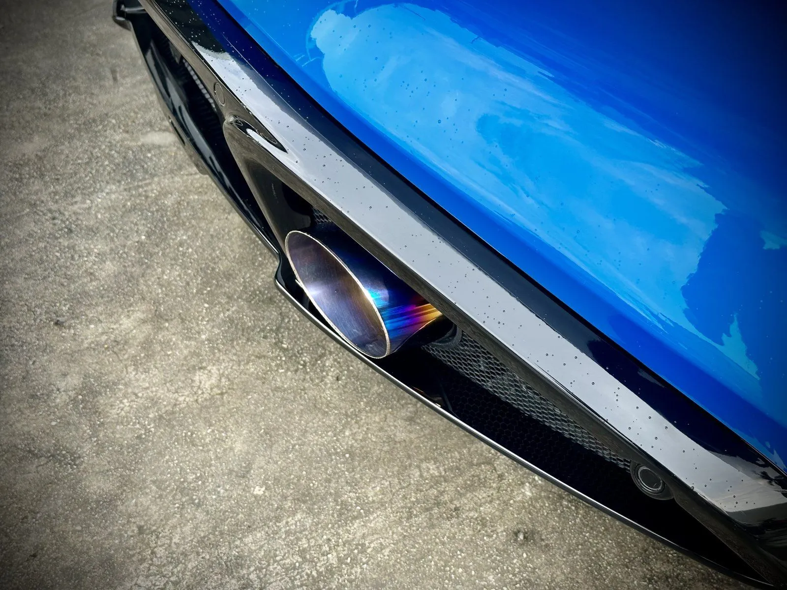

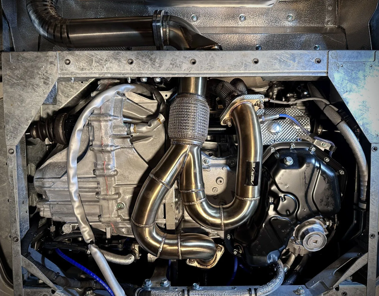

We have a full titanium exhaust system for Emira 2.0 , here is some pictures for you reference .

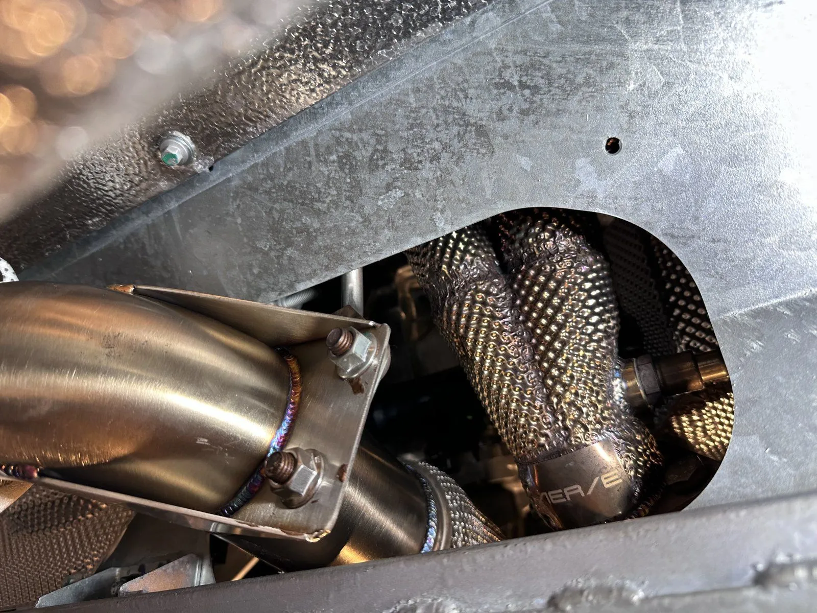

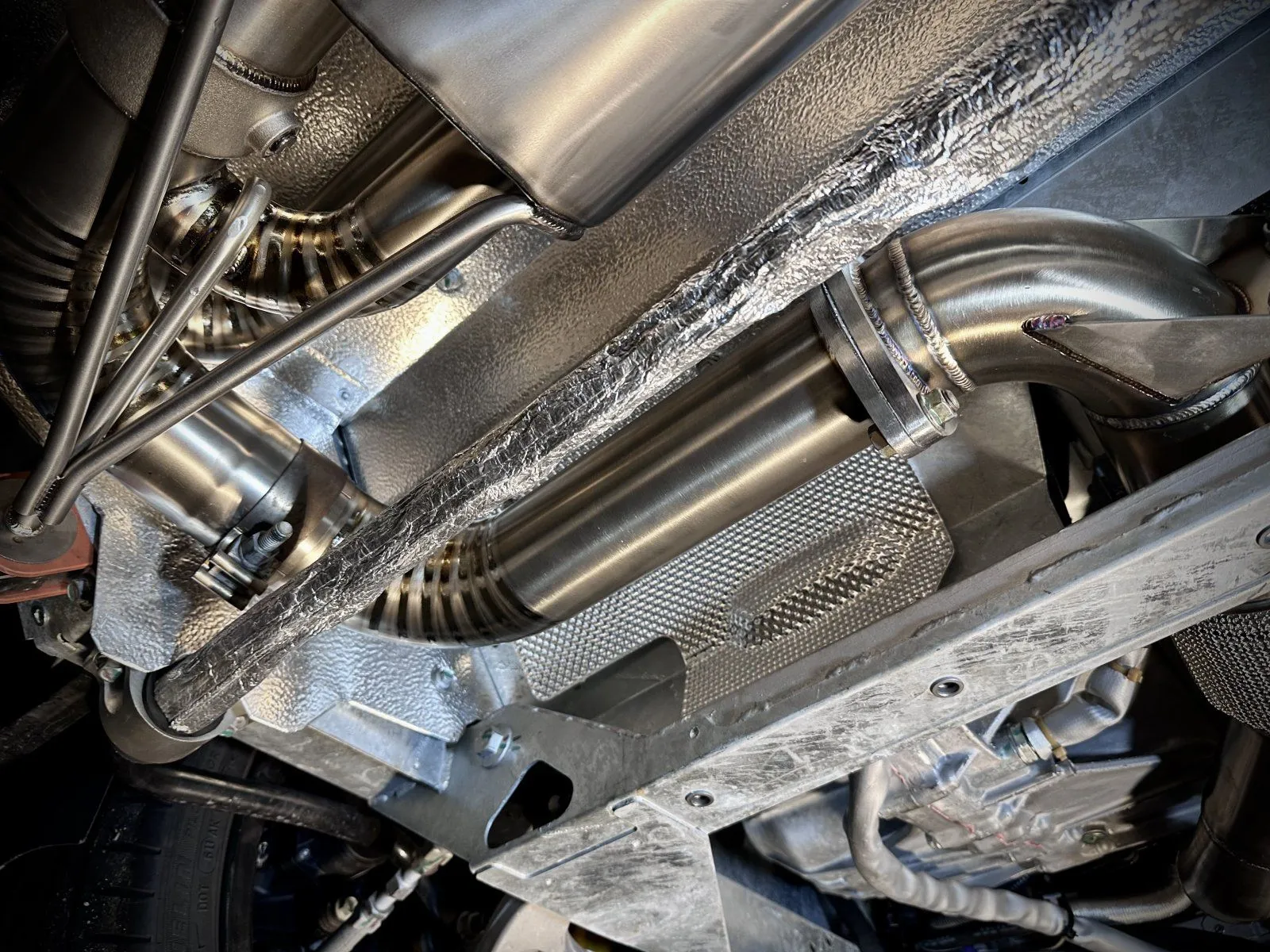

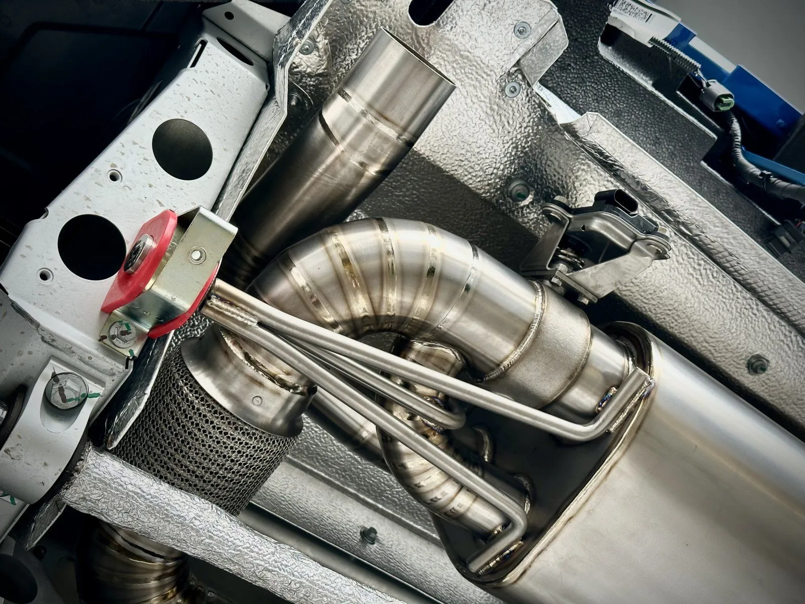

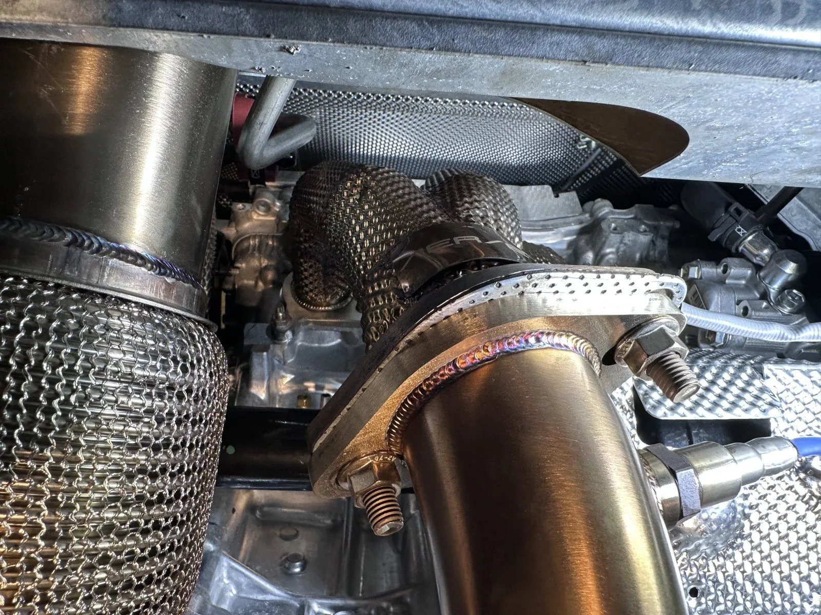

This is the picture of the Emira V6 full titanium exhaust system, y-pips and the premium heat insulation headers
If you don't mind me asking, why all the pie cuts (necessitating dozens of extra welds) on the backbox/muffler piping? Looking at the headers you've built, which do look very nice, you do seem to have proper pre-bent sections. Were the pie cuts just for the prototype muffler, or do you intend the final product to be built that way also?
