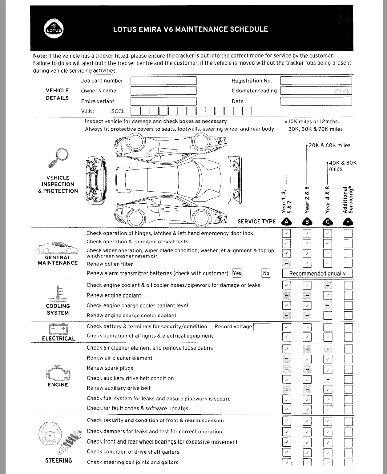

Took my car to the dealer yesterday for recalls (water shield and EVAP canister check). While there I asked if they had the maintenance schedule for the Emira. Id only seen them for the Evora so far. Been wanting this as a guide since I do all my own maintenance.
Also included a matrix that shows the intervals and the reference cost they charge for each service. Your dealer may charge a different number of hours.
Feel free to add official/good threads that reference some of these maintenance items.
Example:

Dear god, the price difference on the 4yr service. US $2600(~£2030), UK £1280. I thought things were cheaper in the US :)

They did tell me those USD$ amounts were just a guide or something. Hopefully so as they seem excessive to me.
$180 for just an oil filter and the oil! For some reason the exact same service (labor cost) at 1 year is more than the 1000 mile one too.
Interested to see that there is a manual transmission oil filter. Never heard of that on a manual. I assume its the same as the Evora 400GT.

FWIW, I heard back from my Canadian dealer today and was told, the "first service" following the exact same checklist that Aero posted at the start of this thread (the first 2 pages; thanks Aero!) would cost Can$536.91 (plus tax), broken down at my request (since I asked about me supplying the appropriate oil/filter), as $321 labour and $215.91 parts. I assume most of the $215.91 is to cover the oil/filter, since there's usually always a small add-on for "shop supplies" or the like. I was expecting more for labour, from a dealership that typically services Lambos, Rolls Royce, Bentley and Aston Martin vehicles. They also said they'd do the "track inspection" n/c for me (included with the first service), since many tracks require a signed inspection form, from a qualified shop.
That said, I do my own oil/filter changes (and think I do better than most dealerships, given how long I let the oil drain) and can and do look at the rest, so I'll be filling out this "first inspection" myself. It helps when my dealer is a 3-hour-one-way drive away. I may be inviting an interesting warranty fight, if it comes down to that, but I expect an oil analysis would back me up, plus my many years of being a "back-yard mechanic" to prove my experience servicing my own vehicles, were this ever worthwhile money-wise to go to court. No doubt others won't want to take that risk so that's just me.

In prepping for my (hopeful) Emira, I created a maintenance schedule in Google Sheets, based off the above PDF that @Aero posted. It's a first draft, but let me know what you guys think and if my checkboxes for the maintenance are off, or mistakes/missing items.
The tire and brake sections will autofill 'mm' after you type a number in them for column c. The link below will attempt to make a copy of the sheet. There is also some javascript on the backend to autofill the 'mm' in certain cells:
Link
EDIT: I'm going to add an automation centered around the mileage (at the very bottom of the sheet) so that it highlights any overdue or upcoming service. I'll also add a secondary sheet where you can scan and attach/link service record receipts stored in your Google Drive...organized, somehow(?)...haven't gotten that far yet lol.
EDIT2: I'm nearly finished, I just need to complete the conditional formatting on all the columns. Doing it via the Format Painter keeps messing things up so I have to do it one column at a time. I'll report back when it's ready to try out.
EDIT3: It's ready to go with the link just above. I'll try and make a quick tutorial on how to use it in the near future. HTH!

This is awesome, thank you.
I was planning on doing the 10,000 mile service myself (it's due now), but I called my dealer out of curiosity. They want $1,000 to do it, so my decision to do it myself was reinforced. This will be really helpful.
Isn’t the 10k service just visually inspecting a bunch of different areas? What else is there?
Pretty much, plus some fluid changes since I've tracked it. Not sure how they are justifying the cost.
Which fluids? I haven’t seen maintenance schedule outside of this screenshot I found on the forum
